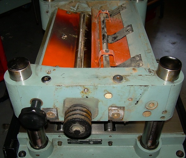

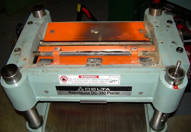

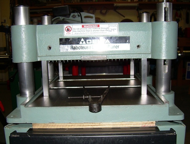

Not sure if this is the right forum to put this but here goes. I picked up a 15" Delta planer cheap at auction last December. I new the outfeed roll had some deep grooves worn into it and the adjusting hand wheel had a lot of sloppy play in it so last January I decided to dis-mantel it and see what other problems I could find before using it.
As received after a clean up.
Attachment 17152
Attachment 17153

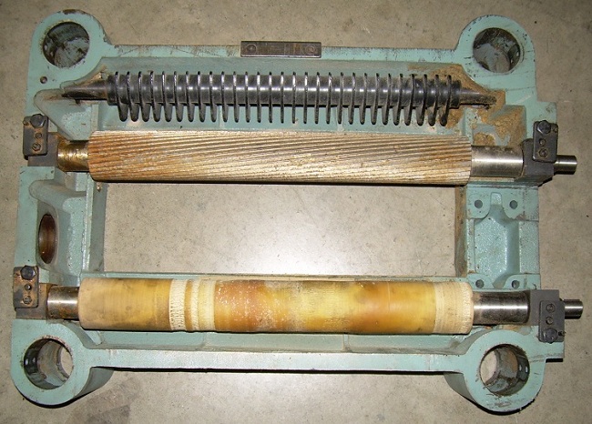

The inside indicated a lot of hard use.
Attachment 17154
Attachment 17155
Attachment 17156
Attachment 17157

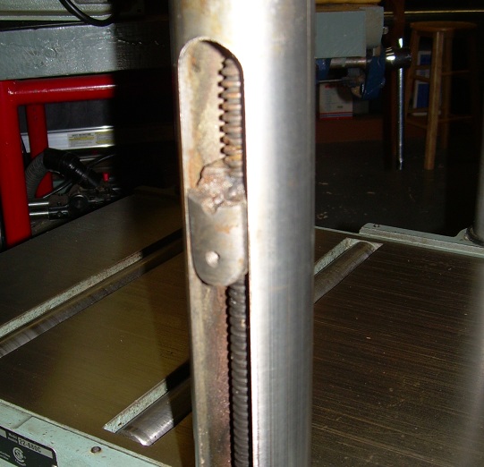

One thickness adjusting nut was broken.
Attachment 17158

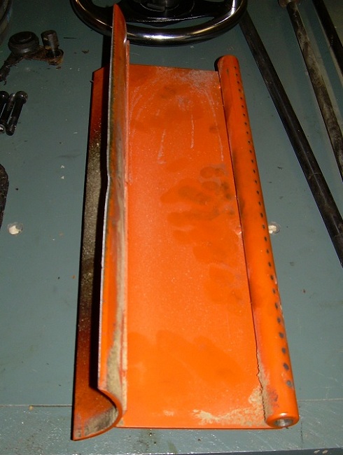

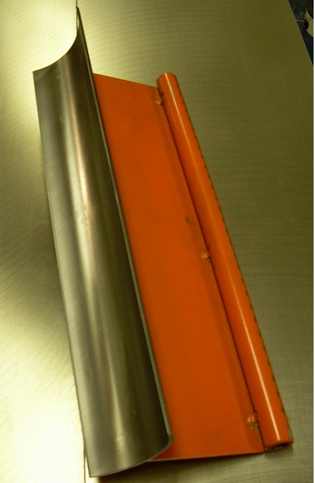

And here is an indication of what caused all the problems, a good dent in the chip breaker, indicating that a piece of wood with steel in it had been fed into the planer. The second pic is the chipbreaker after straightening and cleaning.
Attachment 17159
Attachment 17160

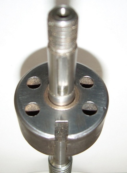

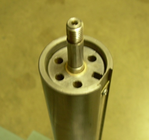

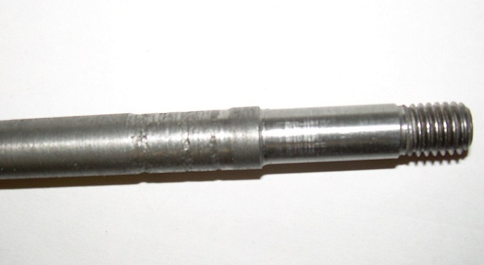

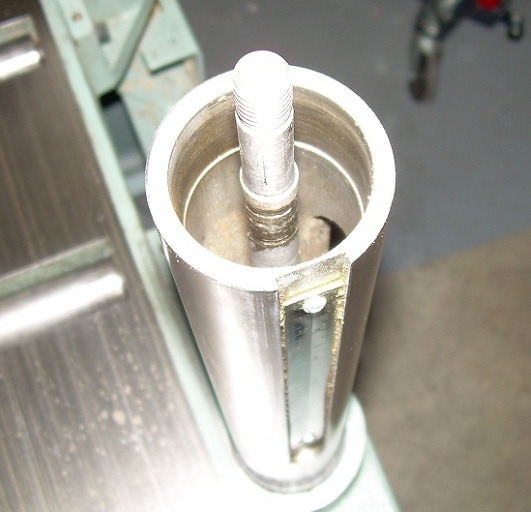

The reason the adjustment wheel was so sloppy was the adjustment shaft was worn where it was supported by the top bushing and the bushing had some were as well, after my parts order arrived I bored the bushing to accept a bronze bush and bored the bronze bush to accept the new shaft. My reasoning being the bronze bush will not wear the expensive adjusting shaft (screw) and the bronze bush will be easy to replace in the future.
Attachment 17161
Attachment 17162
Attachment 17163
Attachment 17164

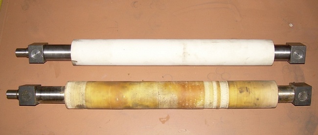

The next pic. is the new outfeed roll with new bushings and the old one.
Attachment 17165

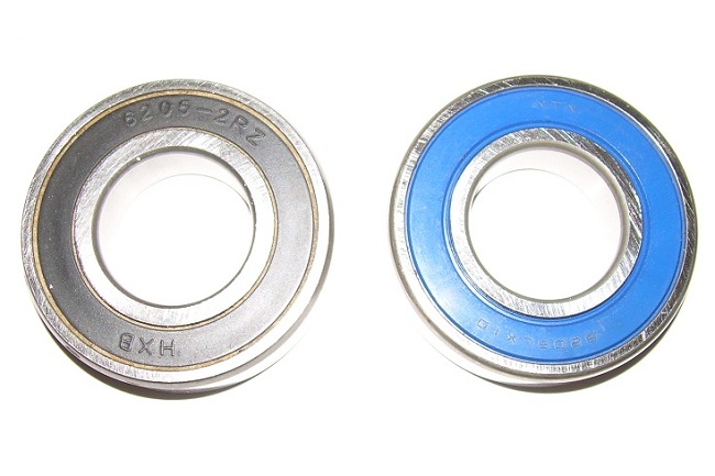

The outboard cutter head bearing was running dry (on the left) so I replaced it with a snowmachine bearing, double lip seals and rated for 10,000 RPM.
Attachment 17166

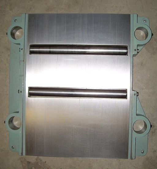

Continuing with the planer rebuild, I now know were the problems are I put a parts order in and started cleaning up the castings and reassembling. Here is the base casting after a good going over with WD-40 and emery cloth, the bed rolls have been reinstalled and adjusted to specs.
Attachment 17167

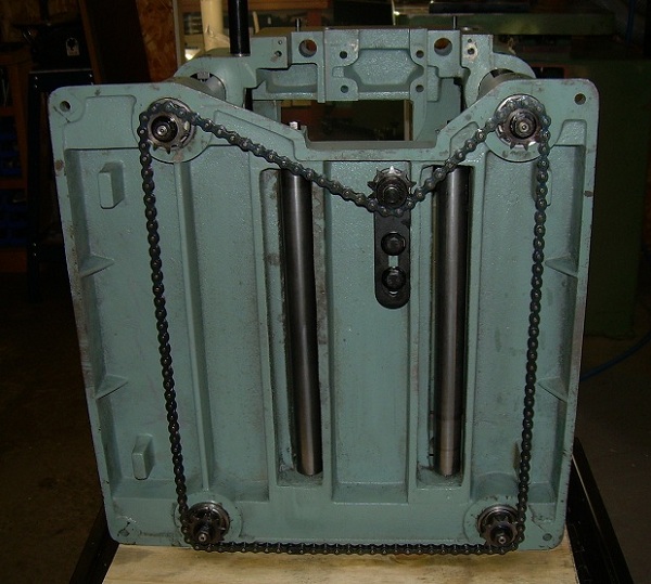

After the columns and screws are reinstalled the head is installed on the columns. Here supported on shop made gauge blocks so the screw adjustment nuts could be bolted to the head. The head is then locked in place and the planer flipped to install the cleaned and lubricated adjustment chain.
Attachment 17168

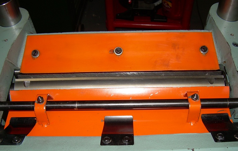

Here the chip breaker, cutter head and dust deflector are installed.
Attachment 17170

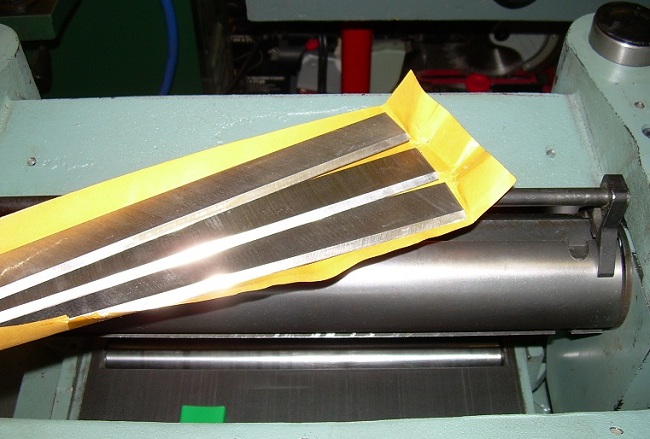

A new set of knives are installed.
Attachment 17171

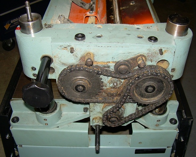

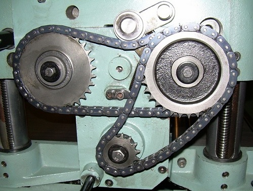

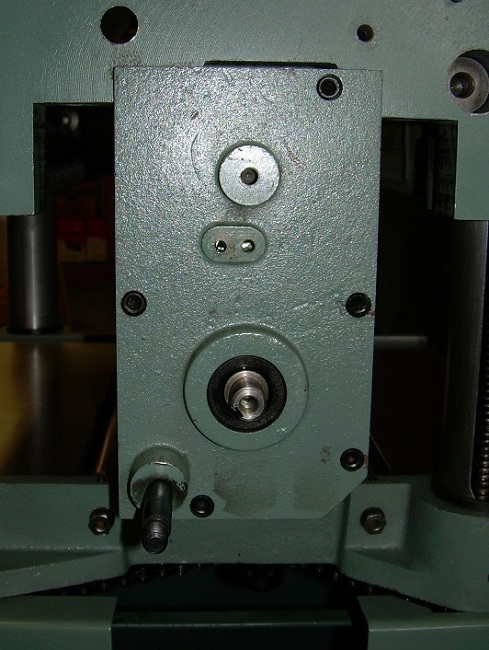

I then drained and flushed the gear box, refilled with extreme pressure gear oil. Checked gear backlash, very little indicating little wear. Cleaned and lubricated drive chains and reinstalled.
Attachment 17172
Attachment 17173

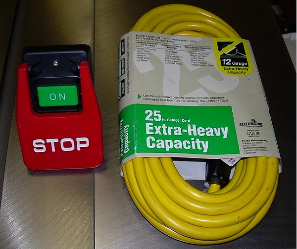

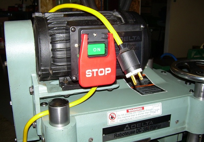

A new 230 V start switch and extra heavy #12 cord.
Attachment 17175
Attachment 17176

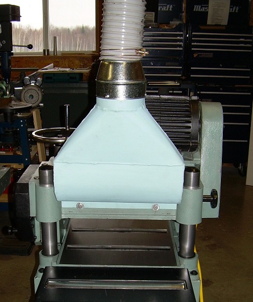

A newly painted dust exhaust hood with 5-4" reducer connected to dust collector.
Attachment 17177

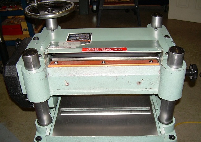

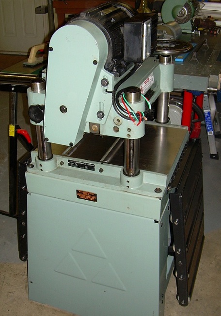

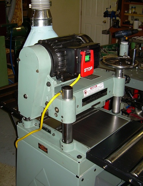

And here is the finished planer.
Attachment 17178

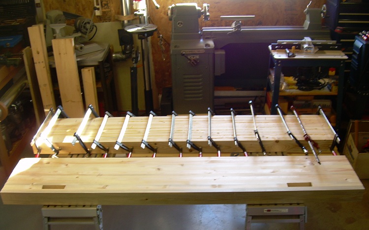

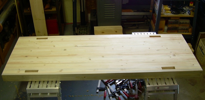

Performance: My current project is a large woodworking/patternmaking workbench. I built the top in 2 pieces each 3 1/4 X 14 X 78". Each half weighed almost 100 lbs. The planer fed those huge slabs smoothly and left a nice finish. The second pic is the 2 halfs joined to make the bench top a full 28" wide.
Attachment 17179
Attachment 17180
