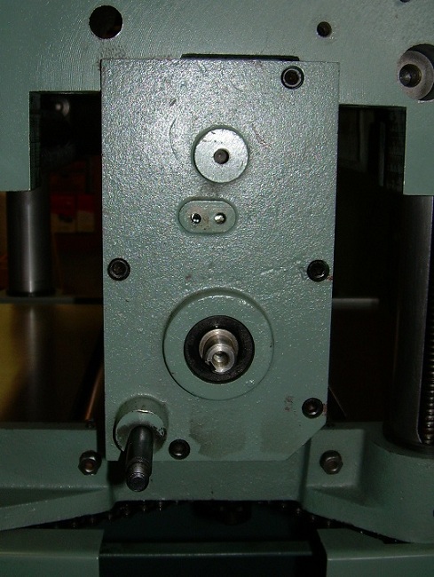

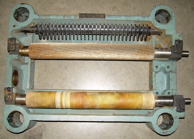

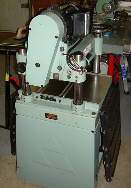

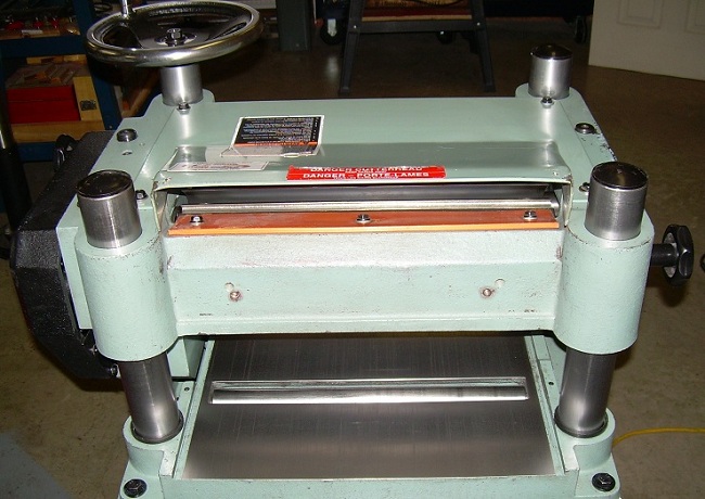

    Not sure if this is the right forum to put this but here goes. I picked up a 15" Delta planer cheap at auction last December. I new the outfeed roll had some deep grooves worn into it and the adjusting hand wheel had a lot of sloppy play in it so last January I decided to dis-mantel it and see what other problems I could find before using it.
    As received after a clean up.

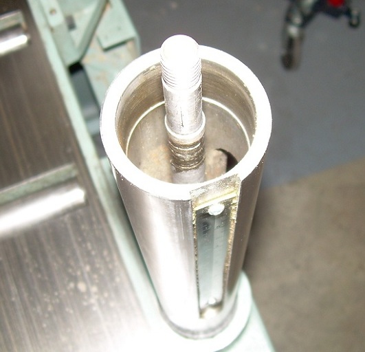

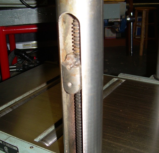

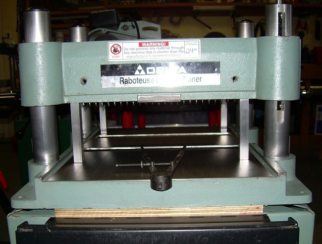

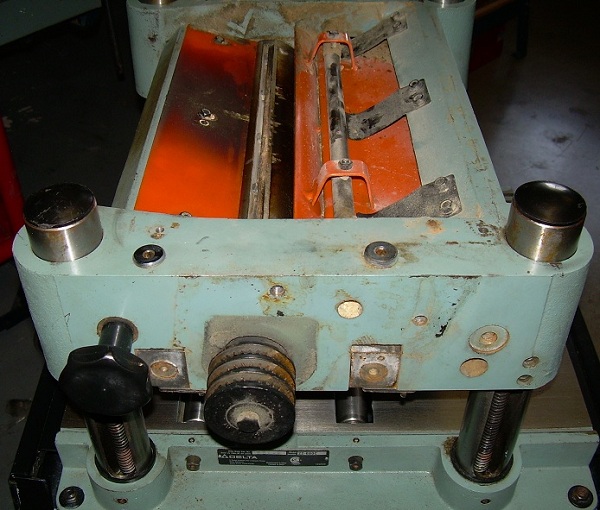

    The inside indicated a lot of hard use.
    One thickness adjusting nut was broken.

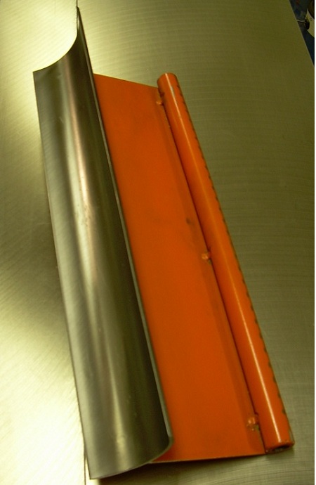

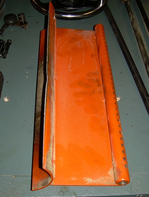

    And here is an indication of what caused all the problems, a good dent in the chip breaker, indicating that a piece of wood with steel in it had been fed into the planer. The second pic is the chipbreaker after straightening and cleaning.

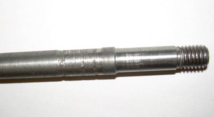

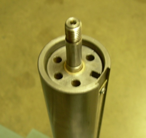

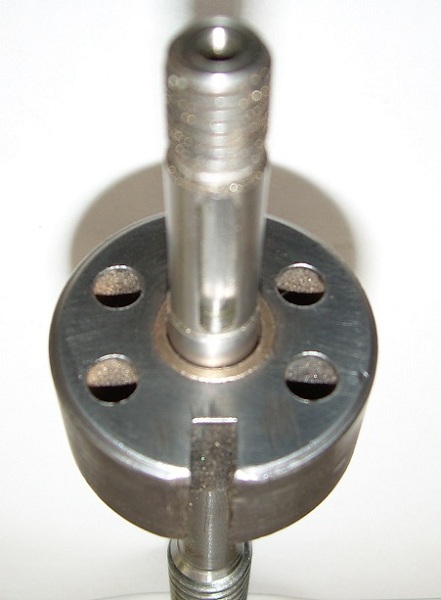

    The reason the adjustment wheel was so sloppy was the adjustment shaft was worn where it was supported by the top bushing and the bushing had some were as well, after my parts order arrived I bored the bushing to accept a bronze bush and bored the bronze bush to accept the new shaft. My reasoning being the bronze bush will not wear the expensive adjusting shaft (screw) and the bronze bush will be easy to replace in the future.

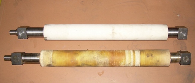

    The next pic. is the new outfeed roll with new bushings and the old one.

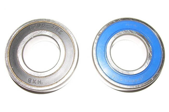

    The outboard cutter head bearing was running dry (on the left) so I replaced it with a snowmachine bearing, double lip seals and rated for 10,000 RPM.

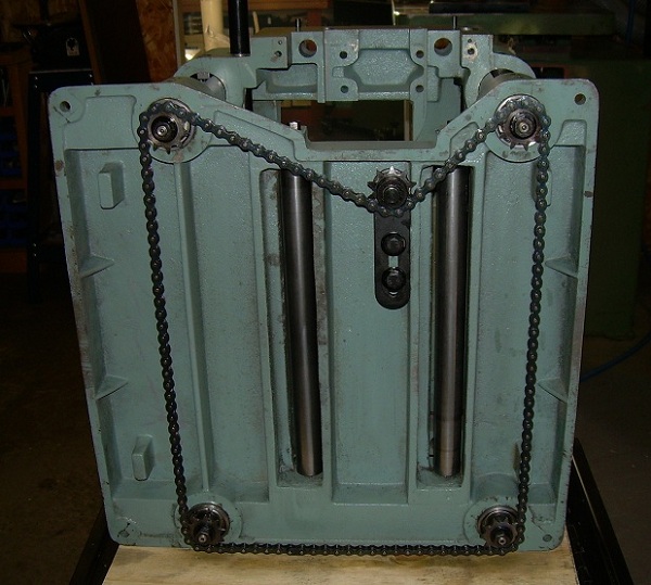

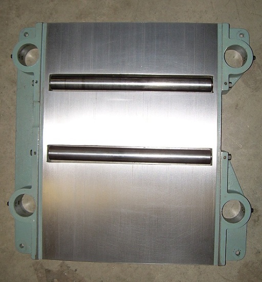

    Continuing with the planer rebuild, I now know were the problems are I put a parts order in and started cleaning up the castings and reassembling. Here is the base casting after a good going over with WD-40 and emery cloth, the bed rolls have been reinstalled and adjusted to specs.

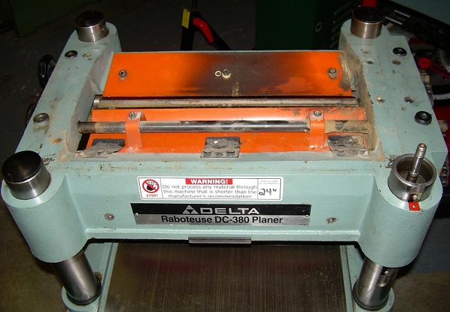

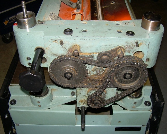

    After the columns and screws are reinstalled the head is installed on the columns. Here supported on shop made gauge blocks so the screw adjustment nuts could be bolted to the head. The head is then locked in place and the planer flipped to install the cleaned and lubricated adjustment chain.

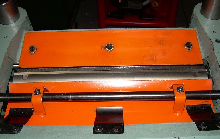

    Here the chip breaker, cutter head and dust deflector are installed.

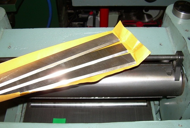

    A new set of knives are installed.

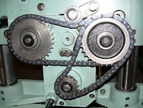

    I then drained and flushed the gear box, refilled with extreme pressure gear oil. Checked gear backlash, very little indicating little wear. Cleaned and lubricated drive chains and reinstalled.

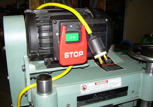

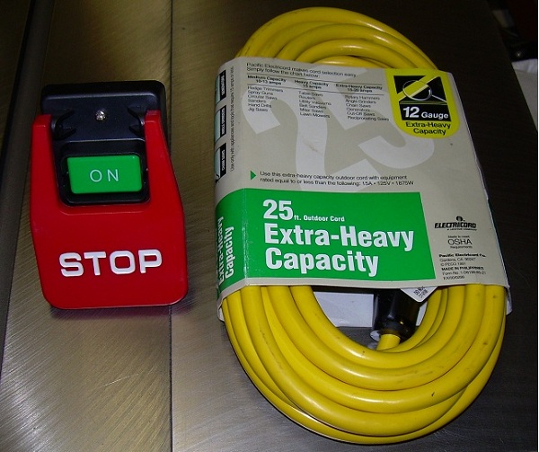

    A new 230 V start switch and extra heavy #12 cord.

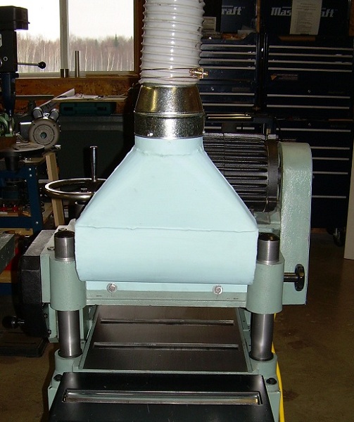

    A newly painted dust exhaust hood with 5-4" reducer connected to dust collector.

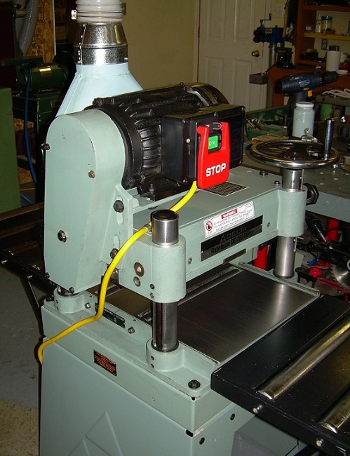

    And here is the finished planer.

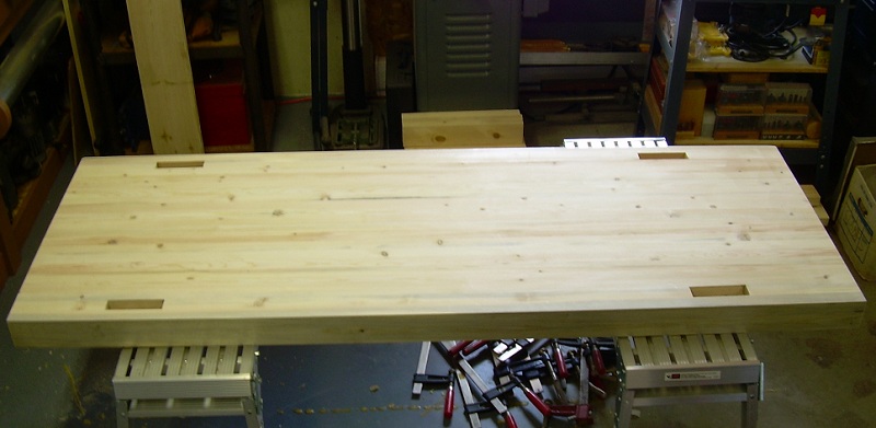

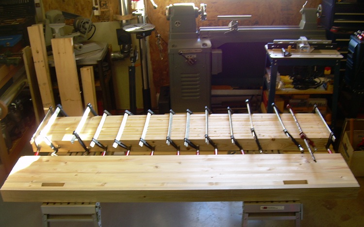

    Performance: My current project is a large woodworking/patternmaking workbench. I built the top in 2 pieces each 3 1/4 X 14 X 78". Each half weighed almost 100 lbs. The planer fed those huge slabs smoothly and left a nice finish. The second pic is the 2 halfs joined to make the bench top a full 28" wide.
    I'll upload the bench build when I am done.
