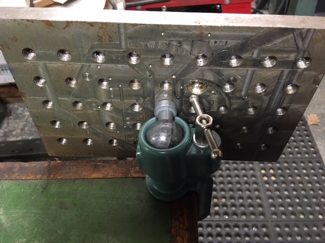

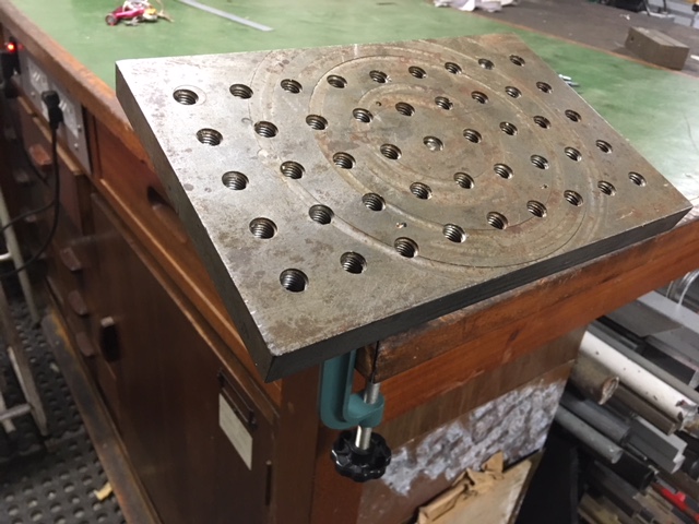

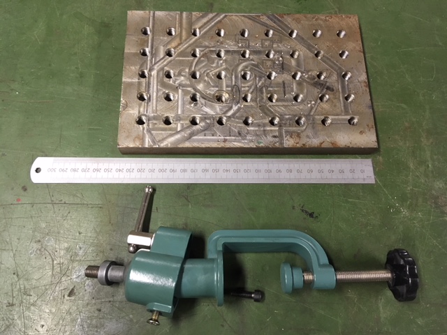

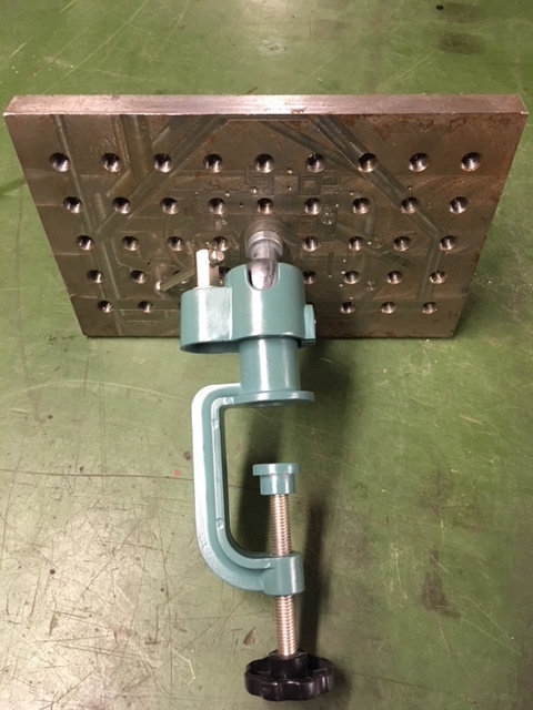

    Got really lucky today and found these two items in a scrap bin. So, in I go skip diving to recycle the two items. The first item that caught my eye was the shinny painted swivel bracket that had a broken vice attached to it, the second item was a drilled and tapped M10 jig plate.
    Home they both came and the vice was removed and the hole in the swivel joint drilled out to M10 a bit of studding screwed in and loctite and the final part of this creation, screw the jig plate to swivel joint stud and a universal welding table was born with very little effort.
