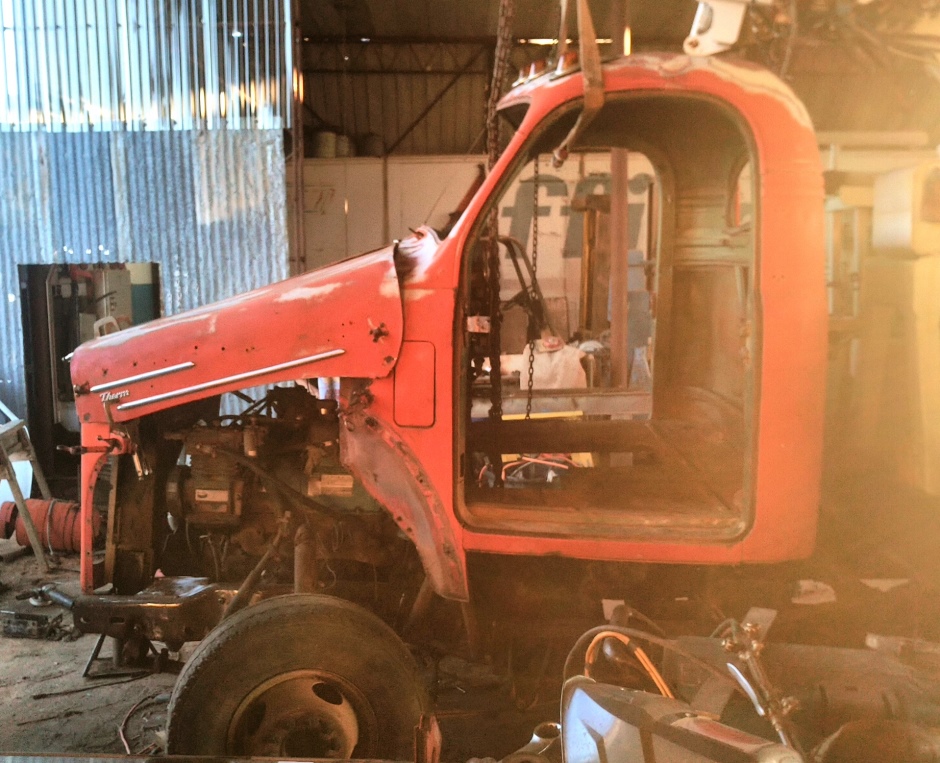

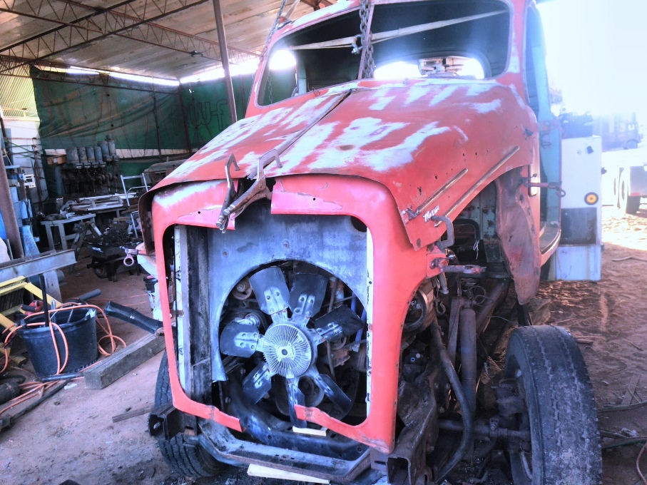

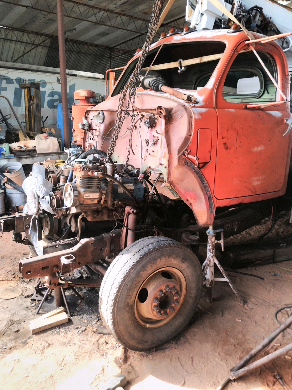

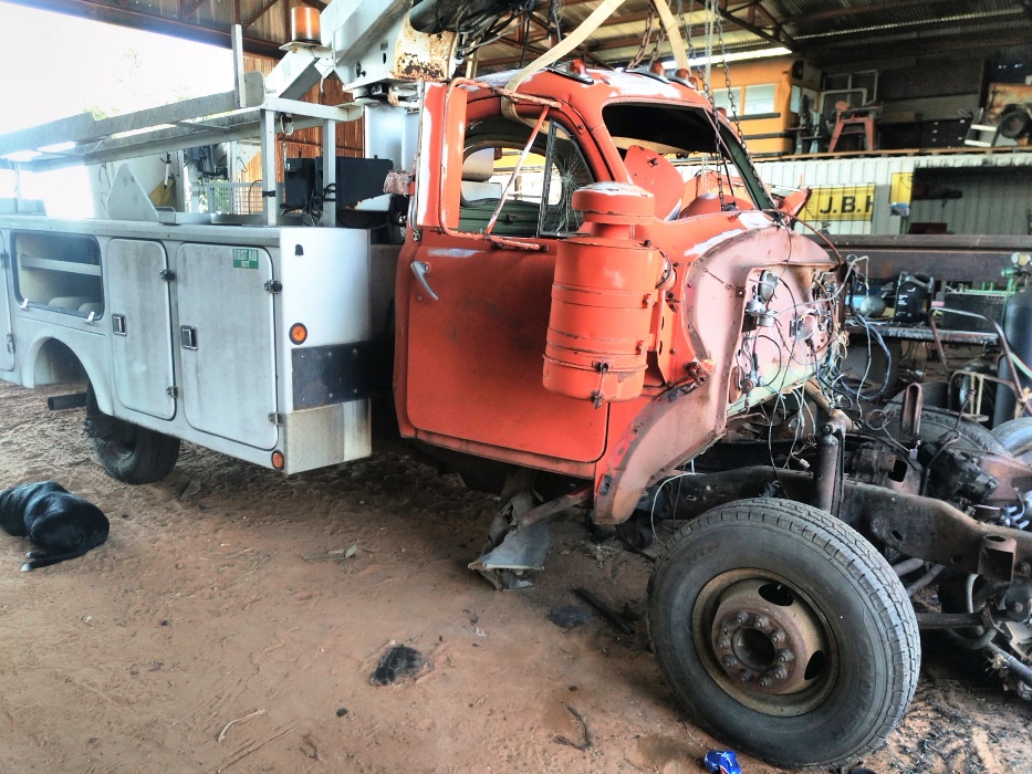

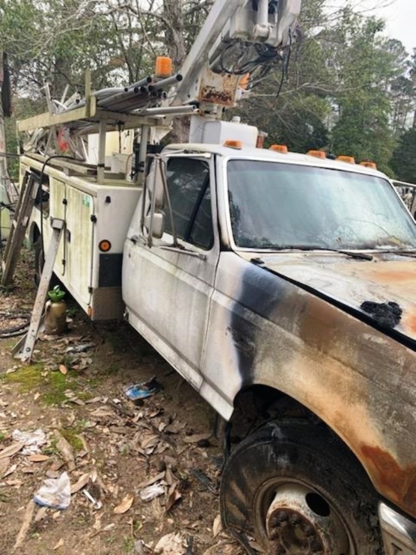

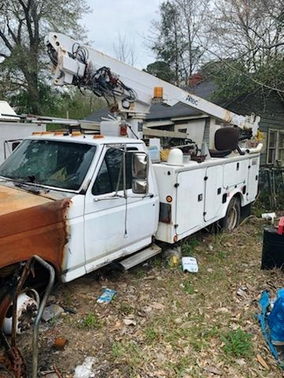

    I bought a 1996 Ford F Super duty bucket truck that had been burned. From the pictures the guy sent me I thought aw just some sanding and paint and a few parts it should be fine. Once it was delivered, I learned the fire had melted some of the accessories on the engine and the interior of the cab was nothing but a glob of plastic in the floorboard. No worries I just happen to have an exact cab to replace it with the only problem my replacement cab is nothing but a steel shell Lots of parts would be needed to be bought. Cheaper to buy another truck and pull the cab off it but that would be too easy and besides I have been saying I was going to do something with one of my old B model Mack cabs, hadn't I. Why not do a custom insanely stupid thing and marry the B model to the Ford, since I have to start with a bare shell anyway.
    This is going to be a work in progress which will be constantly changing as it progresses.
    First off, I don't really care if it turns out to be really cool or a steampunk rat job. it may wind up being a little bit of both.
    here are a few of the startup pictures.
    Sitting the cab on for the first time It doesn't look right.

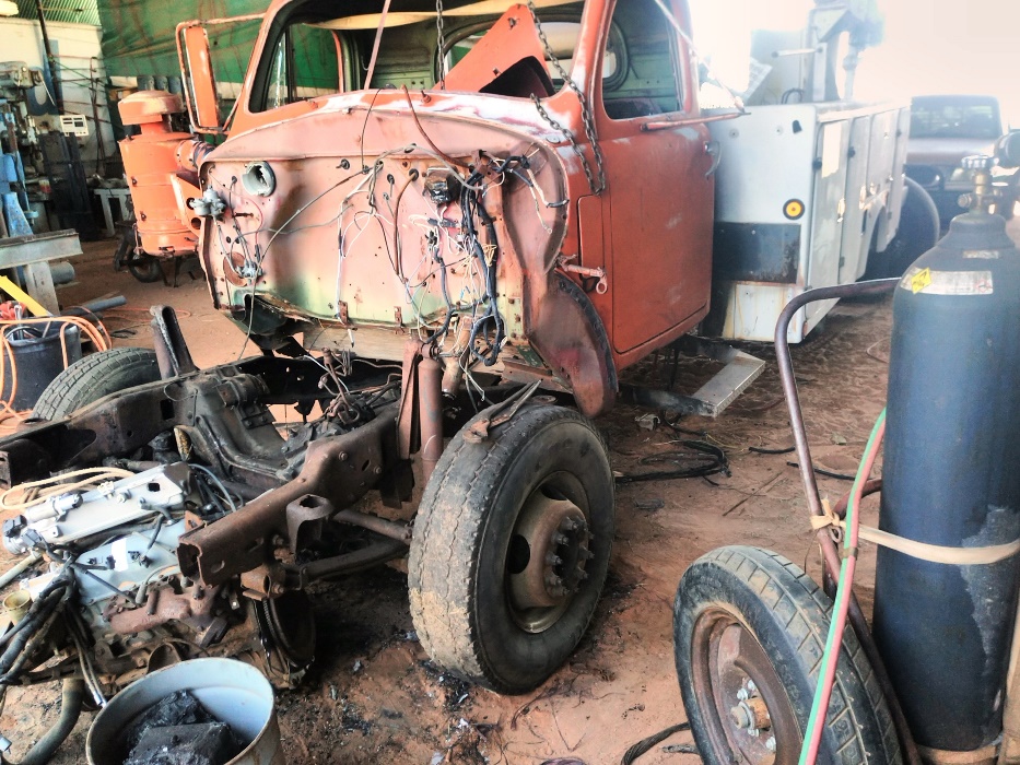

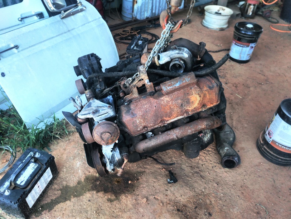

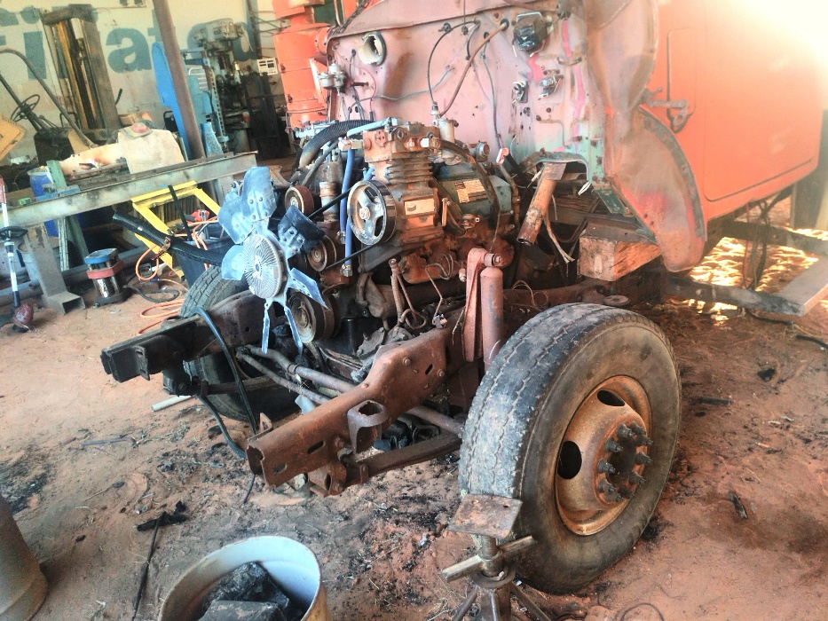

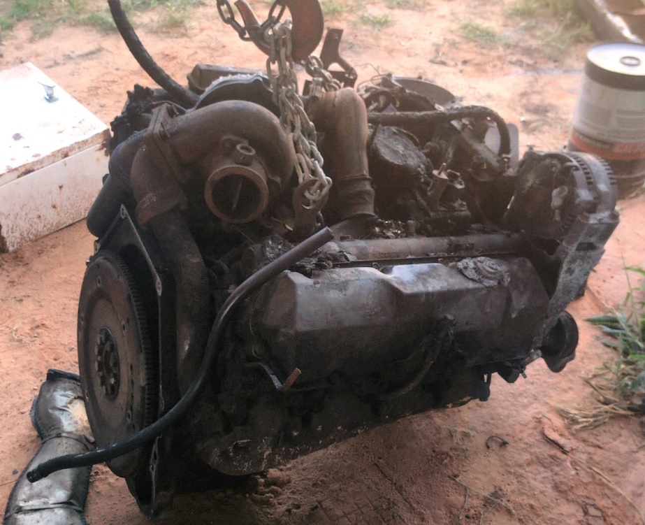

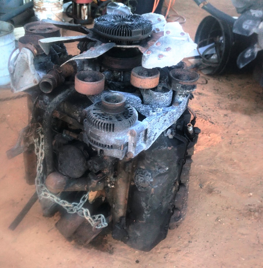

    The crispy engine. Nothing wrong with the engine that a few accessories and clean up wouldn't fix though. Who knows one of my 7.3 IDI engines may go bad someday if so, I could rob some of the accessories off them replace the melted turbo and drop the 7.3 power Stroke in either my 91 or my 93 pickups.

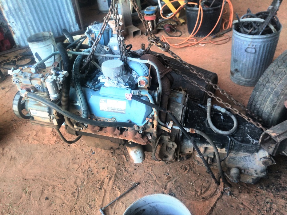

    Instead of bringing the Power Stroke back to life I'm going to use this Farmall AT444E Pretty much the same engine both share the same blocks heads and internals Both built by international the Ford engines turn higher RPMs have less torque and an oil pressure driven fuel system. they International has a different cam grind gear driven fuel pump with the fuel delivery done by electronic injection the same as the ford engine. but it turns a 1000 fewer RPM and develops more torque the Power stroke has 525ft lbs and the Farmal has 620 However with either engine a tuning chip can do wonders by adding a 100 HP and 200 Ft lbs torque Not that I will be doing that.
    first fitting of the engine

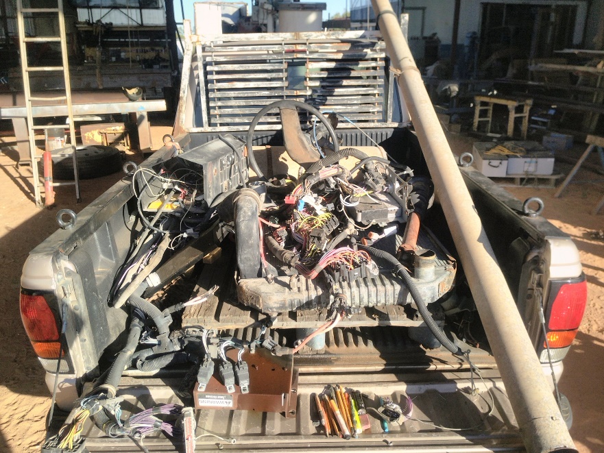

    Parts from the vehicle the 444 came out of

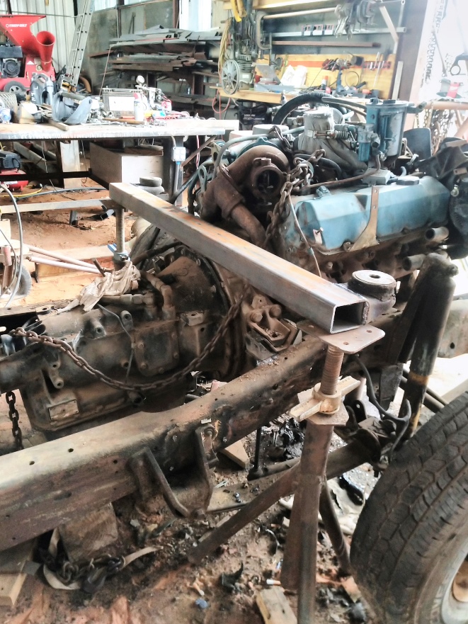

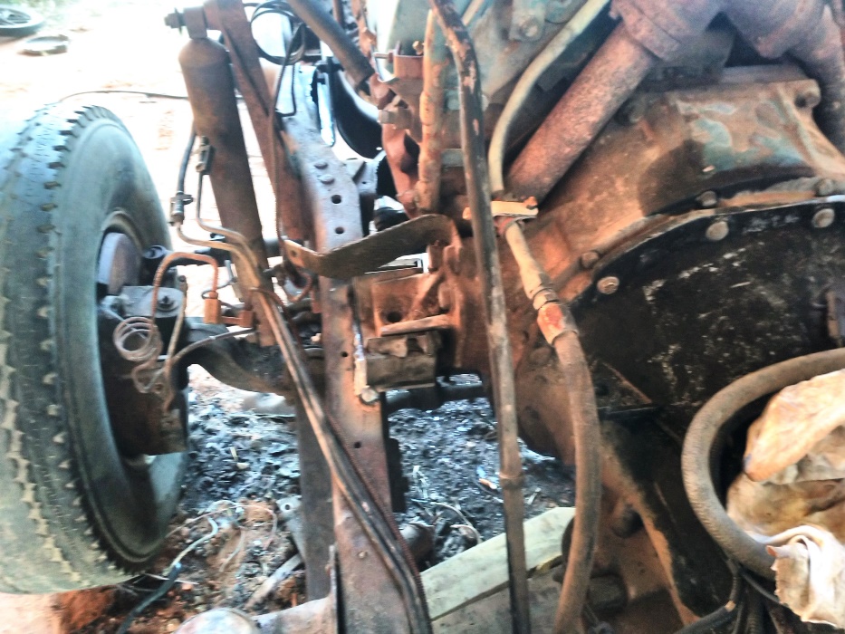

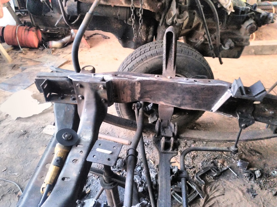

    front engine mount crossmember fitting.

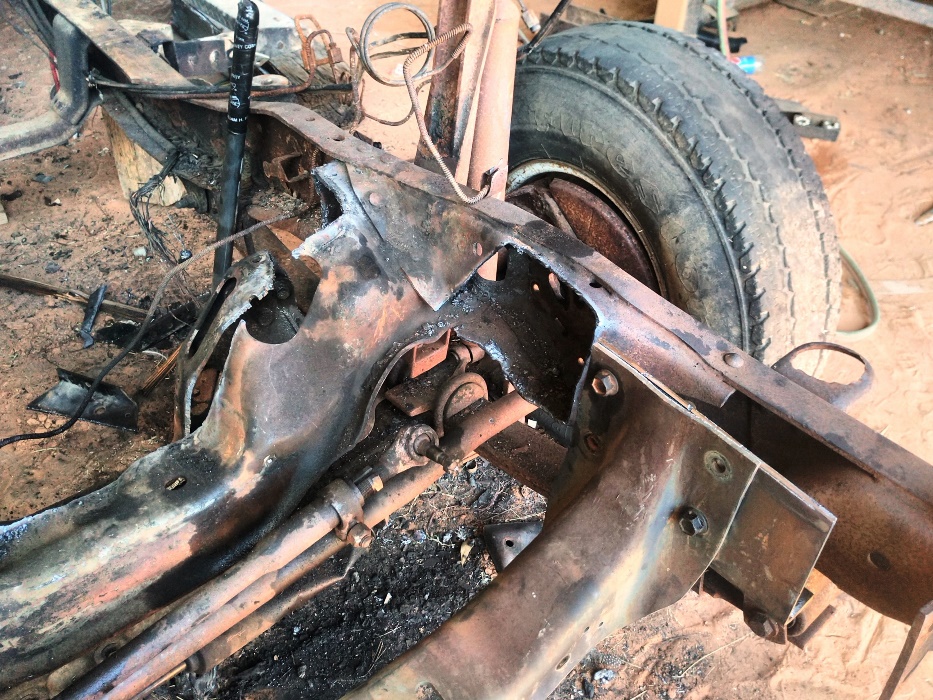

    Who needs a steering gear anyway? fact is I didn't like the position it was mounted in.

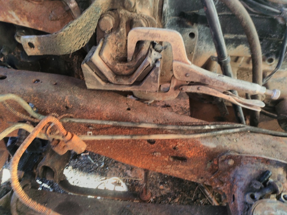

    first fitting of the rear engine mount
    Too late to move the engine now,

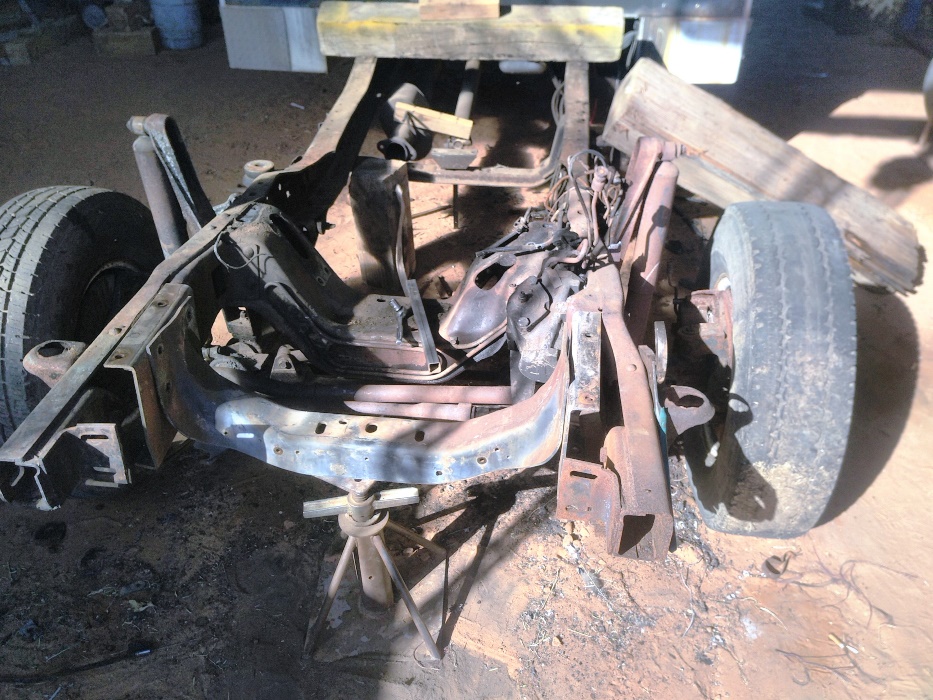

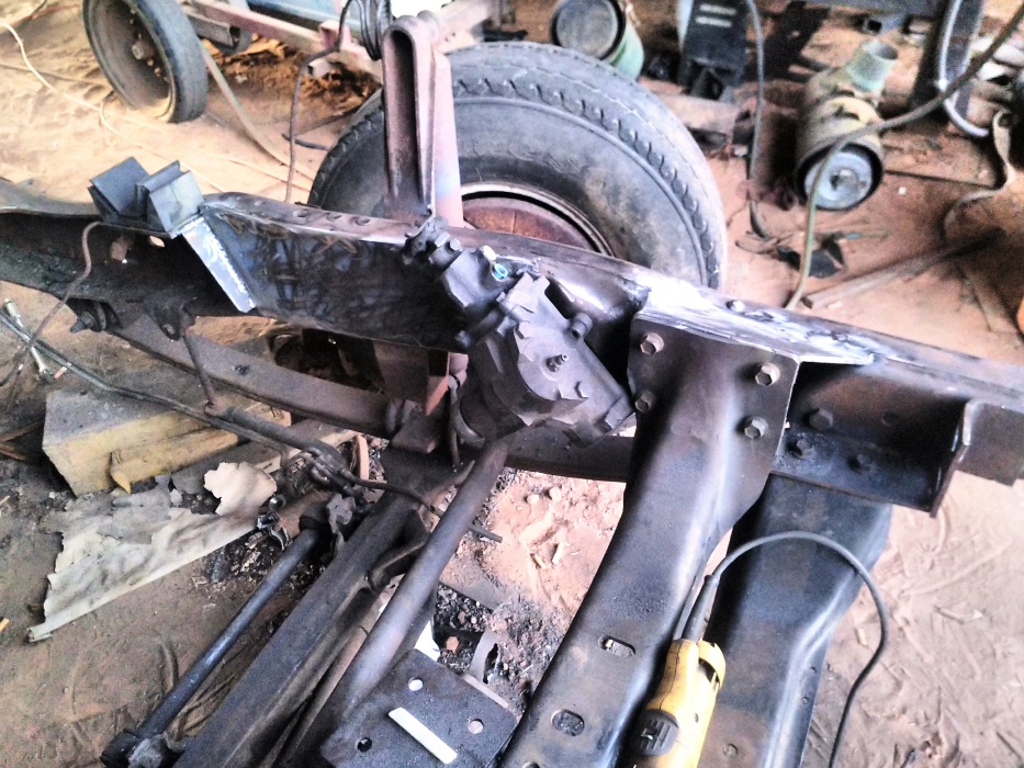

    After removing the old engine support crossmember adding two crossmembers in front 1 for the engine 1 for the core support I boxed the frame on both sides in this area from the crossmembers to the rear motor mounts
    looks like a good place to mount the steering gear. 20degree less angle and an inch further out in the frame
    The front cam mount in place which also serves as a crossmember for the rear motor mounts. Checking hood for slope and fitting to the radiator shell something's not right just yet.
