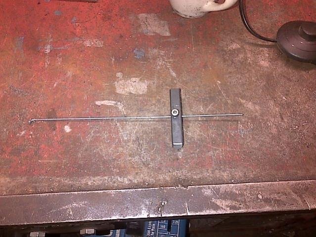

here are more bits ive made.
first is a simple depth gauge i made with 6yr old boy cos he wanted to make something.
its made from offcut of 12mm solid square bar and an old bikewheel spoke, now lives on lathe for when drilling holes.

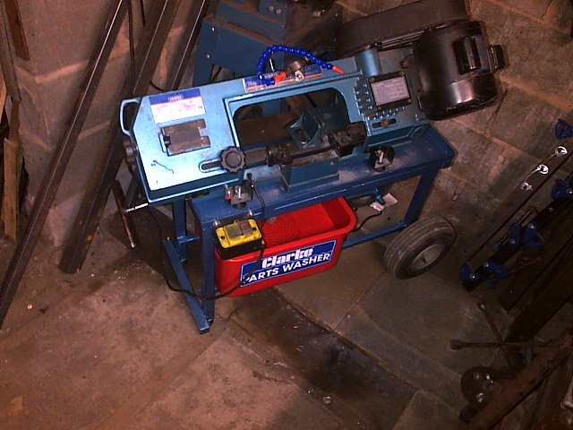

second is a bandsaw stand based on george carlsons one, made from 30mm box and a small parts washer for pumping the coolant, also got adjustable feet on front.
have use bath drain hole and std fittings for coolant drain.Attachment 799Attachment 800
