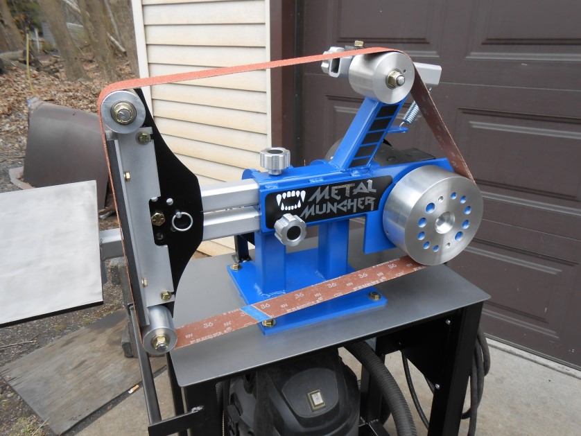

It's big, it's BLUE and it has an appetite for ferrous metal! It's the Metal Muncher! (sorry, I had to) :lol:
Attachment 34317Attachment 34318Attachment 34319Attachment 34320Attachment 34321Attachment 34322Attachment 34323Attachment 34324Attachment 34325Attachment 34326Attachment 34327Attachment 34328Attachment 34329Attachment 34330Attachment 34331Attachment 34332Attachment 34333

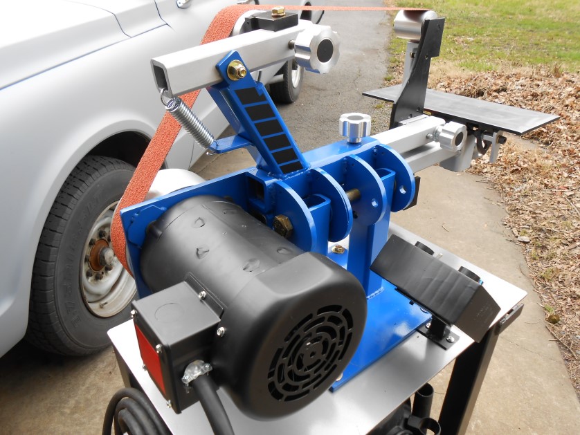

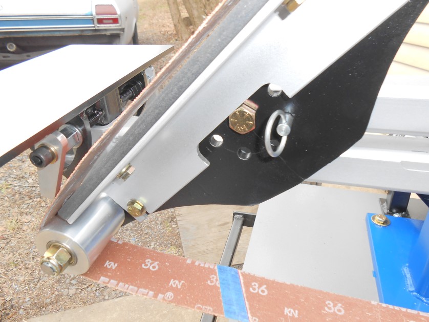

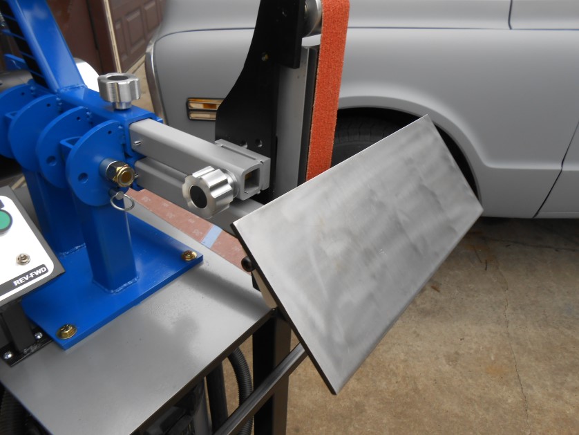

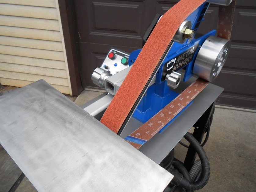

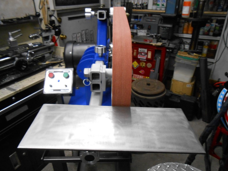

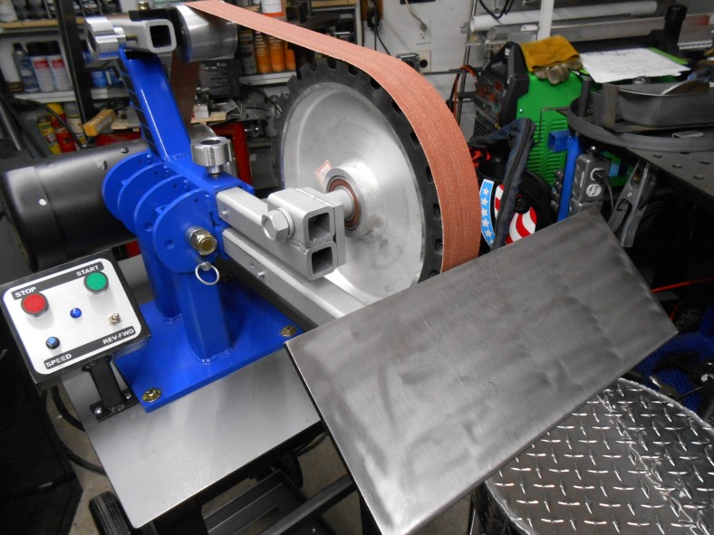

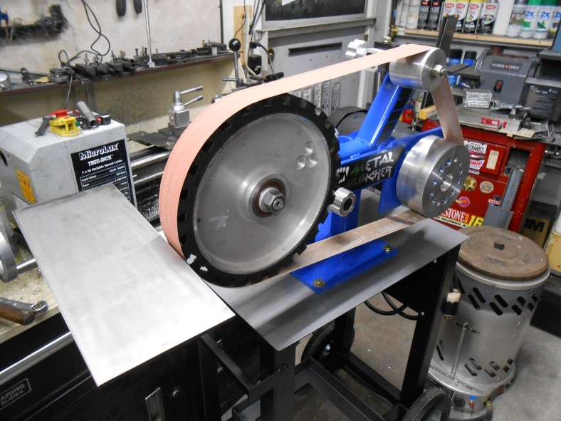

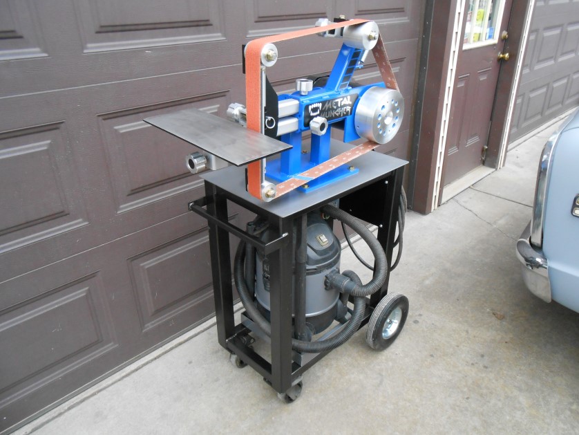

Thought I'd never get this done! I've been working on this since March 1st and putting in some long days to get here! It's been a ton of fun but a heck of a lot of hard work too! It's also the most expensive project I've ever built but considering commercial belt grinders of this quality run $2,500 - $3,000 that does take some of the sting away. (Sorry, I have not added everything up yet)

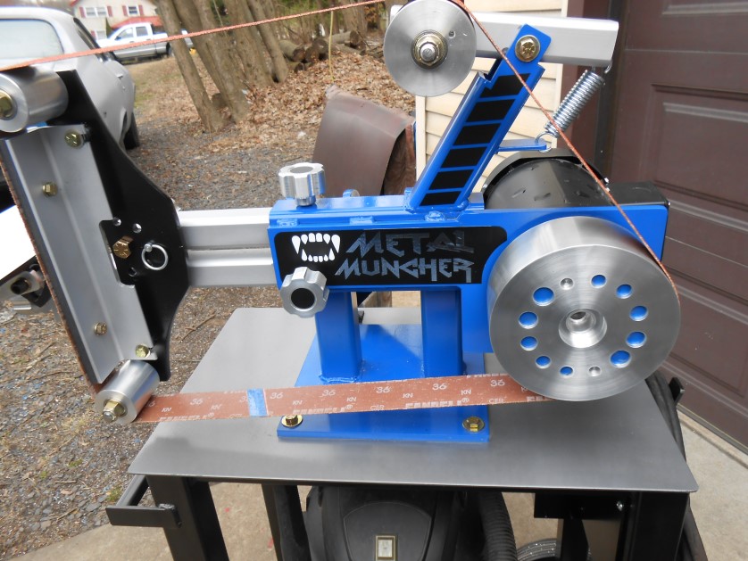

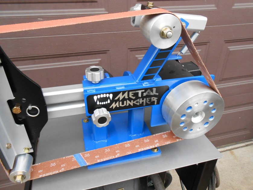

This is a 2 x 72 Belt Grinder built from plans that I purchased online and while I kept mostly to the specs, I did make a few tweaks here and there. Will be making modifications and upgrades as I see the need.

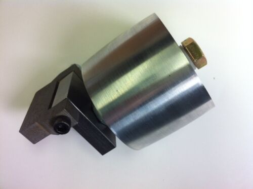

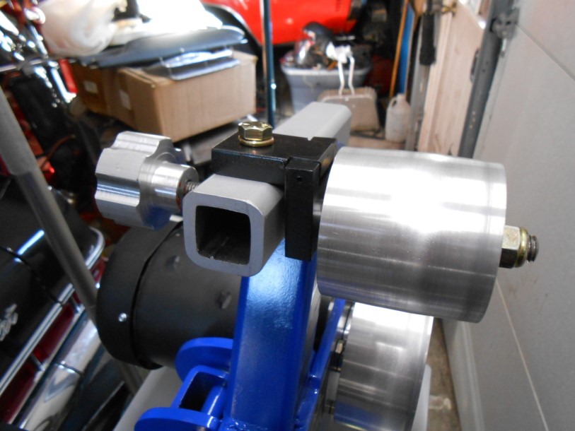

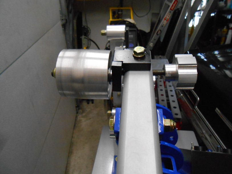

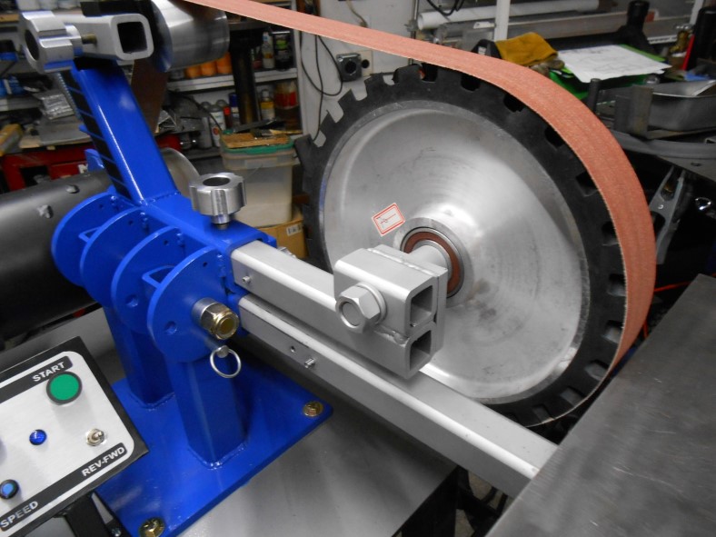

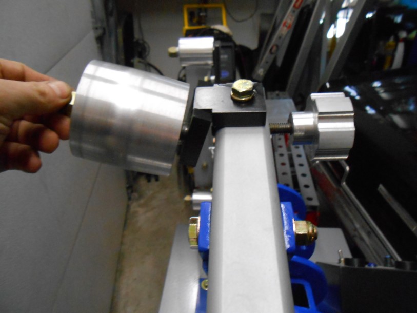

Like most things in my life, I like to do as much myself as possible. I opted to make my own wheels instead of buying them. I already had the 2 & 3 inch round aluminum stock and the bearings so a quick search on ebay turned up the 7 inch slab I needed for the drive wheel. Let me tell ya, working with a 7 inch chunk in a 6 x 4 band saw and a 7 x 16 metal lathe does present some difficulties but I eventually won the battle. ;) To do it over, I would just buy the drive wheel already made, it was the most challenging. I didn't save any money on that one but I guess I got some good experience and bragging rights anyway. :D

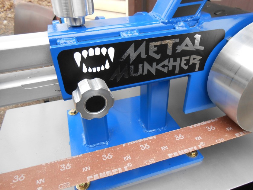

I made all my own knobs. The material I had already and this way I got to create my own design. All made from 6061 aluminum stock.

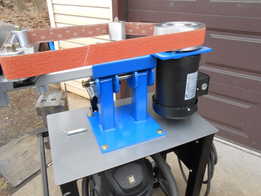

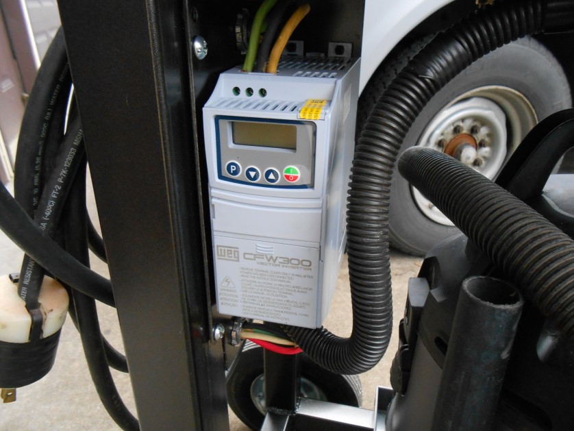

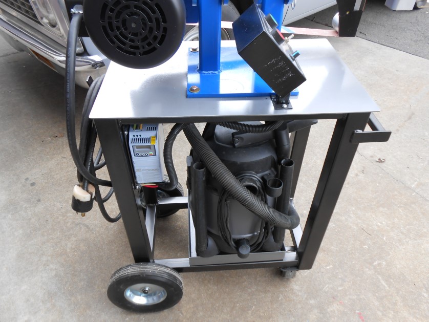

I did go with the 2HP Ironhorse motor that was suggested in the plans but found a VFD that was about $100 cheaper than the one they used. I'm really happy with the WEG VFD that I chose, it's crazy customizable!

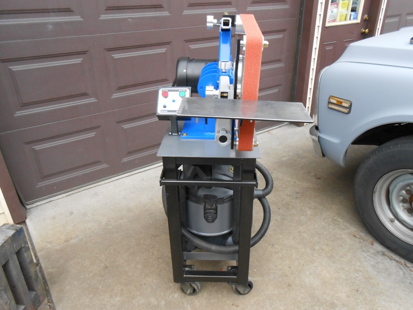

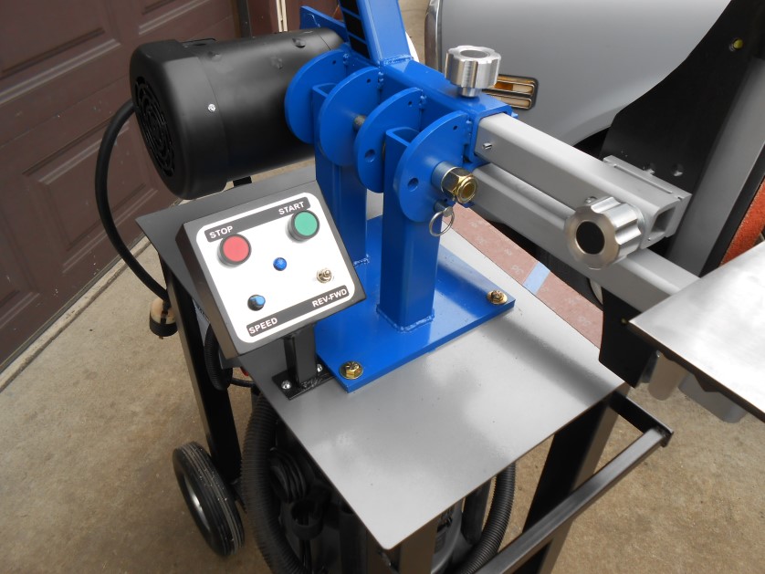

To keep the VFD which is the most valuable part out of the dust, I mounted it under the shelf to the rear. I made a seperate control panel and all controls are up top at fingers reach. It has Forward & Reverse as well as speed control.

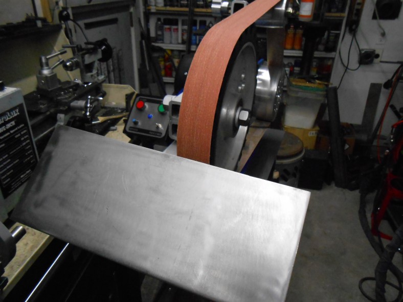

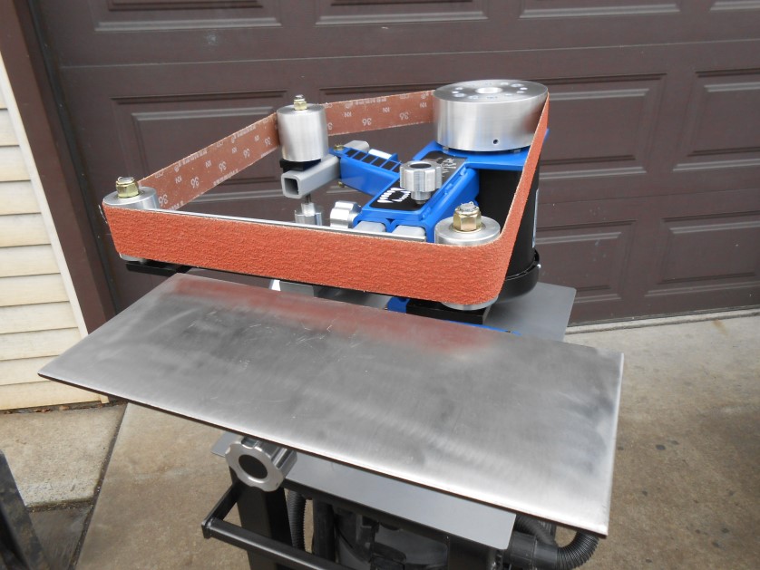

This unit works both vertical and horizontal and is STRONG!!! It's also very heavy but that's a good thing in belt grinders. lol

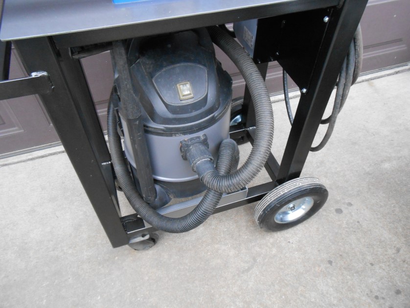

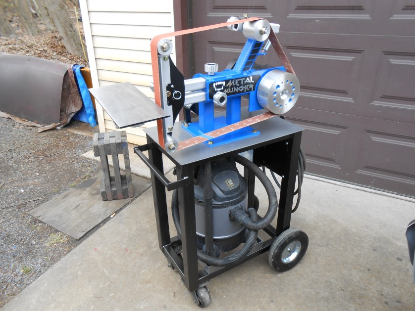

The cart (not part of the plans) I designed myself and I kept it as small as possible due to space limitations. (I need a bigger garage!!)
It's made of 2 inch & 1.5 inch 16ga tube and has heavy duty rubber front casters and solid 10 inch rubber rear tires.
Since I needed a place to store my small shop vac anyway, this was the perfect place for it! I will most likely add some type of dust control to the belt grinder so I'm half way there already. I designed this so I can very easily pull the vacuum out for jobs around the garage and cleaning my cars.
Specifications:
Verticle / Horizontal sanding positions
Forward / Reverse / Adjustable speed
VFD: Weg CFW-300
Motor: Ironhorse 2HP AC Induction 220 volt 3 phase motor 3600rpm, 5/8 keyed shaft
Switch panel: I designed and fabricated the control box myself and used some switches I had on hand and a few I bought on ebay for this project.
7" x 2-3/4" inch drive wheel.
3" x 2-3/4" tracking wheel with a 1 degree crown.
2" x 2-1/2" platen wheels.
Bearings: R8ZZ
Hardware: Grade 8
Graphics: I did all the vinyl graphics myself using a Cricut cutting machine.
Colors: Deep Gloss Blue Rustoleum, Metallic Black Rustoleum, Hammered Silver Rustoleum and Flat Aluminum.
Weight: HEAVY!
