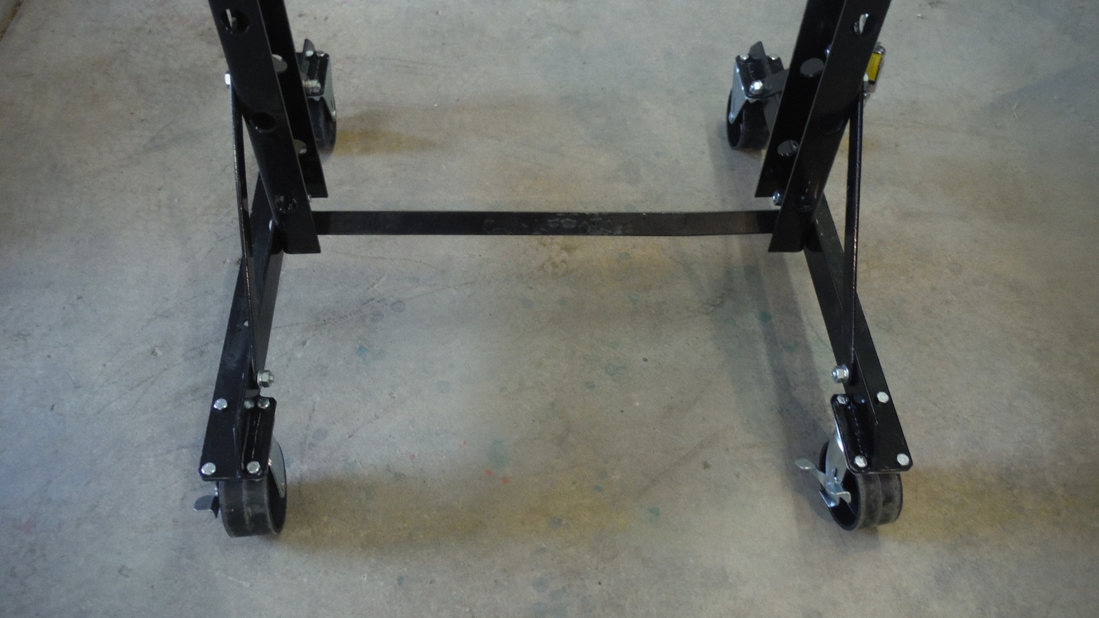

So, some mods were in order right away. Casters (fixed in the rear, swivel in front) were bolted on after adding a small plate to the inside of the bottom rails. Surplus Center caster set p/n 1-4706

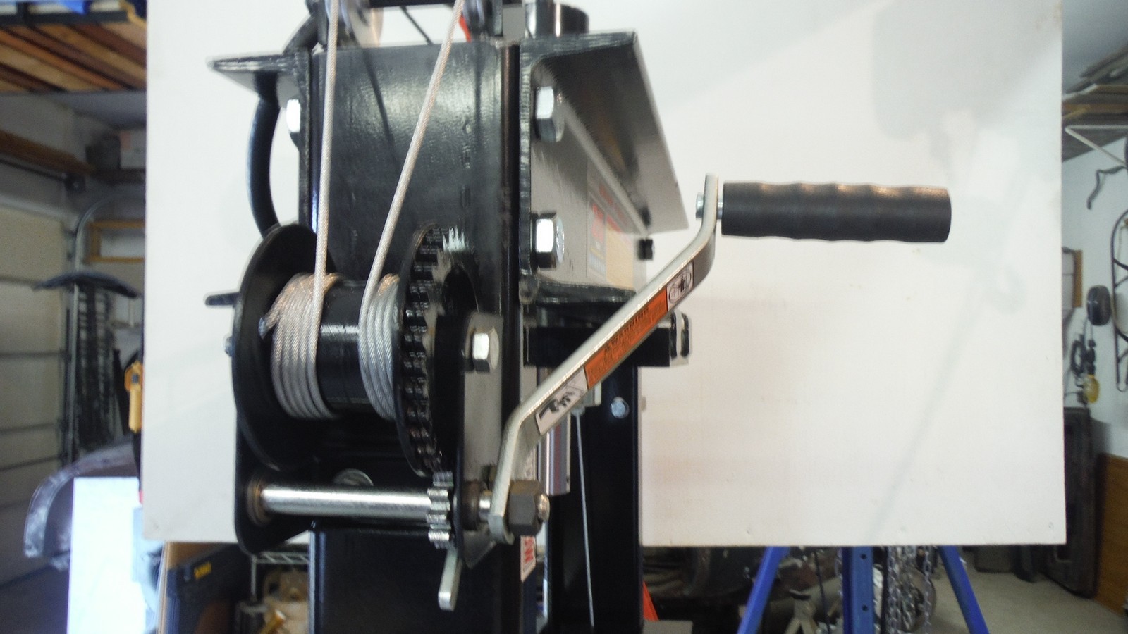

Next was to add a small winch (boat type) to raise/lower the "work press table" as this is a Royal PITA to manually move without it falling to the floor, or worse, on one's foot.
Even more so if you have parts or spacer blocks, aka heel blocks, on the table and need to move it up/down.

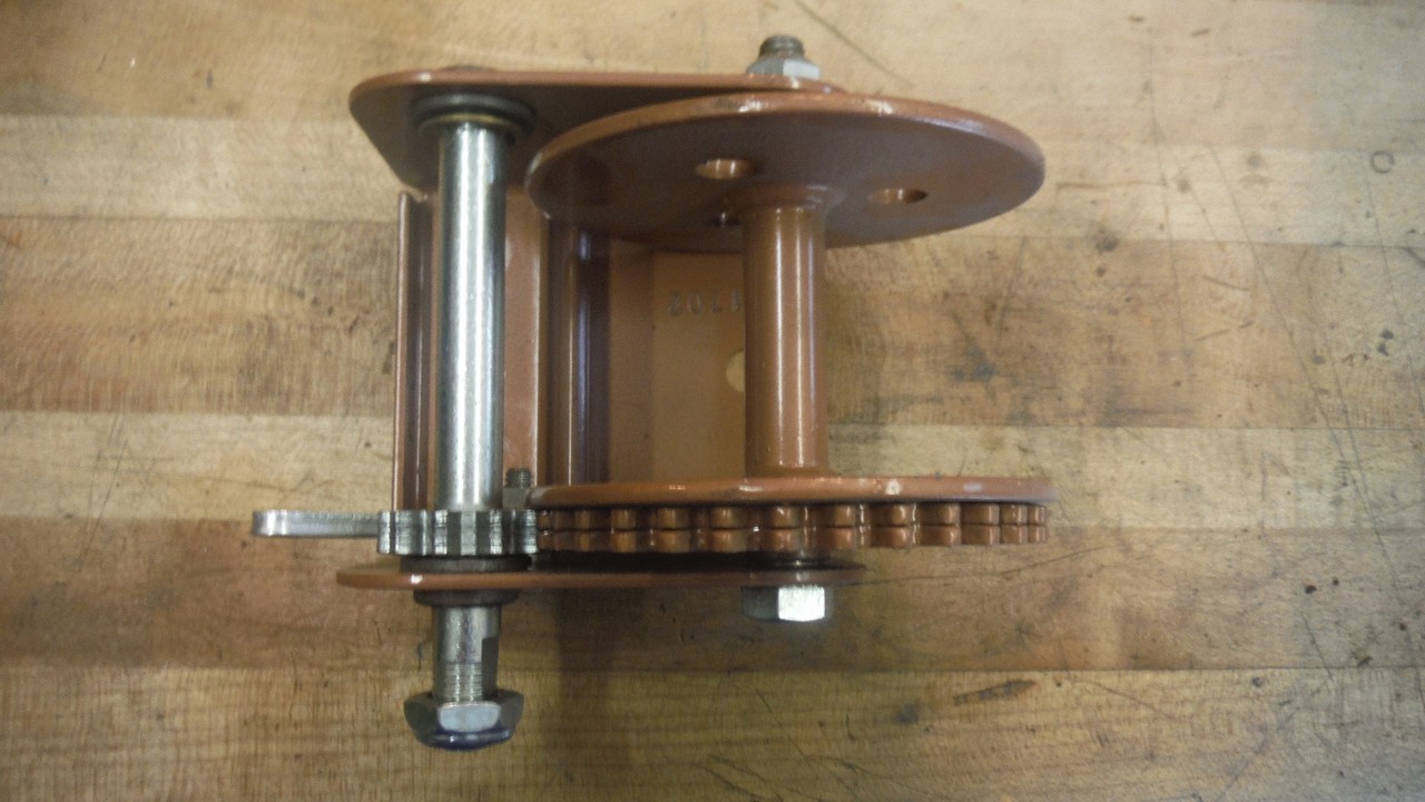

Modified a Dutton-Lainson winch by adding a 2" diameter "spool" to the drum, so that the cables start winding faster. The stock spool was only about 5/8" diameter.
Attachment 25352

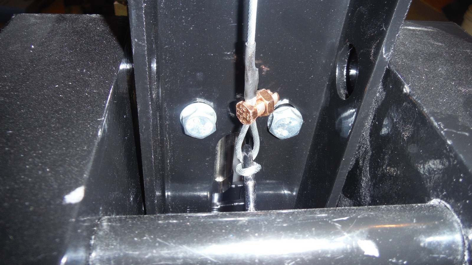

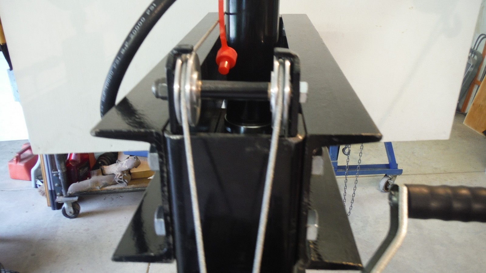

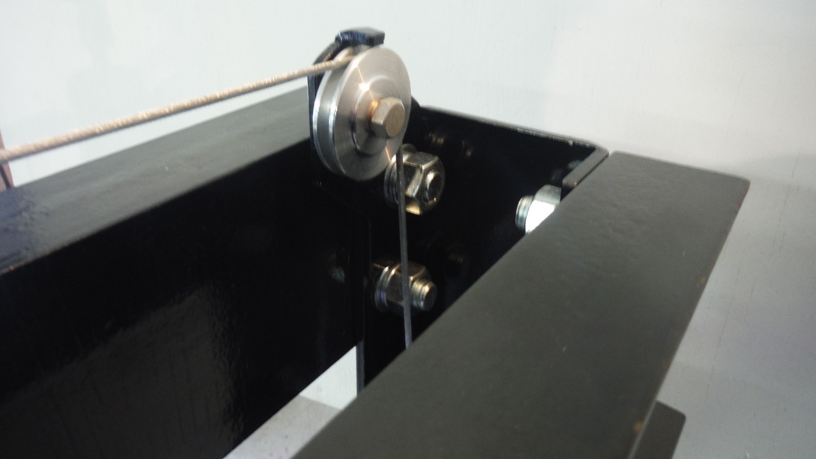

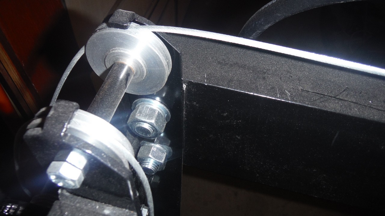

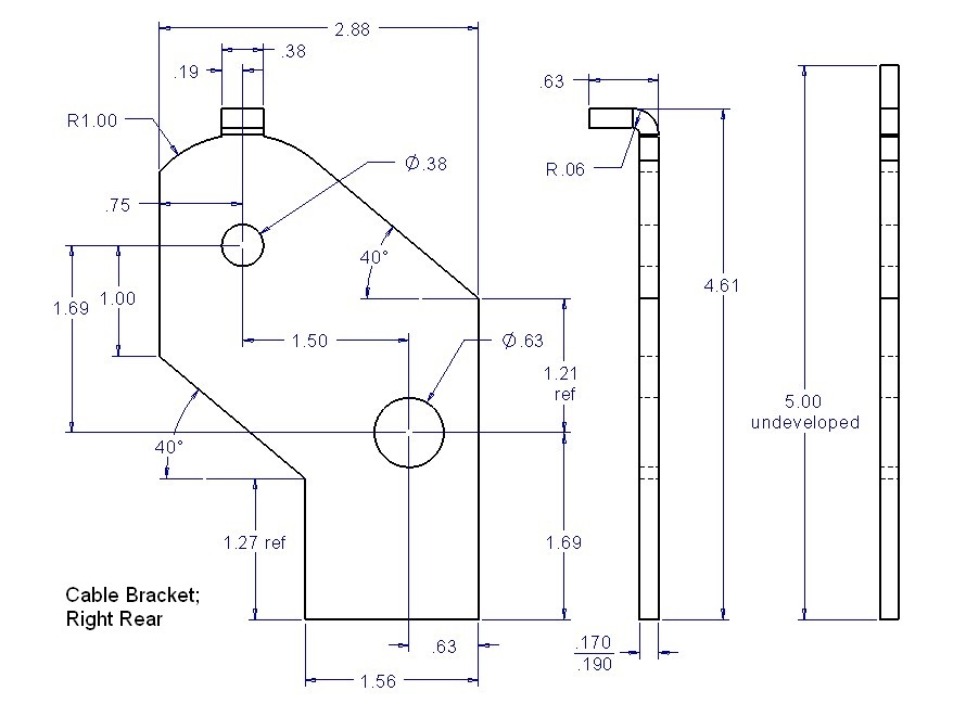

The cables are then routed over some pulleys
Attachment 25353 Attachment 25354
and connected to the spacer tubes using some electrical ground wire clamps.
.....here, short chain links welded to the spacer tubes of the table provide an anchorage for the 1/8" cables
Attachment 25351

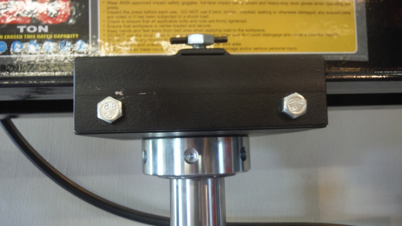

I didn't like the way the cylinder plate fit loosely on the top beams; made things wobbly and there was wasted motion when pumping; so I modified that arrangement to allow it to slide left/right, yet have very little clearance in the vertical plane.
Put a roll pin in the head of a 1/2-13 HexHd screw just to take up what little slack there was. 1 in front, 1 in rear.
Attachment 25355

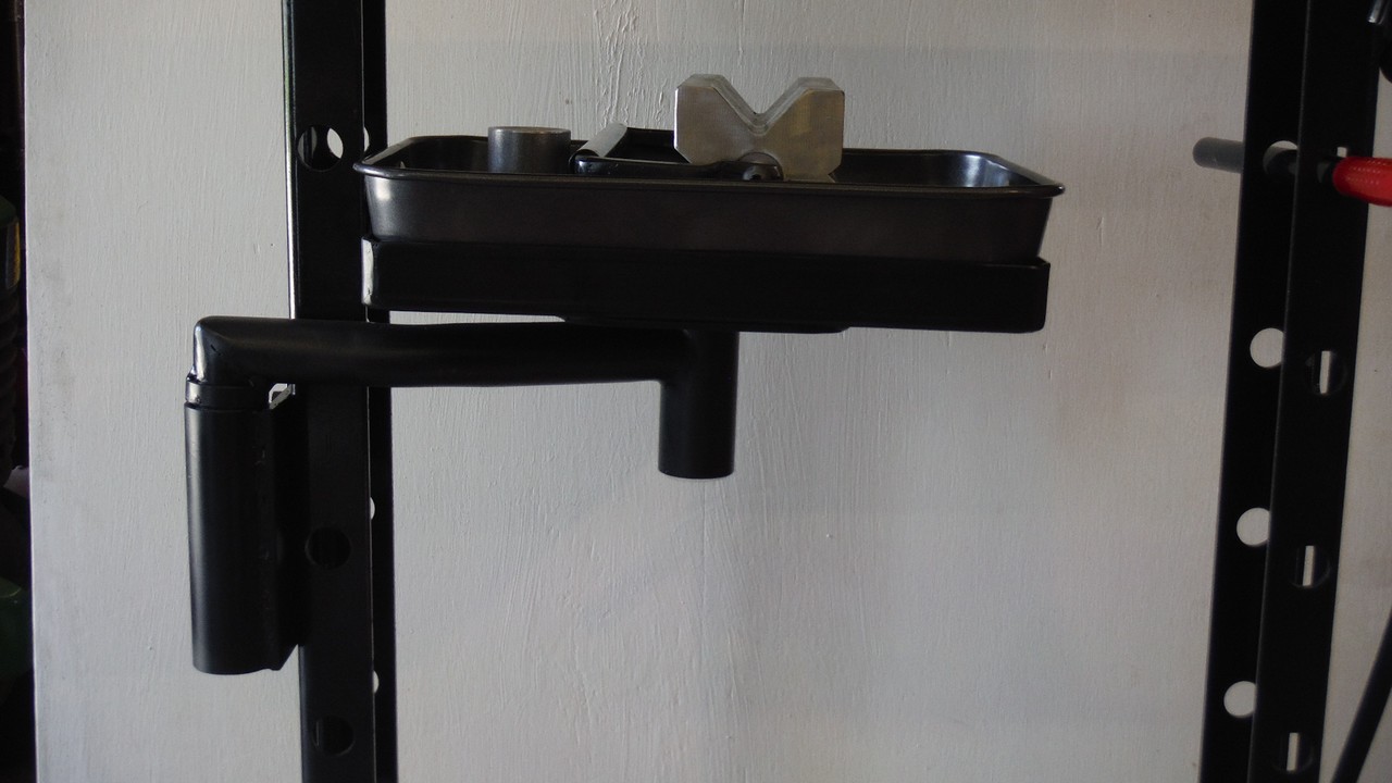

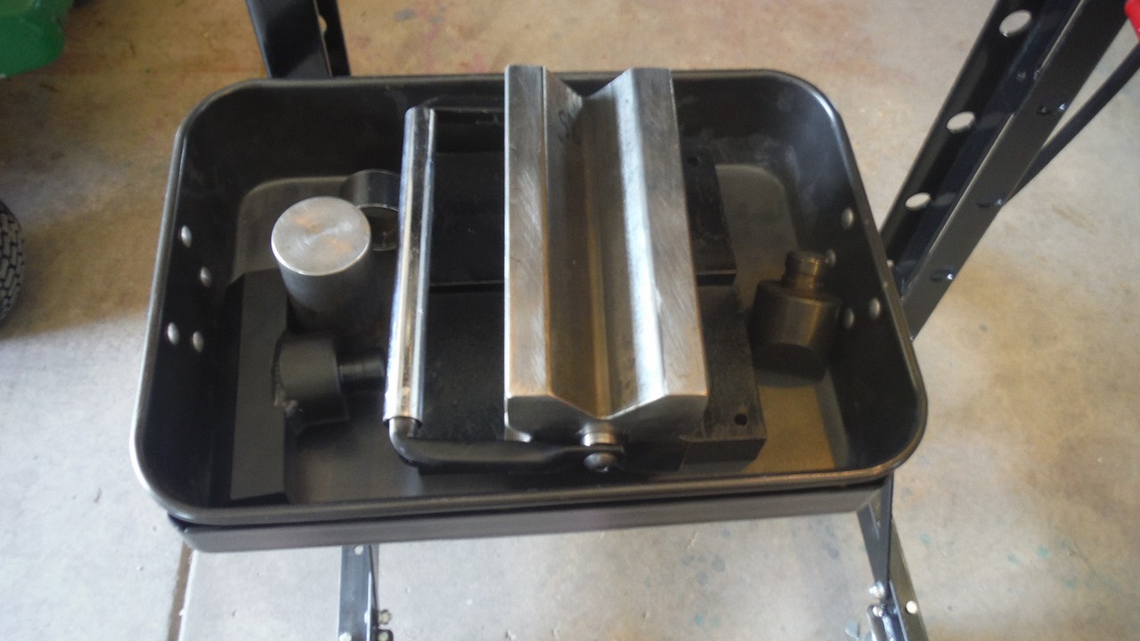

Next, I visited the local Goodwill and got a nice alum cook pan. Made a swing-out frame and holder for all the press tools needed.
A friend had a long piece of a 4-sided V-die and we cut off an 8" long piece. Drilled holes in the ends and made a handle for it
(Like to keep my toes) Made a couple of V arbors for the ram. These sure come in handy for bending.
Attachment 25356
The swing-out pivots outward to the left and allows the table to be moved to the lowest setting without getting in the way.
Attachment 25357

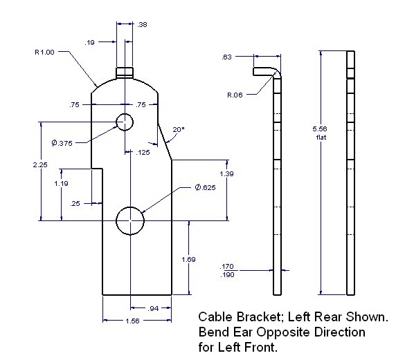

I've got some drawings of the pulley mounts if anyone is interested. Got the Dutton-Lainson p/n too.
