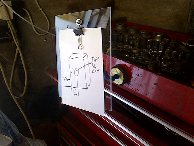

1 is magnetic note holder as tired of getting notes greasy working on the machines.

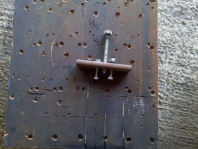

2 is steering wheel puller for landrover defender.

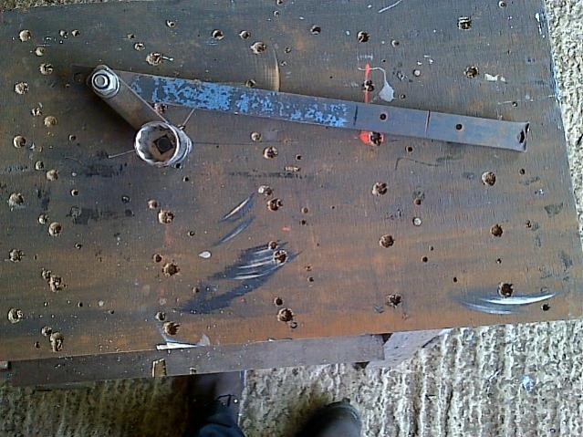

3 is whacker bar made from 1/4" x 1and1/4" flat bar with centre from 1/2" ratchet welded to small pce that pivots.
allows long pce to be hit with hammer and shock stubborn crank nuts freeAttachment 735Attachment 736Attachment 737
