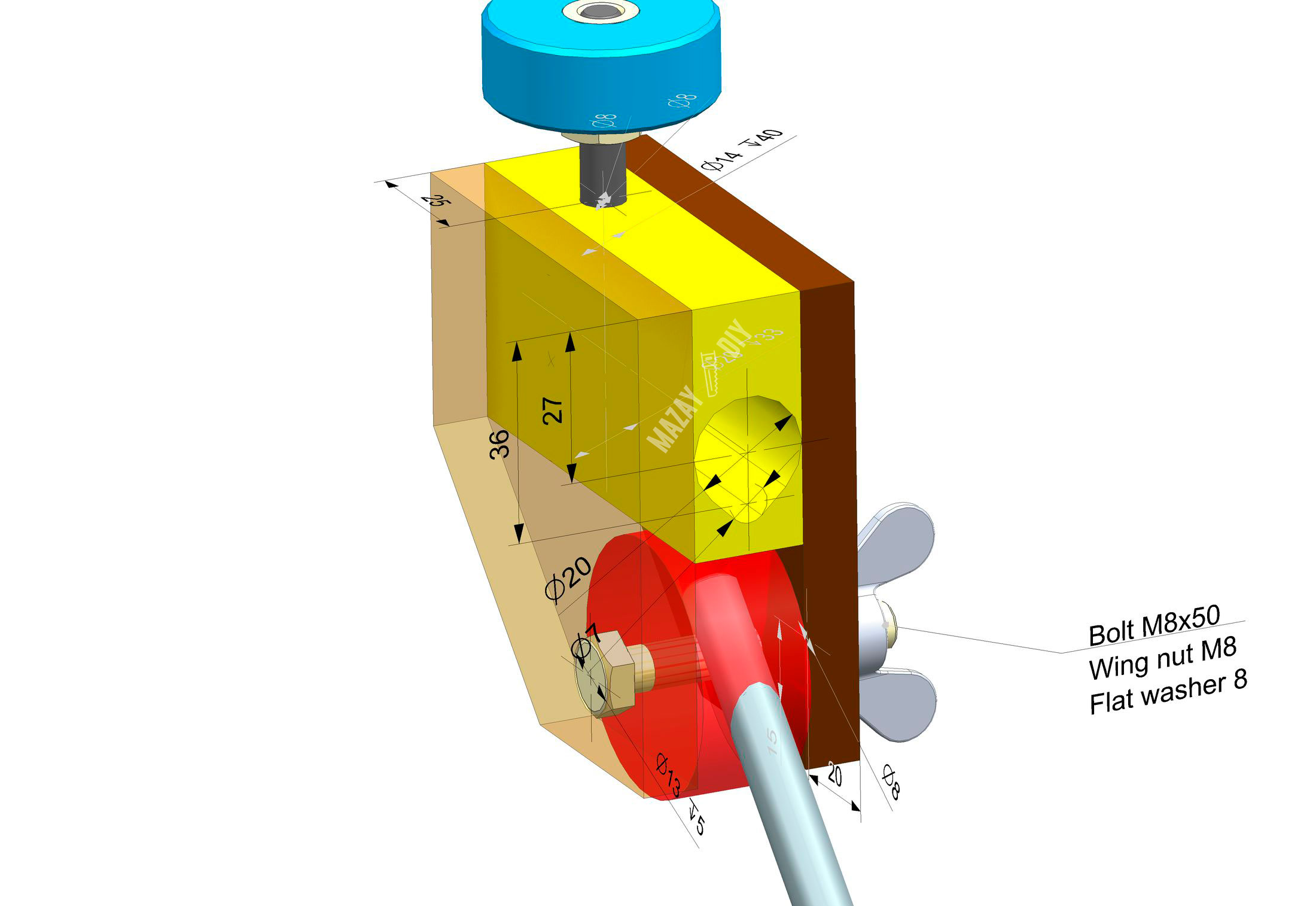

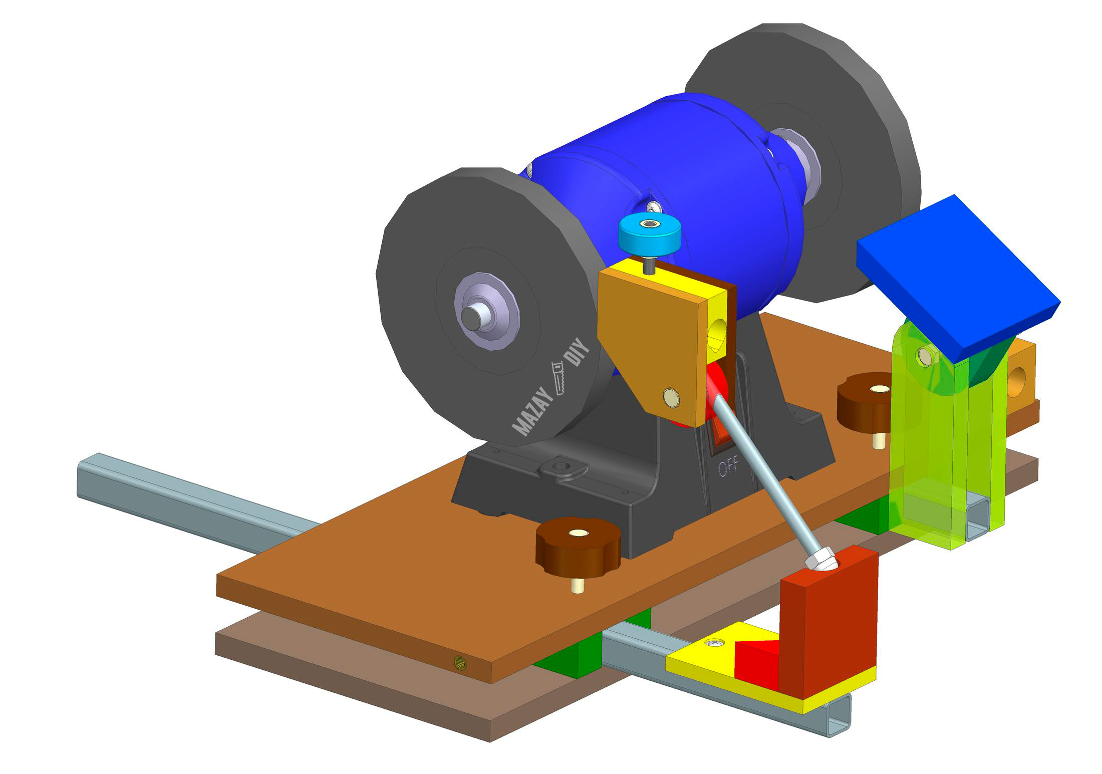

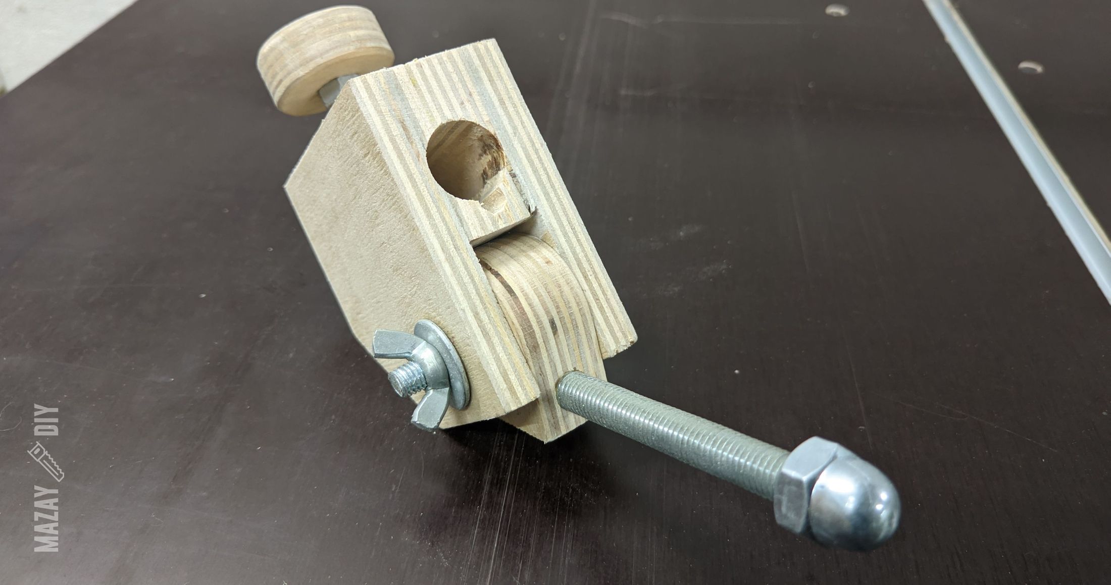

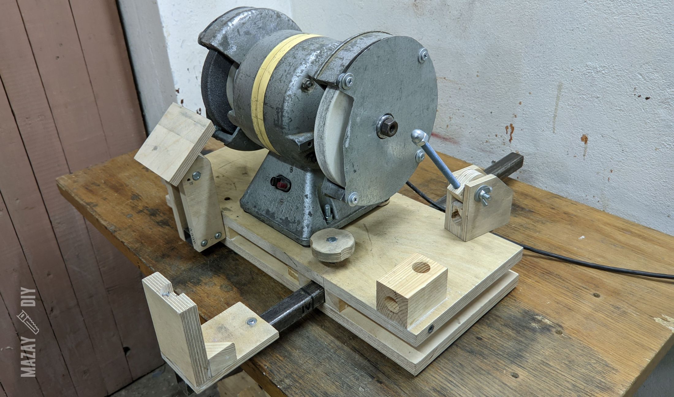

Making Three DIY Sharpening Jigs for Woodturning Tools
https://youtu.be/oUd9a1TqoyI
📐 Free PDF plans
3D CAD model
Attachment 42006 Attachment 42007 Attachment 42008 Attachment 42009
📐 Free PDF plans
3D CAD model
