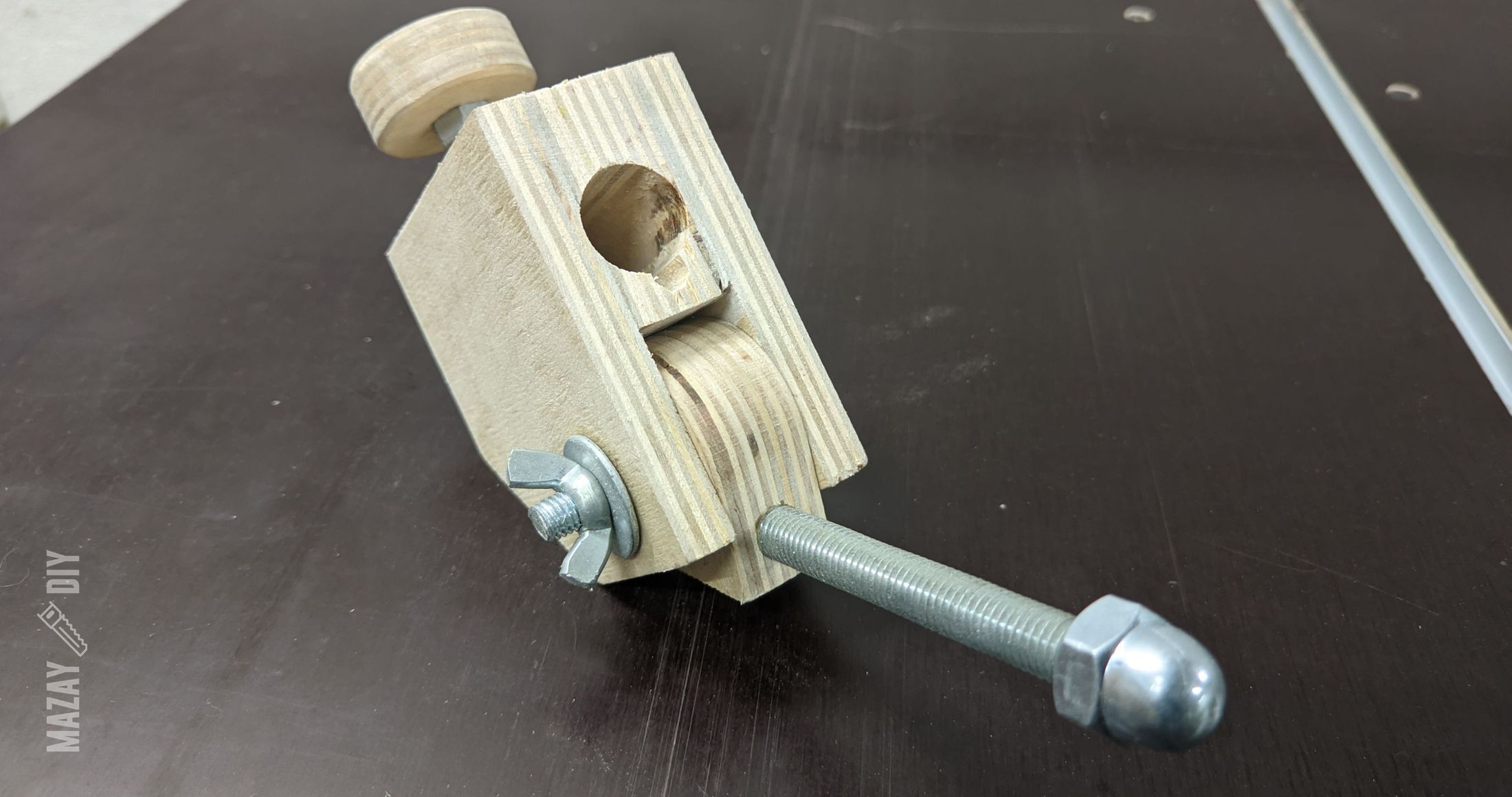

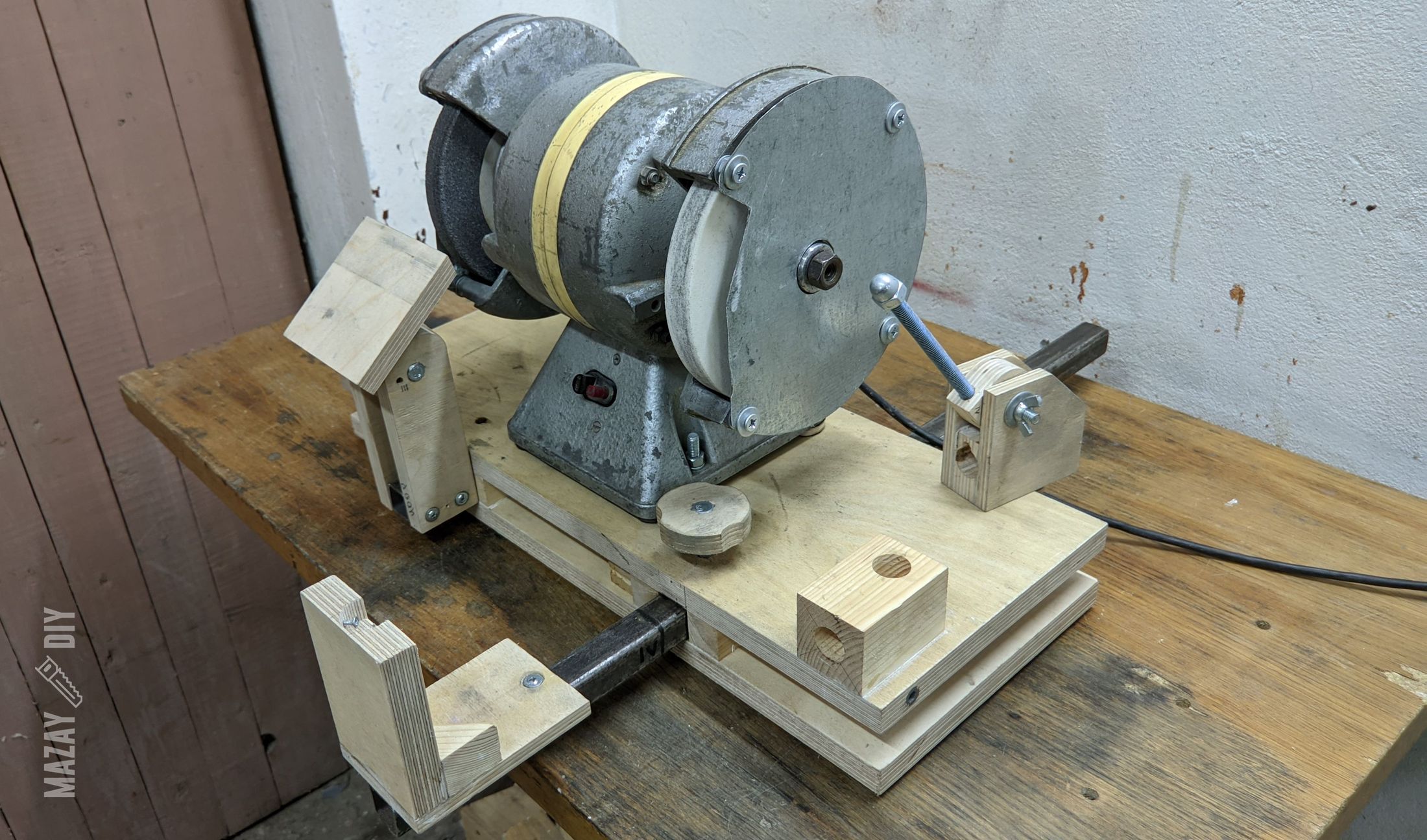

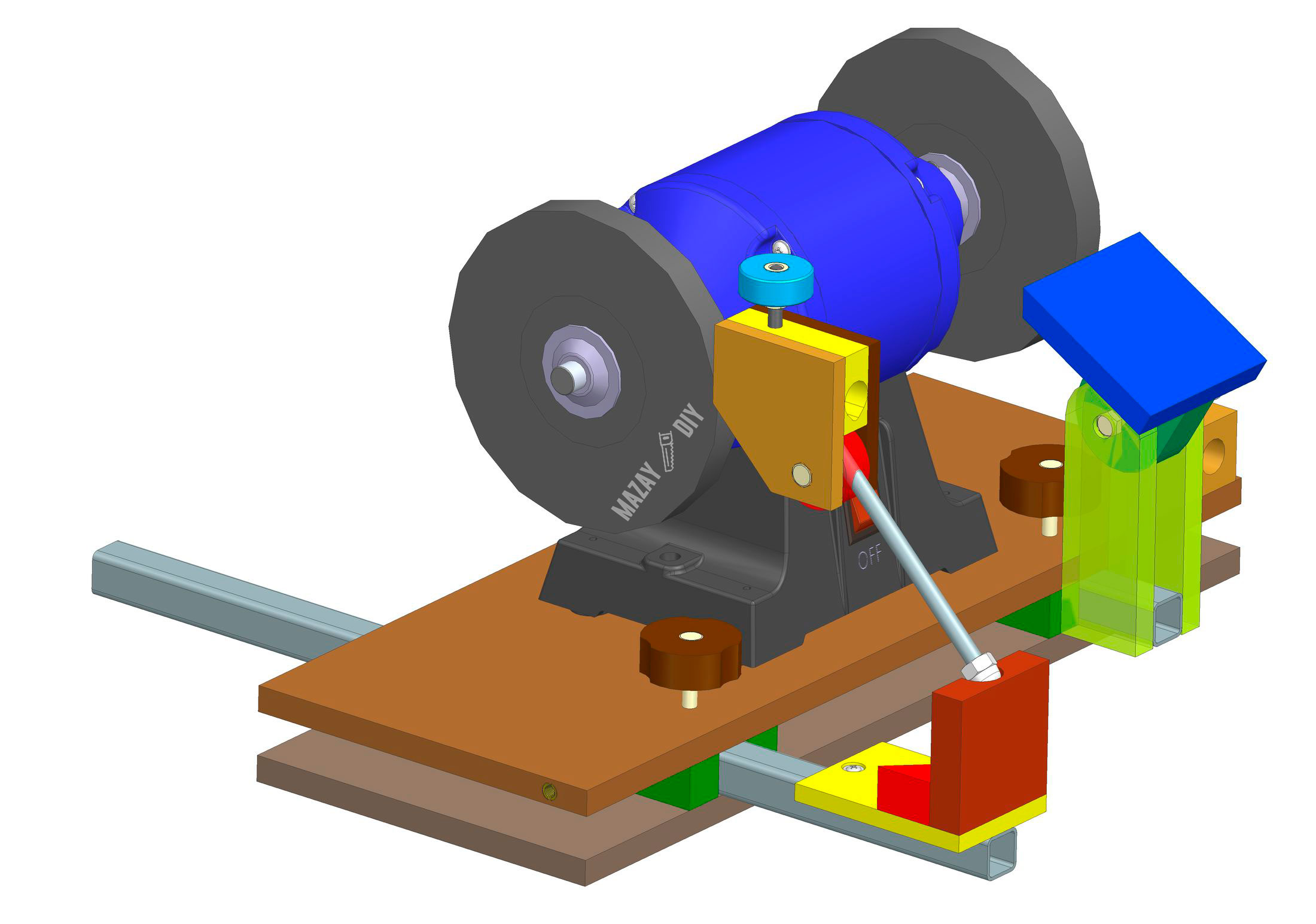

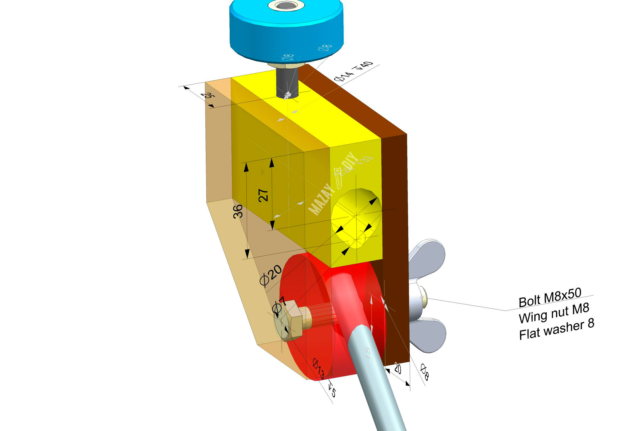

    Making Three DIY Sharpening Jigs for Woodturning Tools
    📐 Free PDF plans
    3D CAD model
    3 Homemade Sharpening Jigs for Woodturning Tools [free plans]-homemade-tool-sharpening-jigs-1.jpg 3 Homemade Sharpening Jigs for Woodturning Tools [free plans]-homemade-tool-sharpening-jigs-2.jpg 3 Homemade Sharpening Jigs for Woodturning Tools [free plans]-homemade-tool-sharpening-jigs-3.jpg 3 Homemade Sharpening Jigs for Woodturning Tools [free plans]-homemade-tool-sharpening-jigs-4.jpg
