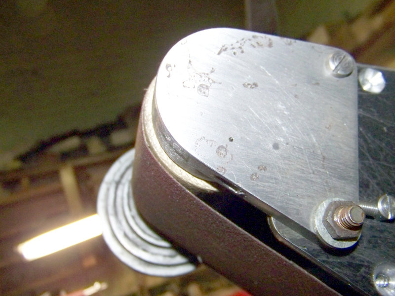

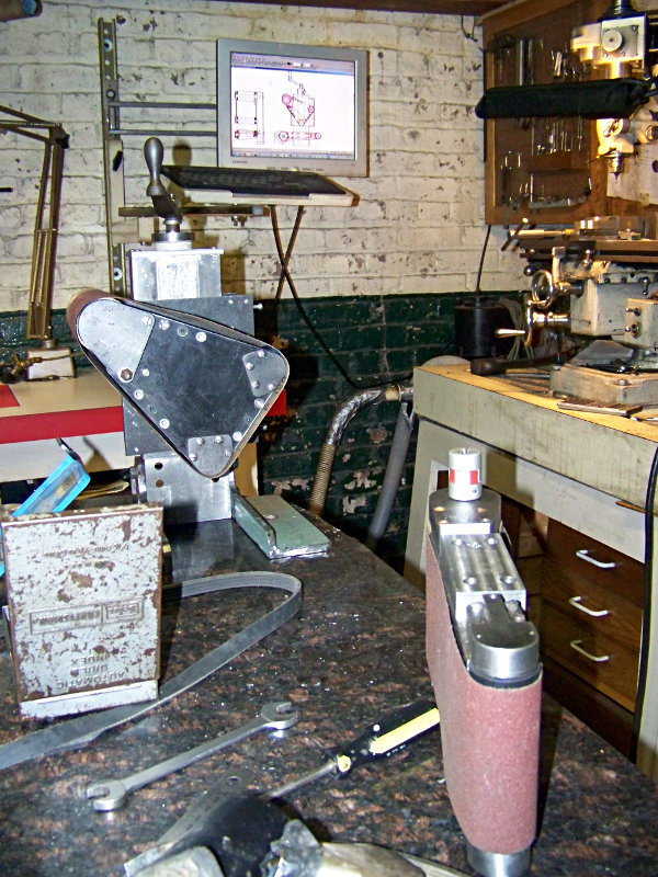

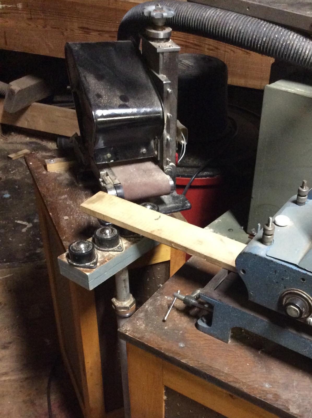

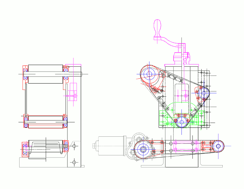

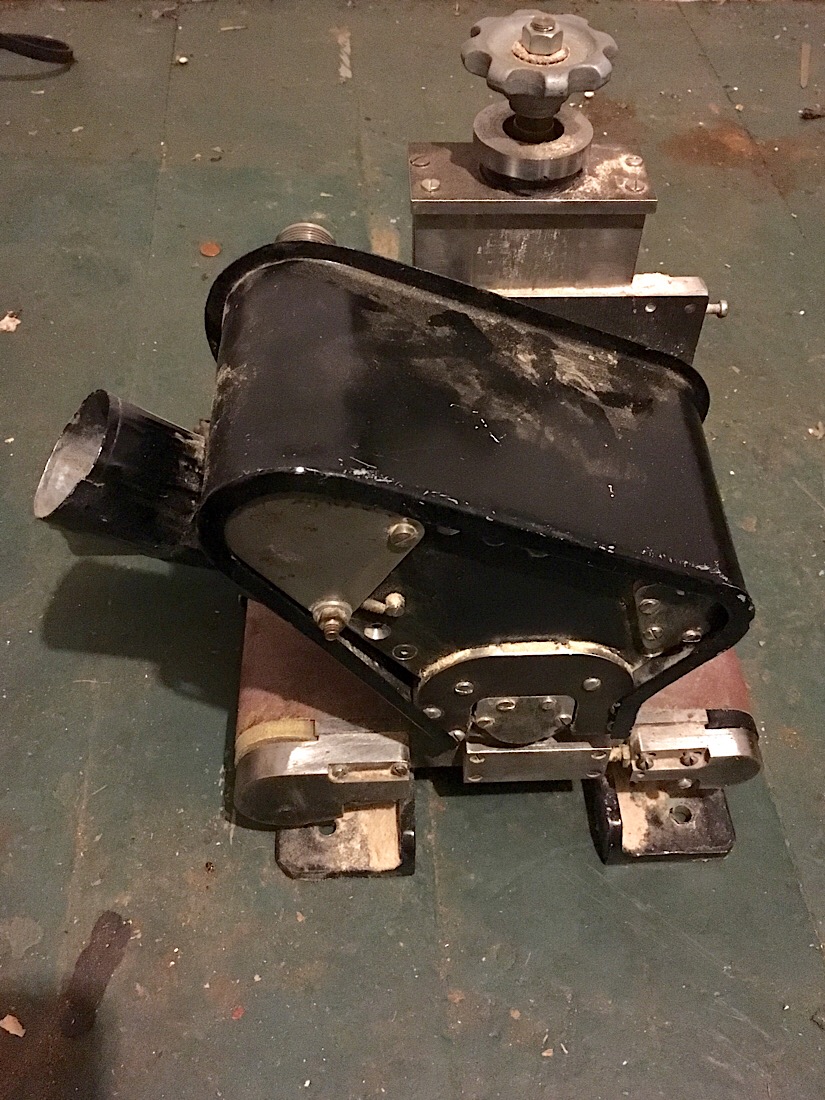

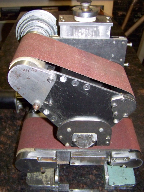

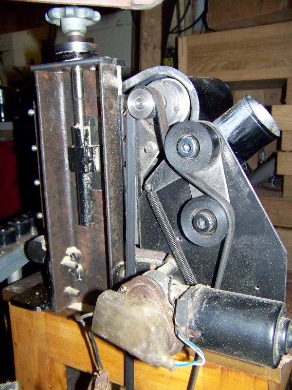

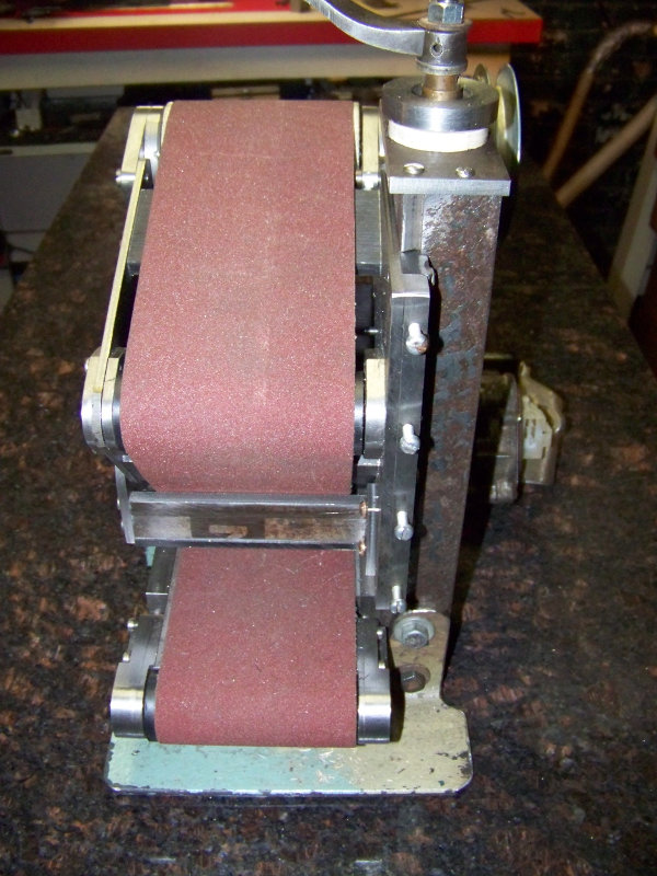

    I use this sander to make little wood pieces more uniform. It’s similar to lighter open-sided machines from Performax and Jet, but smaller and not really practical for finishing anything long, thick or wide.
    Like on those, the sanding head moves to adjust thickness. Both it and the feeder take 3 x 24” belts. Pressure bars like on wood planers are on both sides of the bottom roller, with the front one segmented to allow narrow pieces to go through.
    It’s very small! But so are the parts I use it for - the smallest pieces I’ve run through are about 1/2” long and 7/32” thick, even 6” long pieces are rare.
    Apart from the self aligning ball bearings most of the parts and materials were recycled: a wiper motor, wringer washing machine and dot matrix printer rollers, old structural channel, and steel plate cut from a treadmill.
    3 inch thickness sander-ts01_frontonfloor.jpg 3 inch thickness sander-ts02_side.jpg
    3 inch thickness sander-ts03_-front.jpg 3 inch thickness sander-ts04_-driverear.jpg

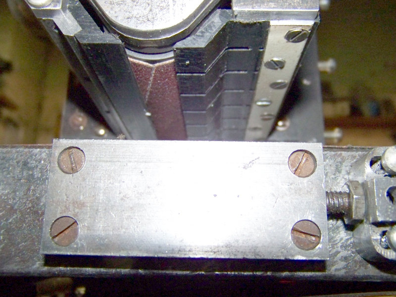

    Delrin pressure bars, and tracking adjusters:
    3 inch thickness sander-ts05_-lowertrackingadjustmentandpressurebars.jpg 3 inch thickness sander-ts06_-uppertrackingadjustment.jpg

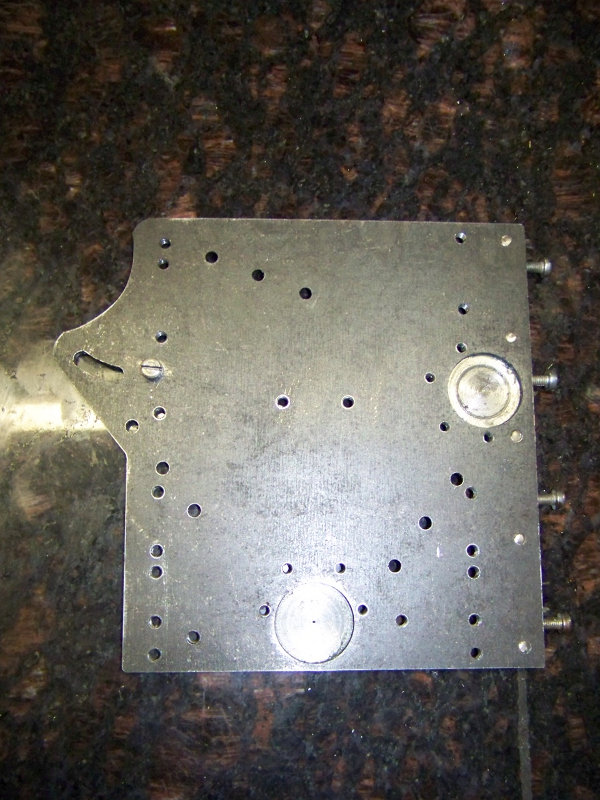

    Sanding head slide plate showing bolted together construction:
    3 inch thickness sander-ts07_-slideplate.jpg 3 inch thickness sander-ts08_onbench.jpg
    3 inch thickness sander-ts_onstand.jpg 3 inch thickness sander-ts09_-drawing.png

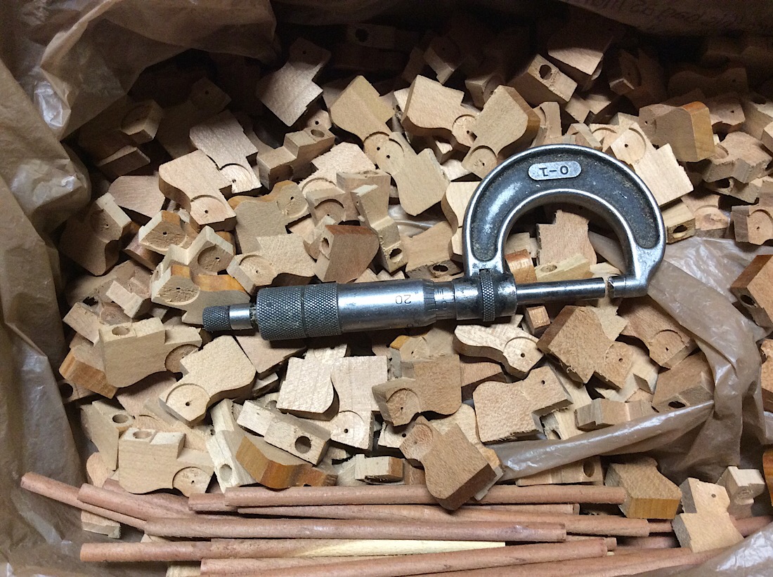

    That’s something I struggle with, but keep in mind how small it is!
    The first designs I looked at for reference were bigger home built ones like guitar builders use - there are many great plans for working with relatively long pieces, ranging from belt machines like Horwitz and Rancourt’s in Fine Woodworking 23, or drum machines like Beserkleyboy’s, to hand fed ones using a lathe or something simpler to support the sander, like this or this, or like Michael Paley’s recent submission here.
    Here’s an example toward the smaller end of the size of things I run through it, though. I wanted something that was more consistent but not slower than just rubbing each piece on sandpaper by hand.

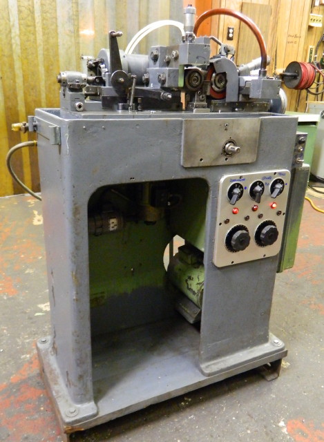

    Thanks! I sometimes need small, funny diameter wooden dowels and making them this way would be more efficient than abusing a turret lathe box tool like I do now. The cedar ones in the bottom of the picture above are a little smaller than 3/16.
    After I first looked into it and seeing how massive even the smallest centerless grinders were (like the Schaublin I grabbed this ebay picture of) I learned you can buy attachments for bigger belt sanders - I don’t think this is the one I saw but it looks similar and has a demonstration video:
    Products - Scantool
