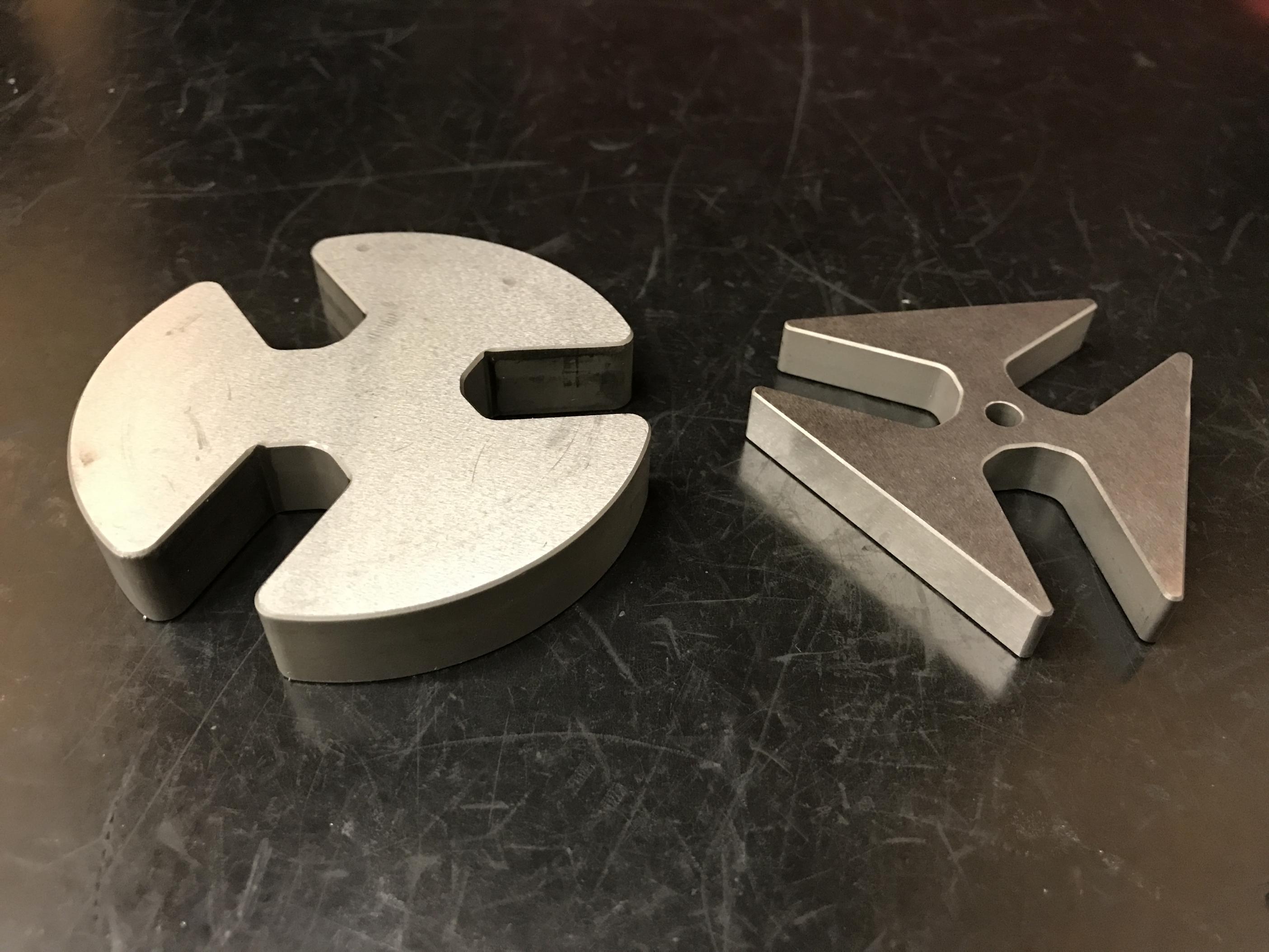

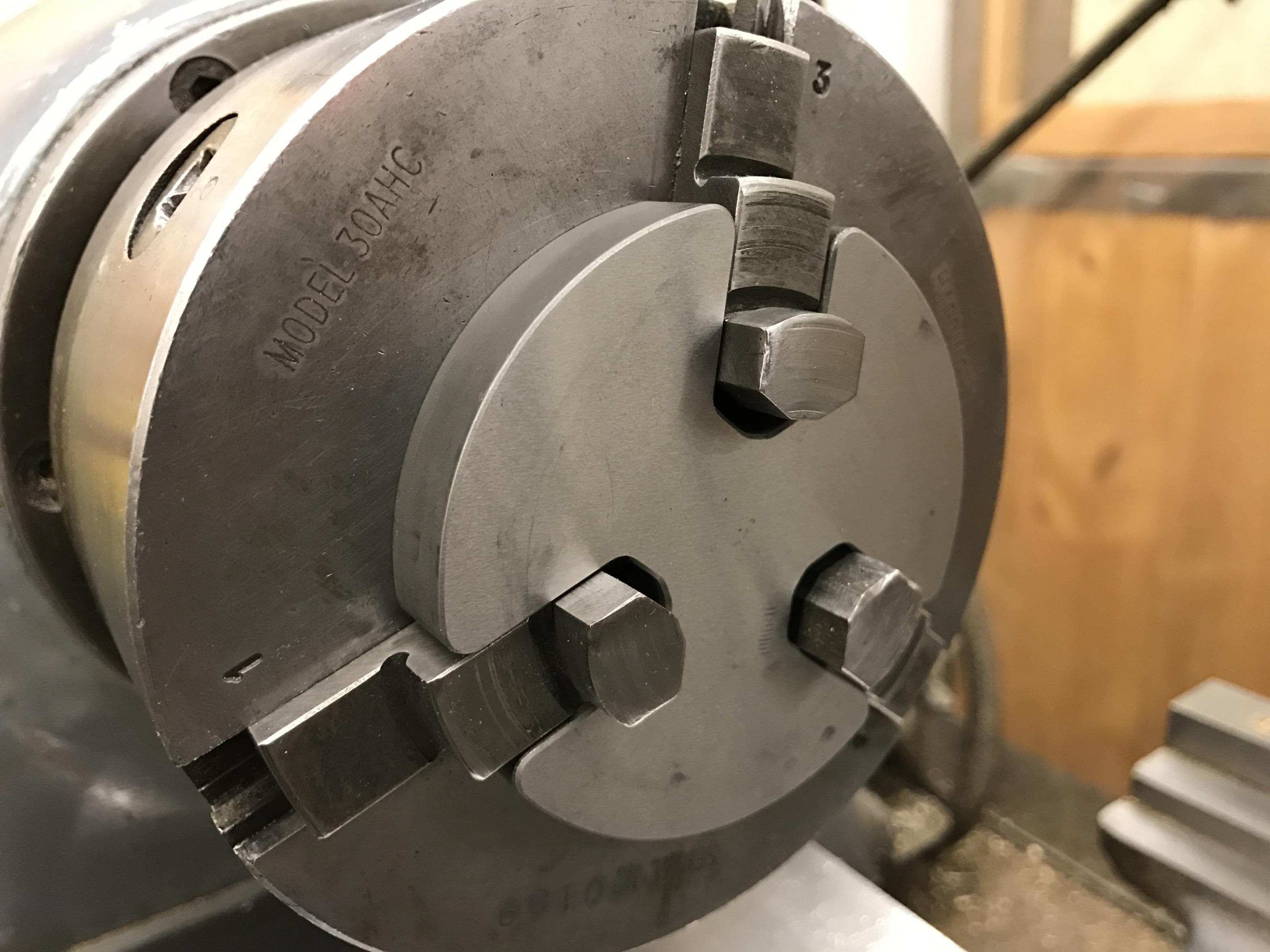

Here's a couple of spacers/parallels I made for the 3-jaw. Much more convenient than using 3 hands to hold a conventional parallel in place, and you can leave it in place while you turn. Only drawback is a limit to how small a diameter you can hold.
Attachment 16141
Attachment 16142
