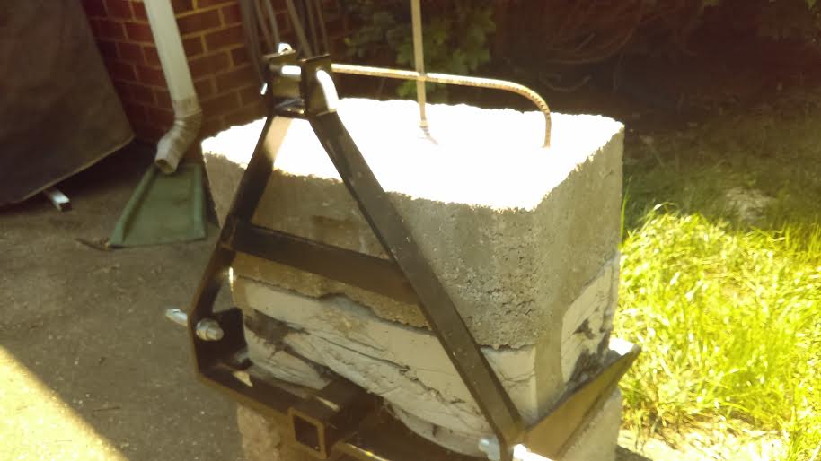

I am looking to build an adjustable weight ballast box using concrete layers that will drop over threaded rod. To do the job cheaply I need a platform that the blocks can rest on that will be connected to the 3 pth. Using a 3 pth trailer adapter as the lifting device, I need to support the weight of the block on the trailer adapter. I'd rather not hire a welder. Any ideas? Thanks.
Here is what I came up with. Bought a hitch frame from Ag supply and turned it around ,had welder add support and base then added my concrete formed blocks.
Attachment 12520
