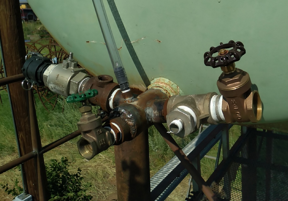

    This is the main connection point for pumping water into the tank drawing water out of the tank and circulating the water from this end to the other end through the filtration system yet to be installed
    There is a 1 1/2" pipe connected to the gate valve that is sticking straight out which reaches the opposite end on the inside of the tank
