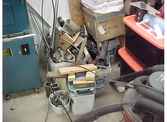

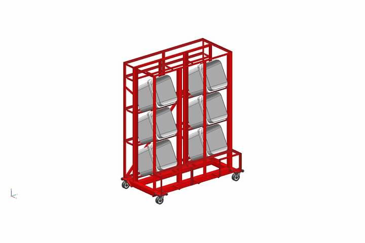

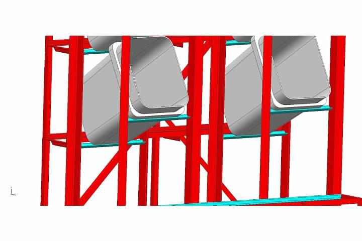

I have gone out in the shop a half dozen times to clean up my drop pile but, once I get out there and look at all of it, I stop. I have no where to put it that is easily accessible and orderly so I was getting a little frustrated...

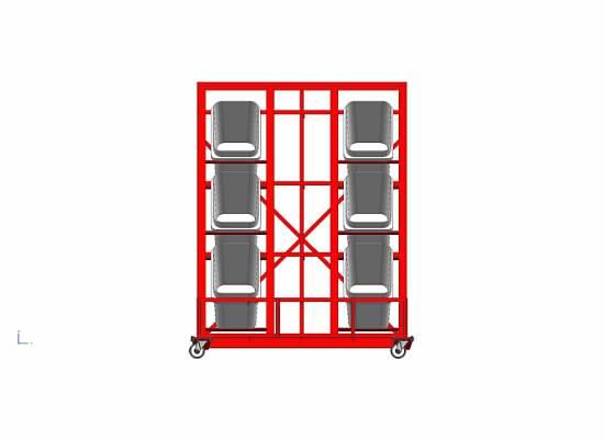

I got to thinking about all of the buckets (8 of them!) I am using right now as containers and decided to design a mobile rack to use those buckets.
I measured up a couple of buckets (I have a few different sizes) and modeled up an average size in UG. I had an idea already in my head so I ran with it on the computer. Once the bucket was modeled the rest was easy.
This is a side view. The rack is 24 inches wide.
http://im1.shutterfly.com/media/47a4...D550/ry%3D400/
Here is a front view. It is 42 inches long and about 48 inches high. Six buckets fit comfortably with room for three more in the middle if I decide to go that way. Right now I am thinking I will make this middle bay a vertical rack for longer drops.

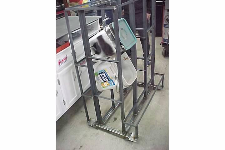

The buckets set in, and on, 3/4 x 3/4 angle at about a 30deg tip.
http://im1.shutterfly.com/media/47a4...D720/ry%3D480/

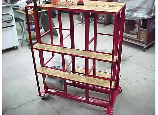

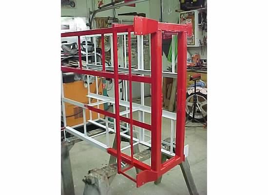

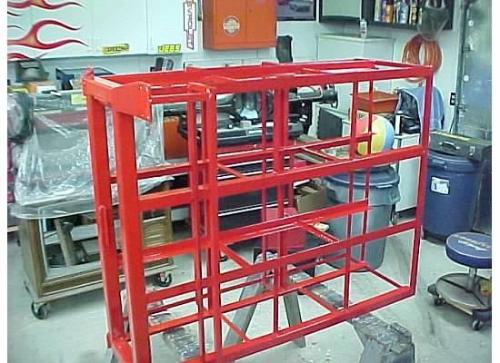

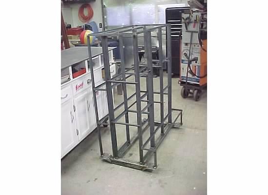

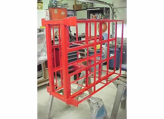

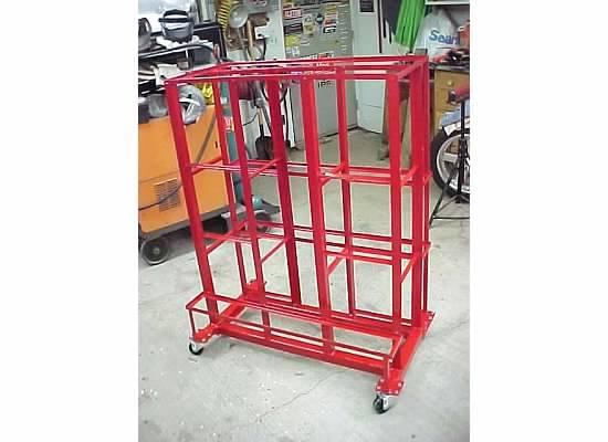

You can see I am also building in a lot of narrow racks for long lengths, whether sheet metal or tubing, Should work very well. I plan to put steel on the bottom and aluminum higher up.

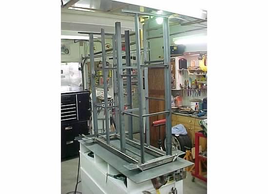

I did the details last Monday night to build my stock list and ordered the steel Tuesday afternoon. It was in Wednesday so I picked it up and had in the shop by 5.
