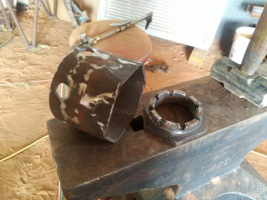

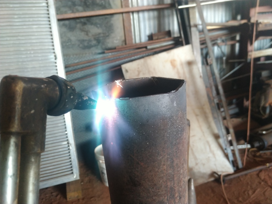

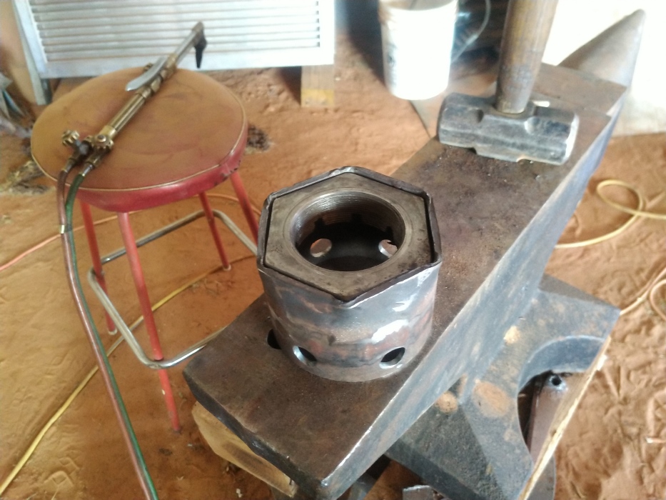

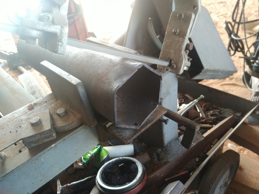

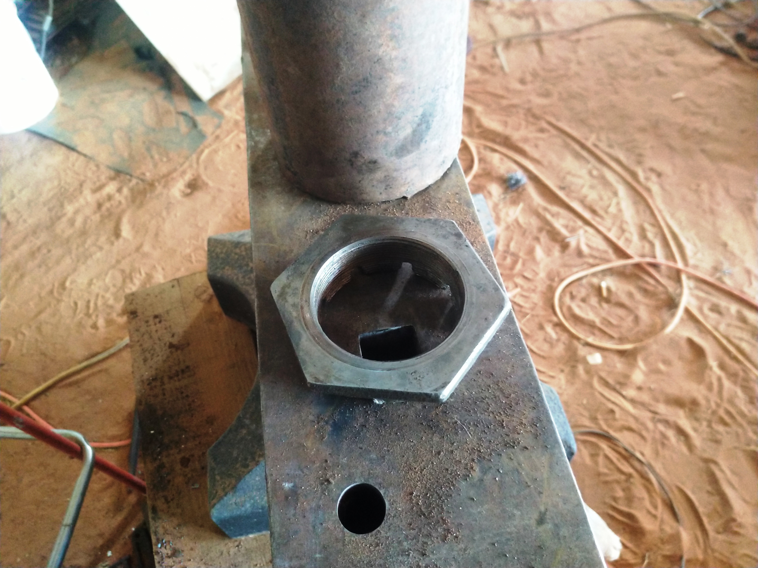

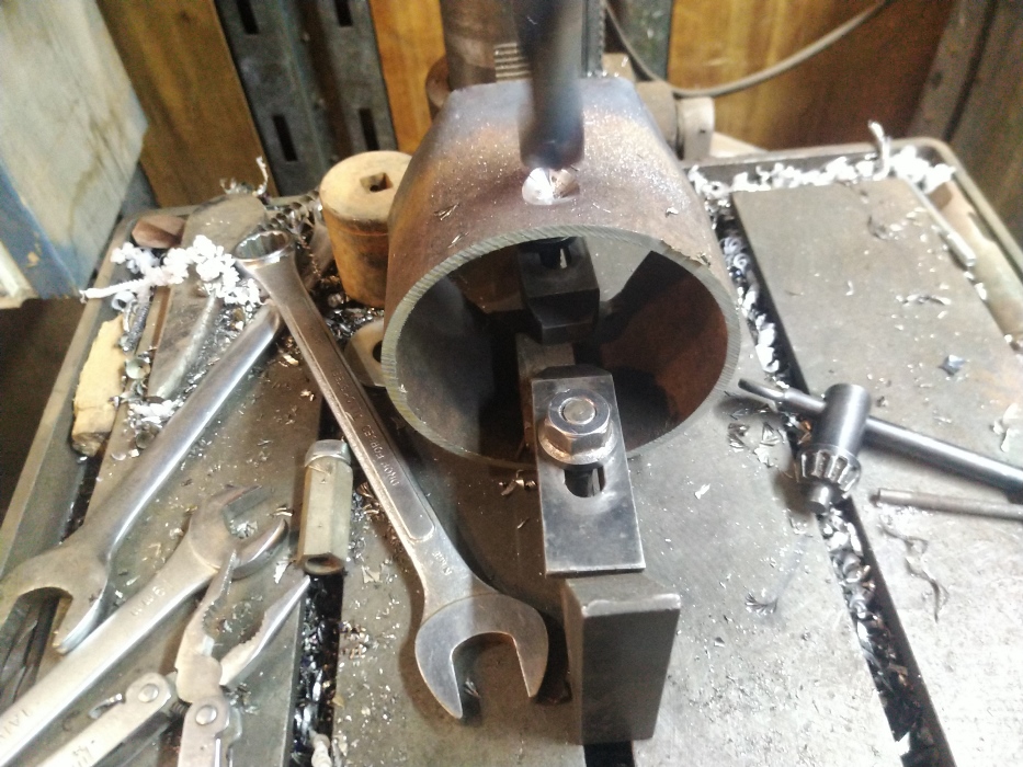

    I have already made several hub nut sockets in the past but I didn't have one that fit my forklift. While I might remove the nut by whatever means I have available, when re installing I'm going to make a socket if I don't have one that fits.
    This one was one of the simplest to make I used a piece of 5 inch well casing pipe. Hex shaped one end on my anvil then cut it to length and drilled cross holes to use a bar for turning it
