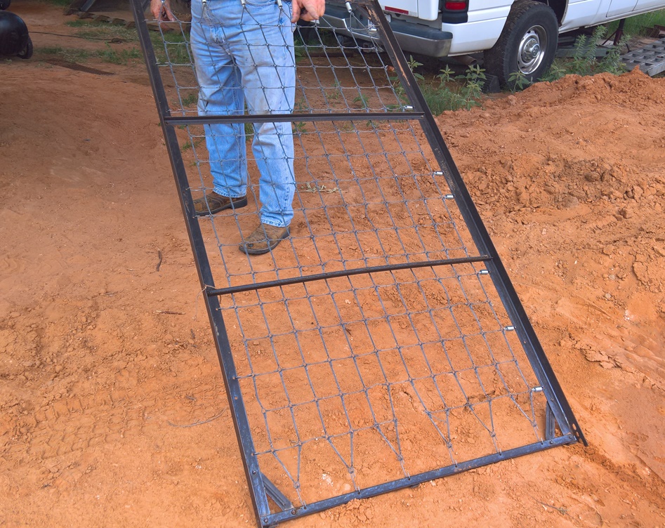

I started out with an old bed frame for the materials to make the hold down out of
Attachment 34996

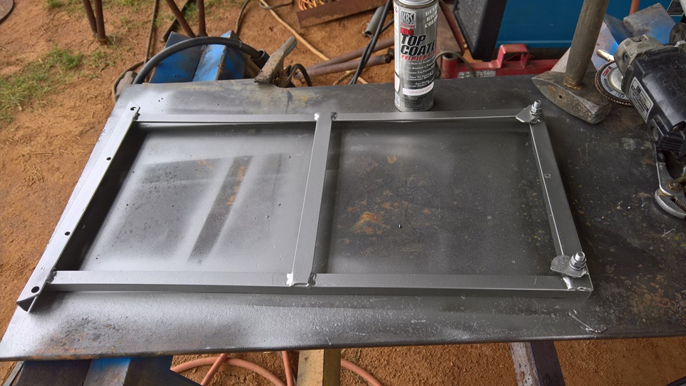

This is what I came up with then painted it with KBS stainless steel top coat spray paint
Attachment 34997

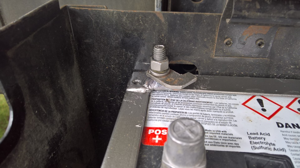

the rear lock downs open
Attachment 34998

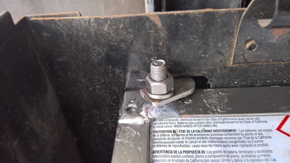

and closed
Attachment 34999

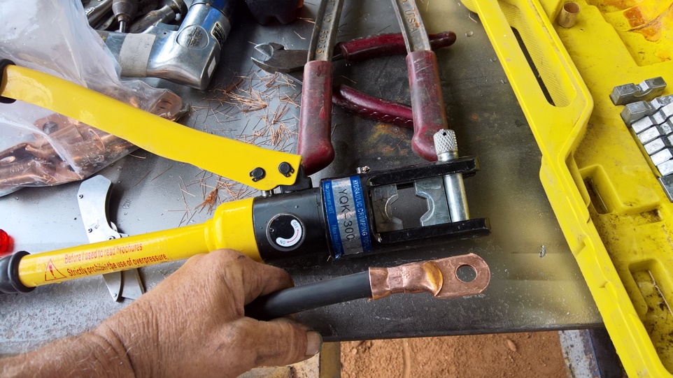

having the right tools to makeup cables is a must for me
Attachment 35000

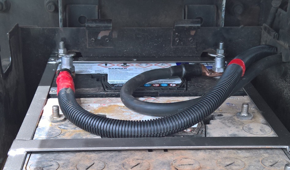

then protecting them from arcing/ wear and sealing out moisture with shrink tubing insures long life
Attachment 35001
