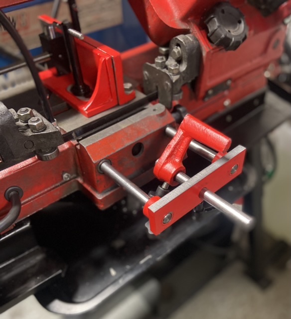

Hi All

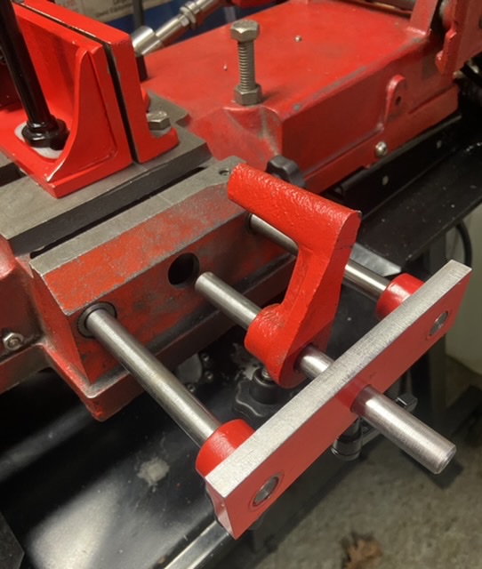

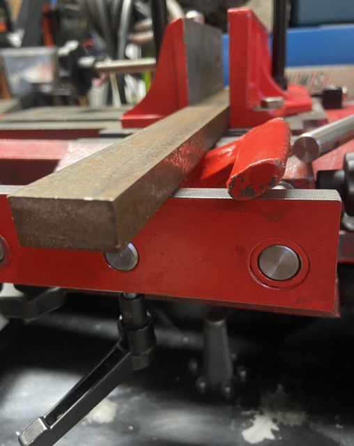

One of the issues with the saw is the support of the stock being cut. Once cut it falls off and hits the ground. With the coolant tray also being fitted beneath the drop zone, I didn’t want heavy material dropping onto it and damaging the sheet metal tray.
So my solution was to make an adjustable outrigger and incorporate the machine stop. The outrigger in conjunction with a roller stand will prevent longer stock from falling off the saw.
Attachment 41881

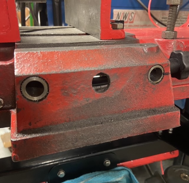

Steel bushes in cast base to strengthen the casting.
Attachment 41882 Attachment 41883 Attachment 41884

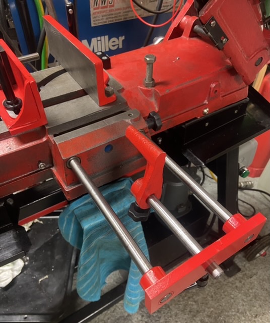

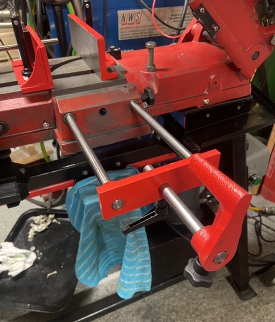

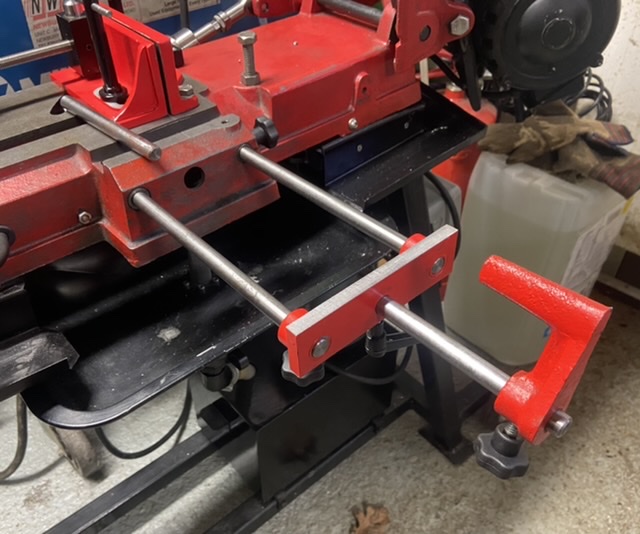

Outrigger in place
Attachment 41885 Attachment 41886 Attachment 41887 Attachment 41888

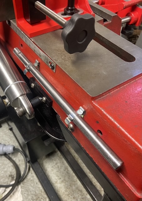

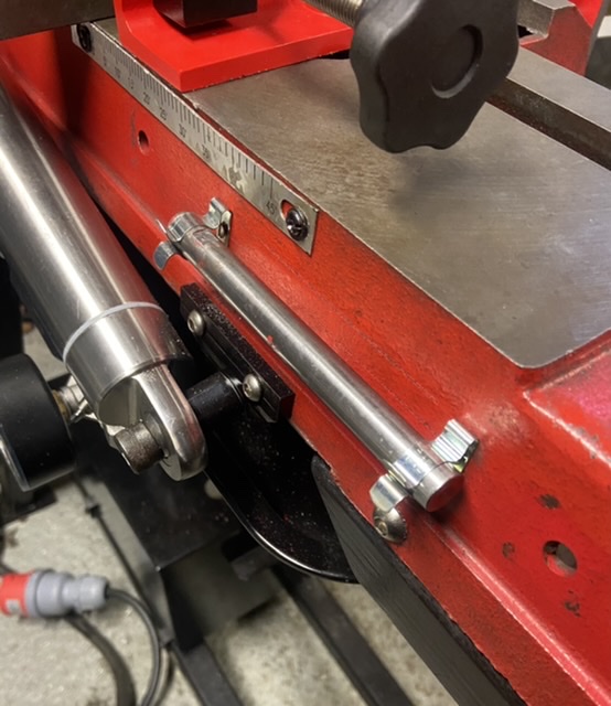

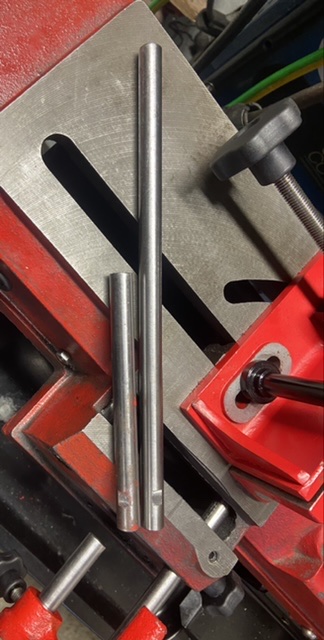

Two lengths of bar which are interchangeable to increase the length of the outrigger. So I don’t lose it or cut it up for a job, either one when not in use is stored on side of saw with terry clips.
Attachment 41889 Attachment 41890

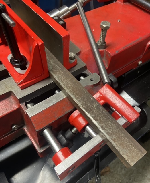

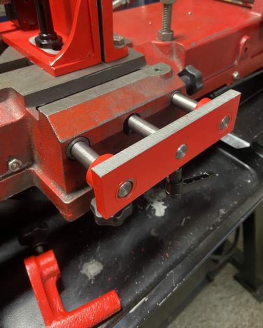

Stop can be folded out of the way when not required.
Attachment 41892 Attachment 41893
The stop can be used for short stock and placed the other side of the outrigger for longer stock
Attachment 41894

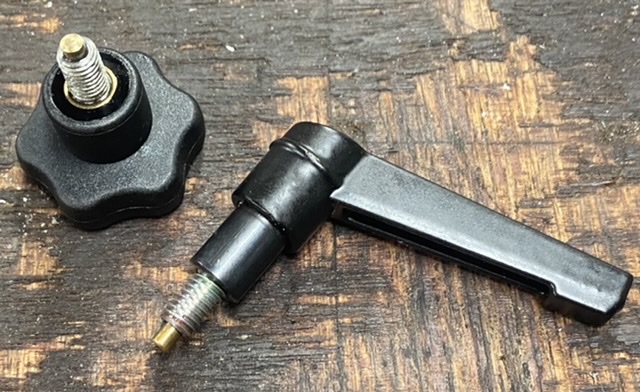

Clamp screws.
