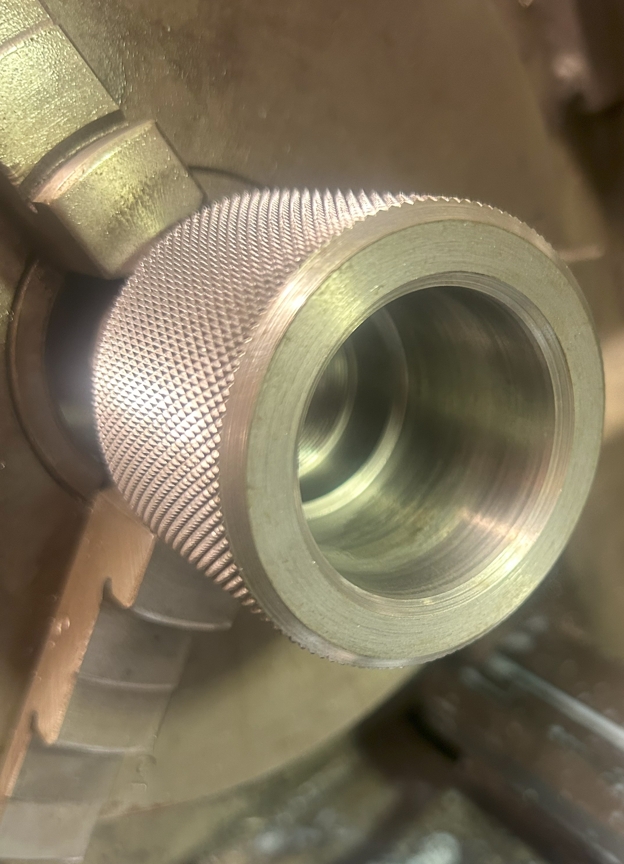

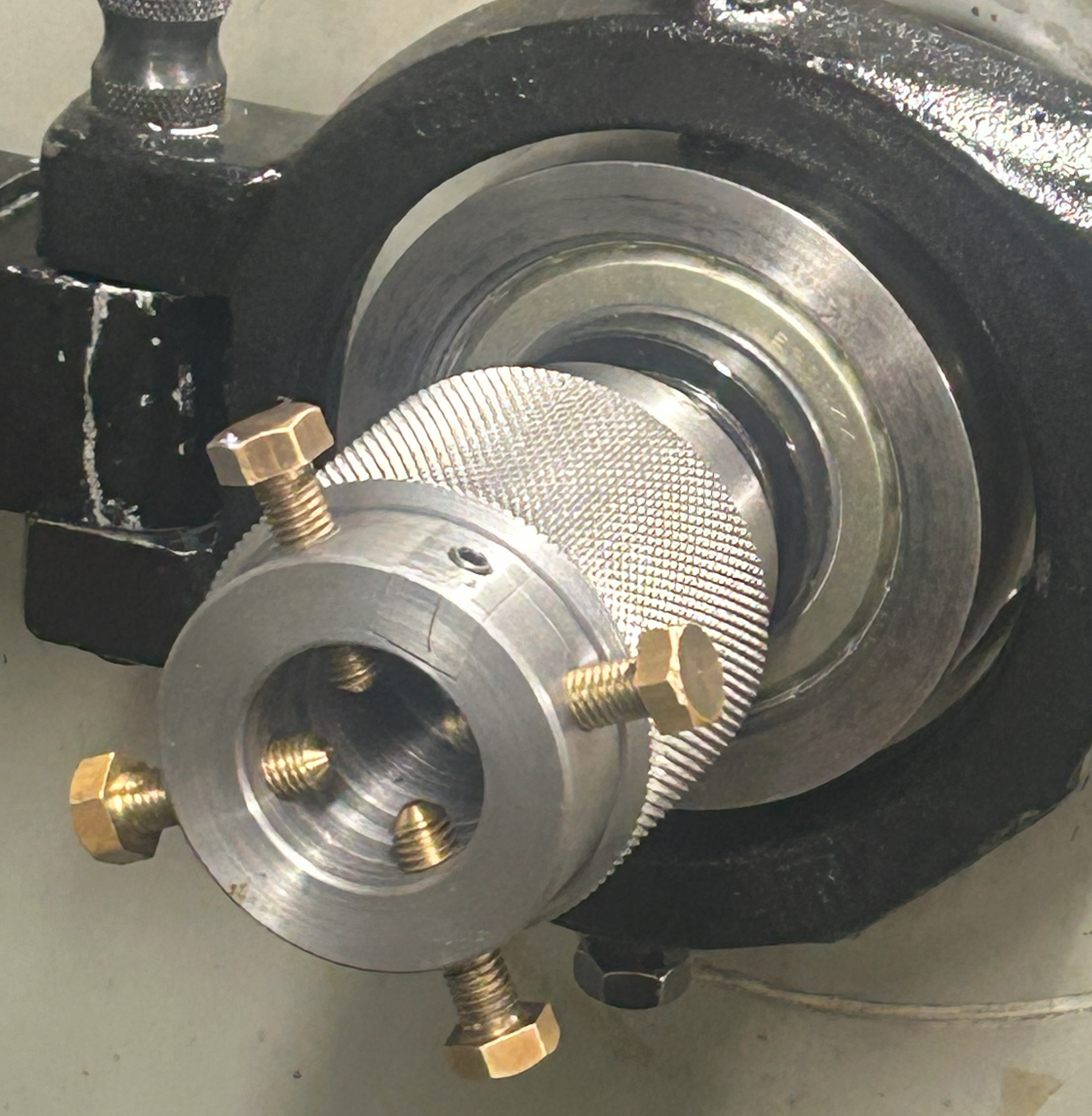

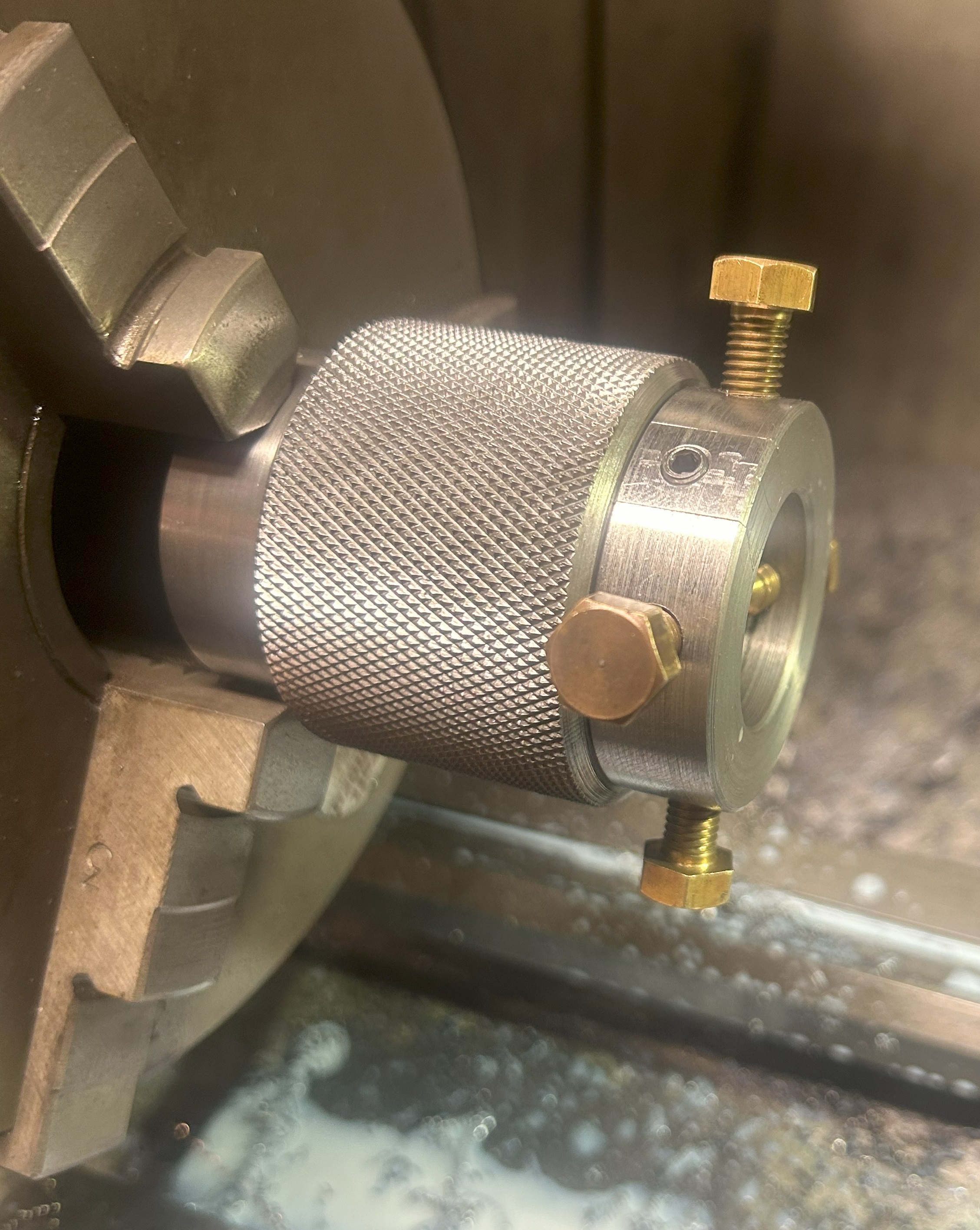

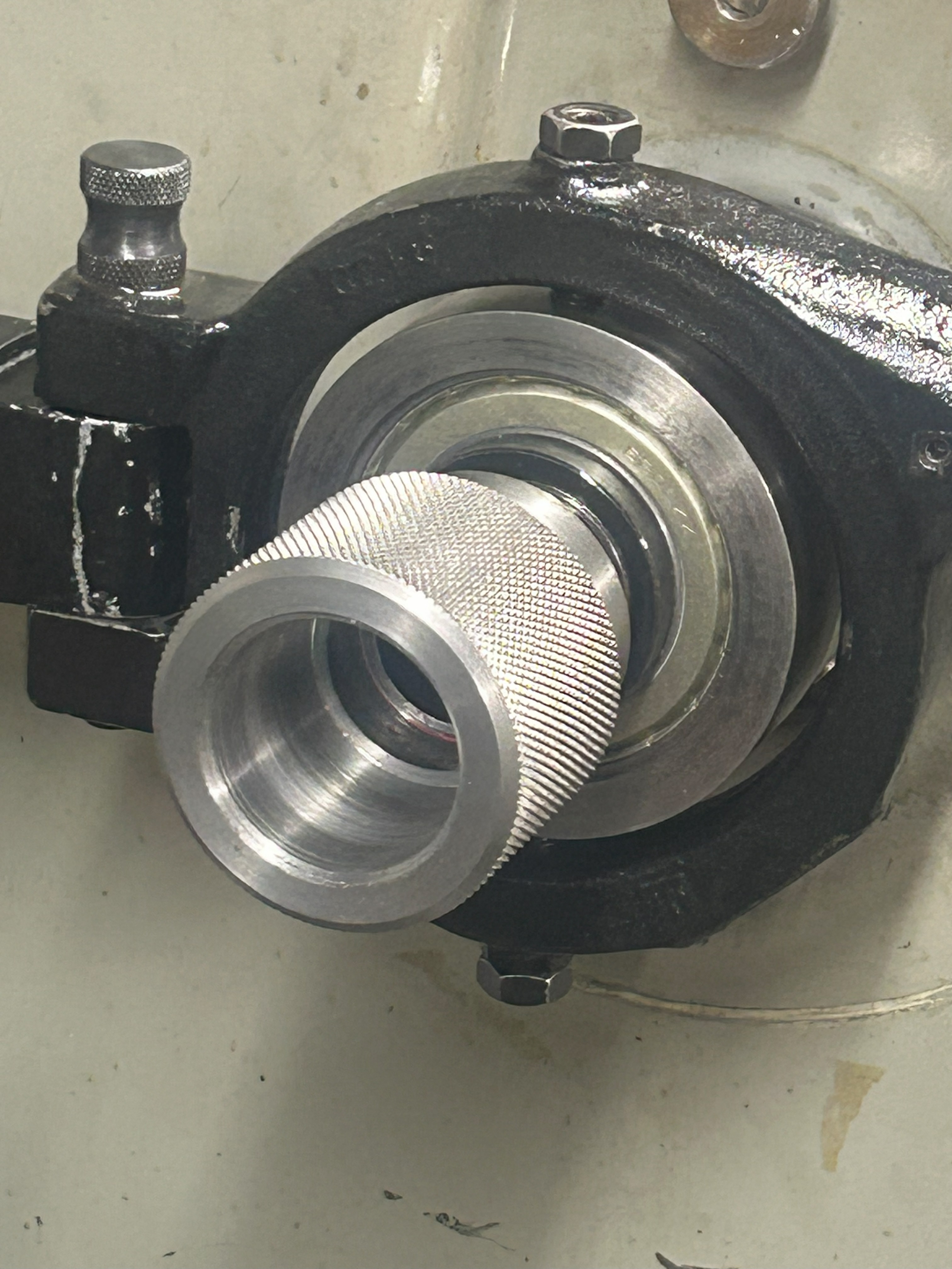

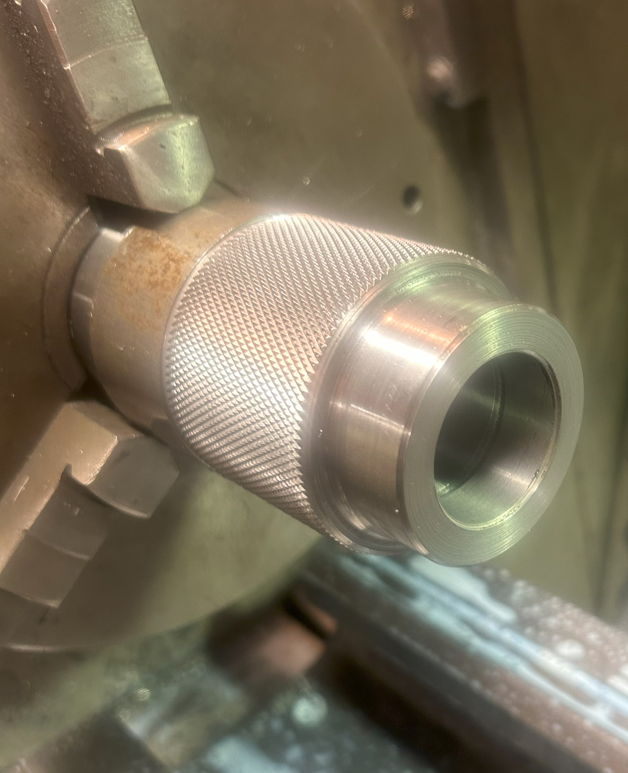

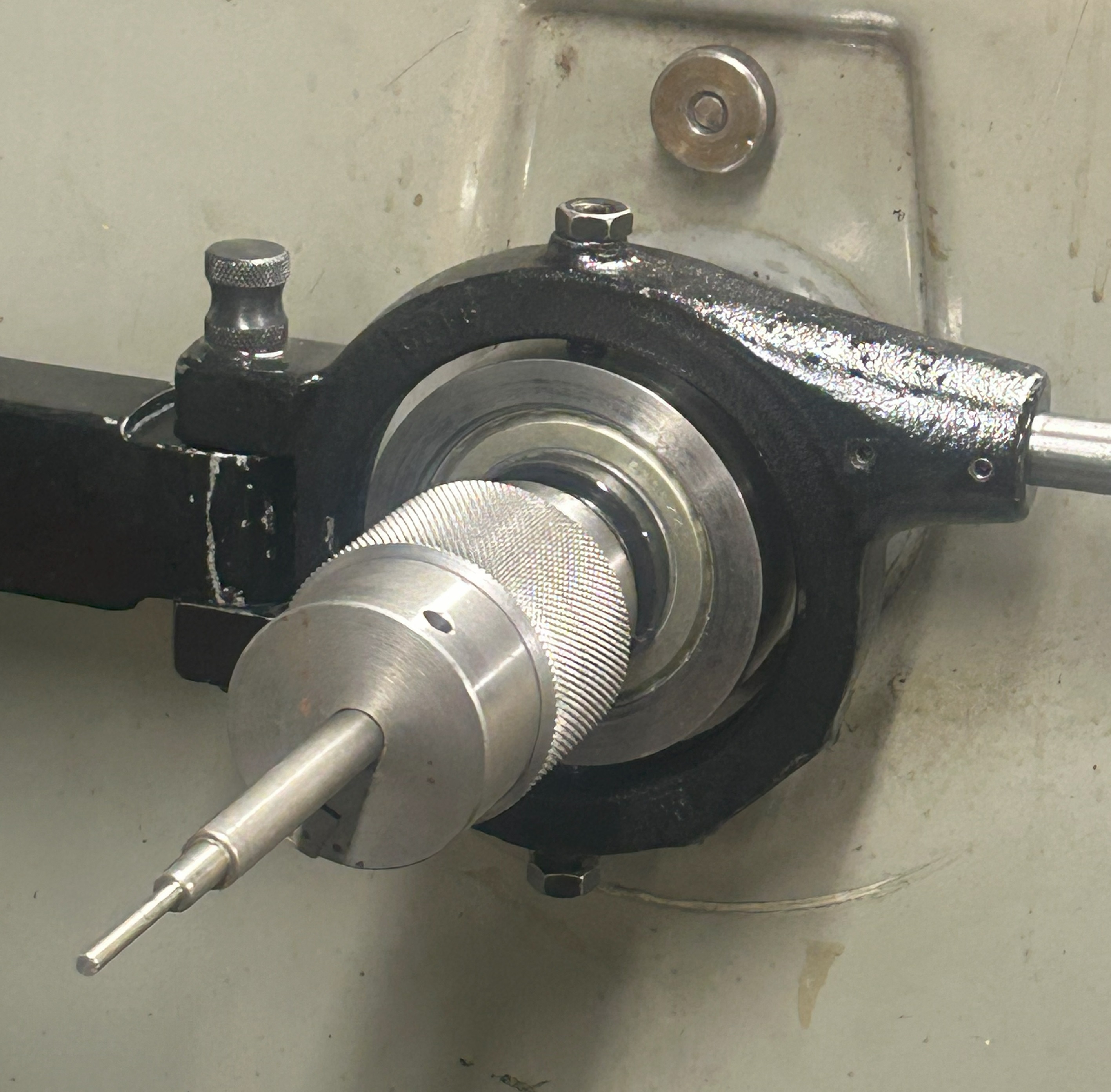

To use the existing backstop I decided to make a new rear locking nut/handle. This not only will accept the backstop or spider but also make it easier to draw the collets into the drawtube. The backstop and spider I made normally locks into the headstock spindle so the new nut needed to have the same diameter bore as the headstock spindle to accept them.
Links to both the spider and backstop:
https://www.homemadetools.net/forum/lathe-spider-93564
https://www.homemadetools.net/forum/...ack-stop-66400
The following photos show the modification:
Attachment 47093Knurled handwheel, screw cut to fit drawbar tube
Attachment 47094Bored to headstock spindle internal diameter.
Attachment 47095Using spider as a gauge
Attachment 470965C collet closer located in headstock with bore to accept backstop or spider

Attachment 47098Backstop loaded in place.
The Knurled handle makes it a lot easier to draw the collets and set to the correct pressure to hold the desired workpiece diameter.
