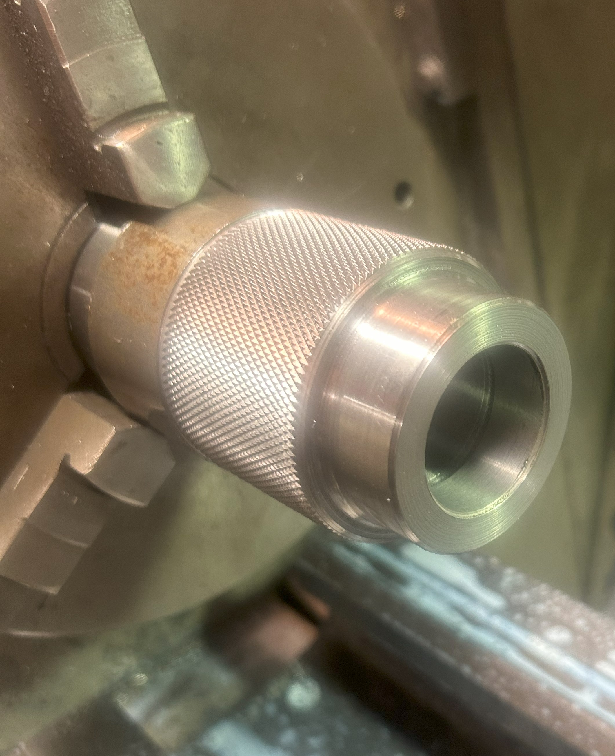

    While doing the repairs I was looking at backstops, but wasn't over keen on using the threaded type that fits into the internal thread on the collet. For three reasons.
    Firstly not all of my collets have the internal thread
    Secondly the screw in collet backstop have to be preset before drawing the collet in to the assembly and to adjust the length the collet therefore needs to be removed.
    Thirdly several length tubes are needed to cater for different length workpieces.
    So why reinvent the wheel when I already have a backstop that works really well and is easy to use?

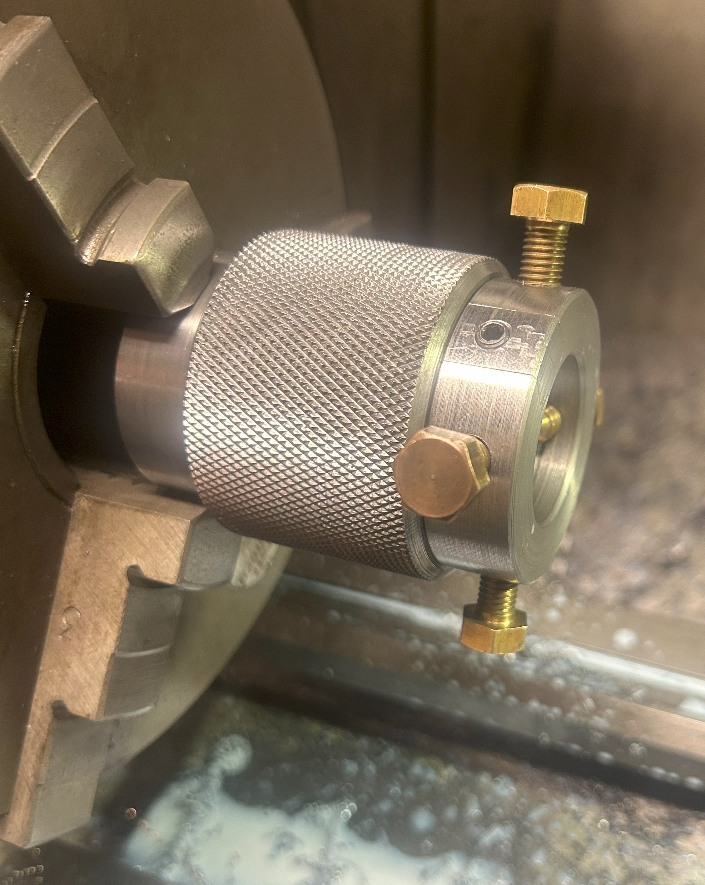

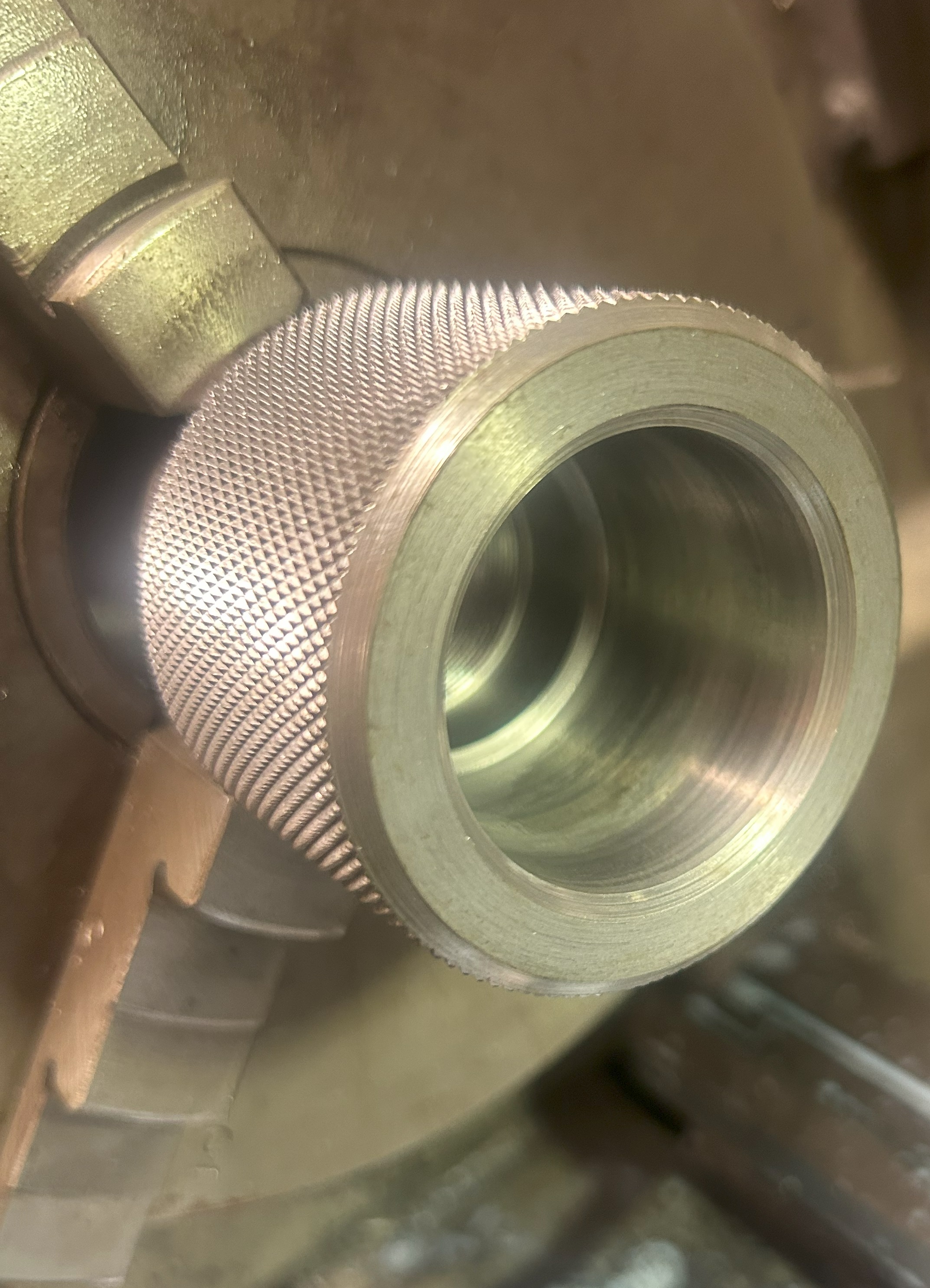

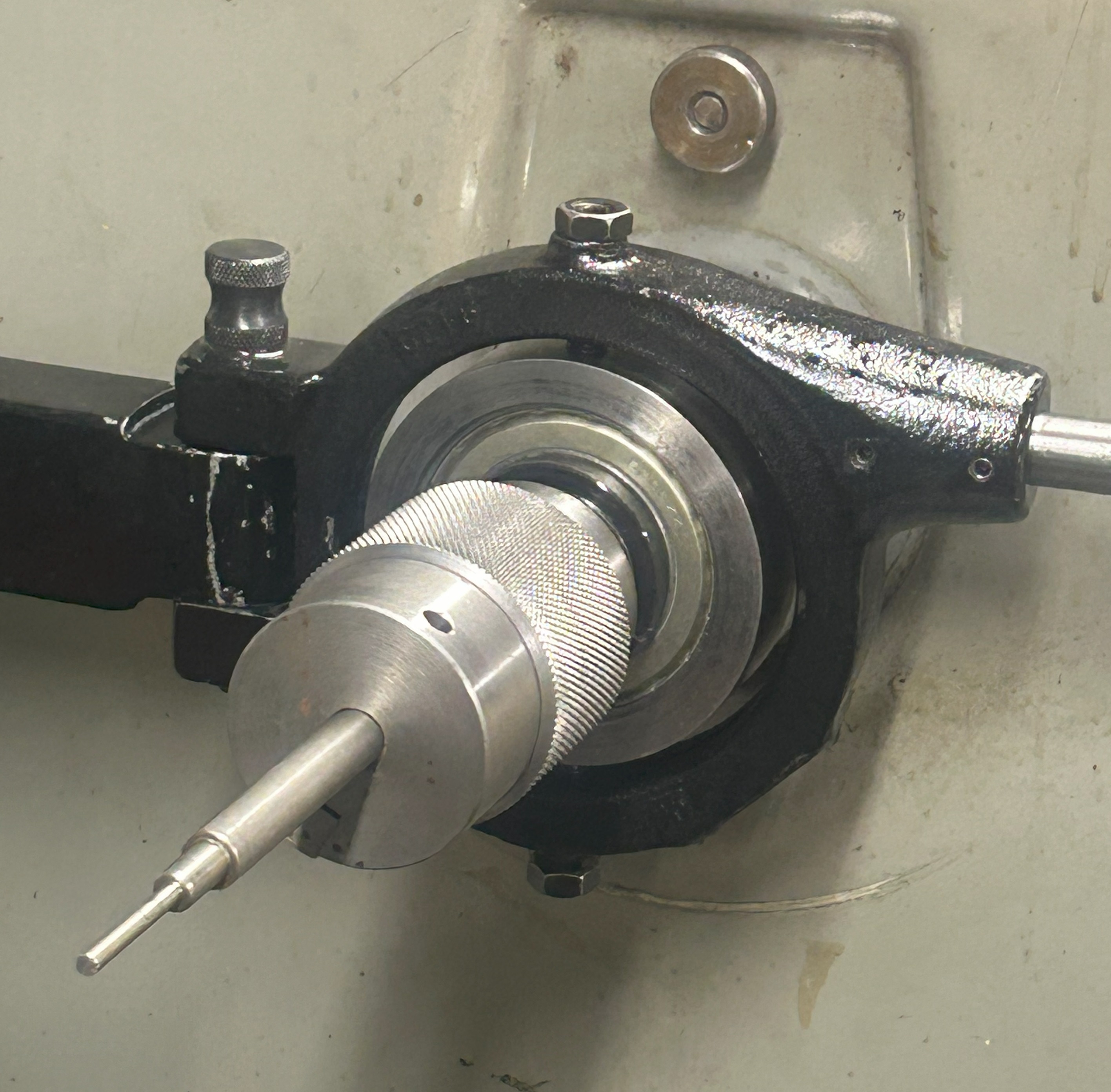

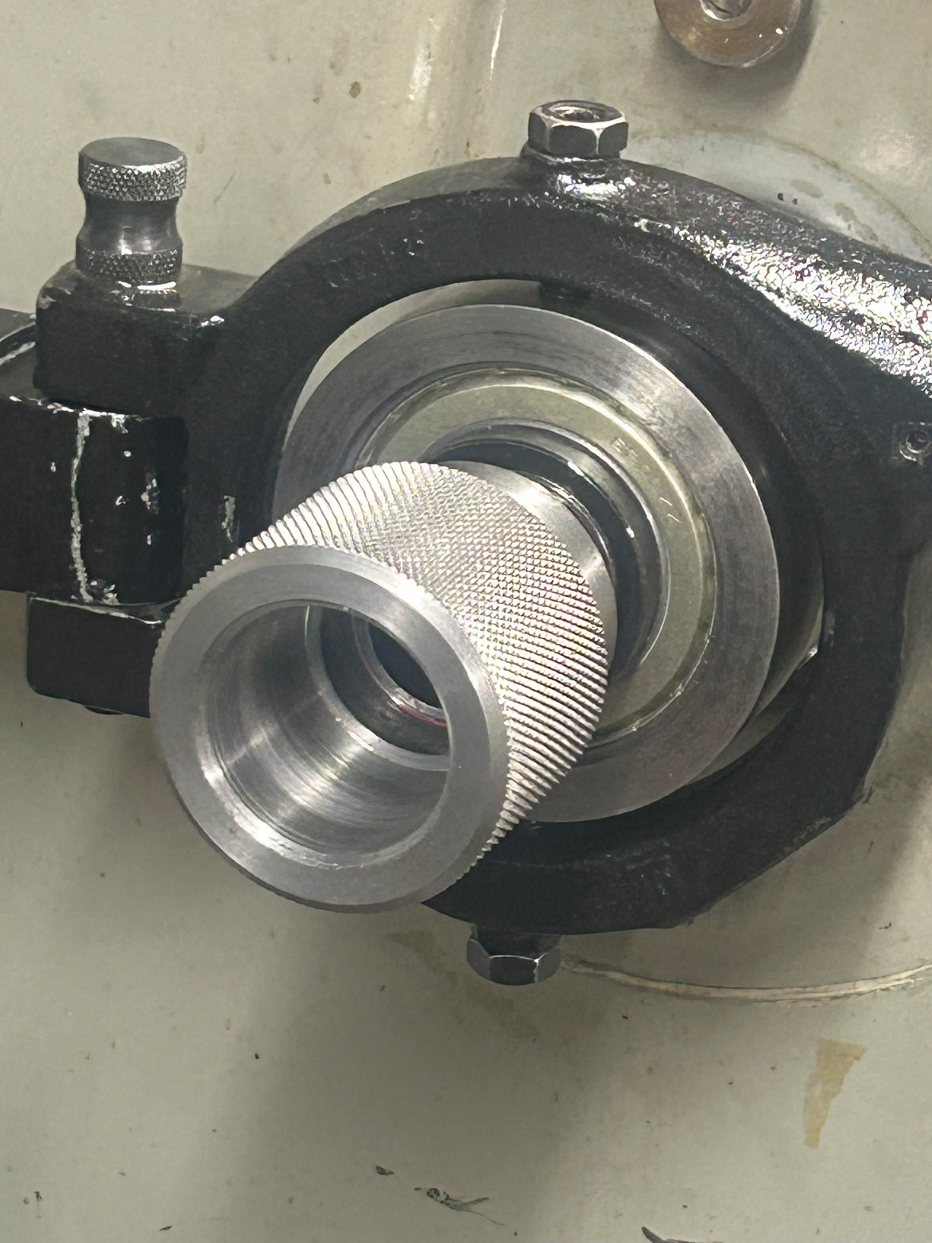

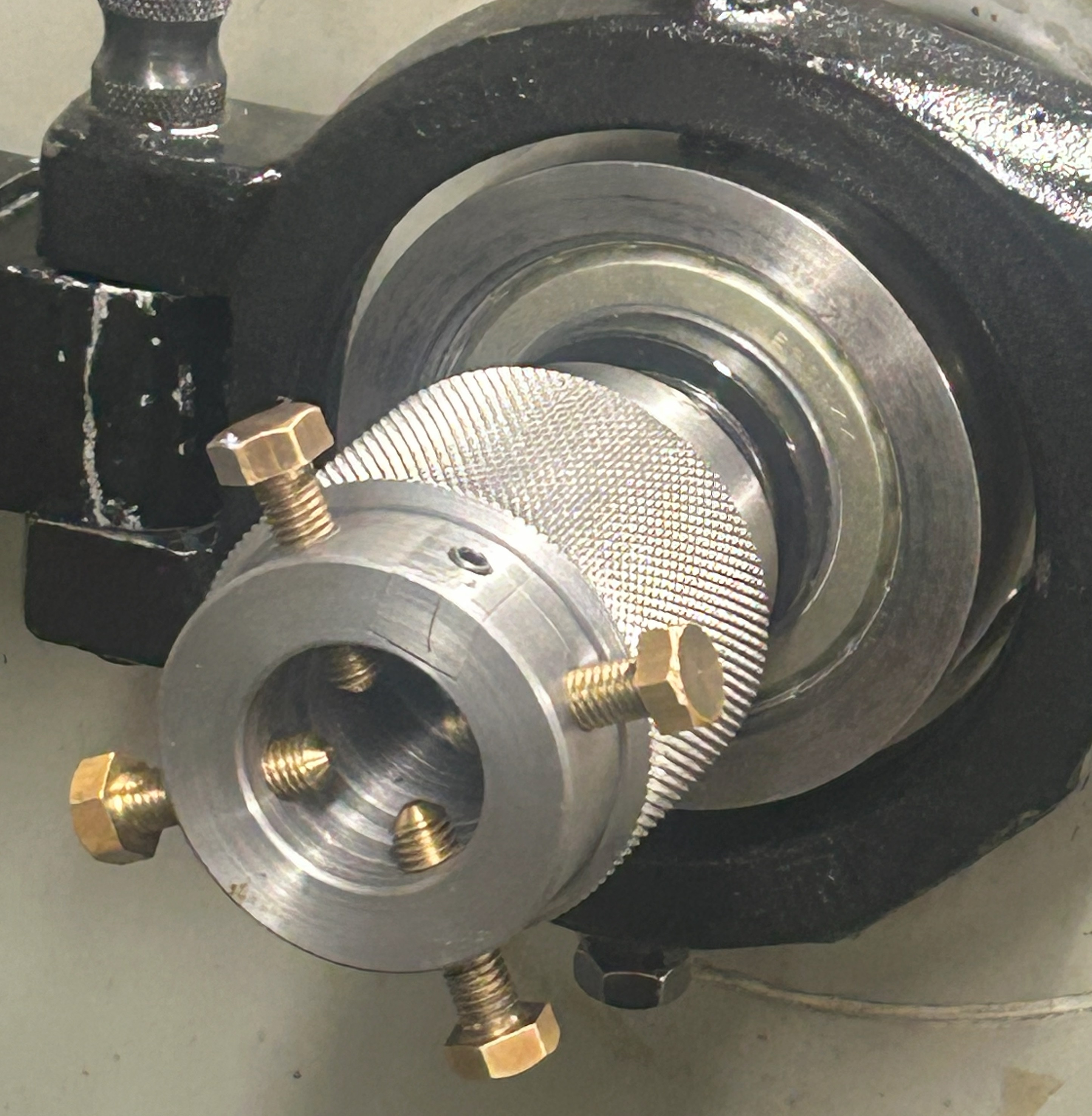

    To use the existing backstop I decided to make a new rear locking nut/handle. This not only will accept the backstop or spider but also make it easier to draw the collets into the drawtube. The backstop and spider I made normally locks into the headstock spindle so the new nut needed to have the same diameter bore as the headstock spindle to accept them.

    5C lever operated collet closer, backstop-hand-wheel.jpgKnurled handwheel, screw cut to fit drawbar tube
    5C lever operated collet closer, backstop-bored-had-wheel.jpgBored to headstock spindle internal diameter.
    5C lever operated collet closer, backstop-spider.jpgUsing spider as a gauge
    5C lever operated collet closer, backstop-completed-closer.jpg5C collet closer located in headstock with bore to accept backstop or spider
    5C lever operated collet closer, backstop-spider-2.jpgSpider inserted to support long pieces of stock material
    5C lever operated collet closer, backstop-backstop.jpgBackstop loaded in place.
    The Knurled handle makes it a lot easier to draw the collets and set to the correct pressure to hold the desired workpiece diameter.
