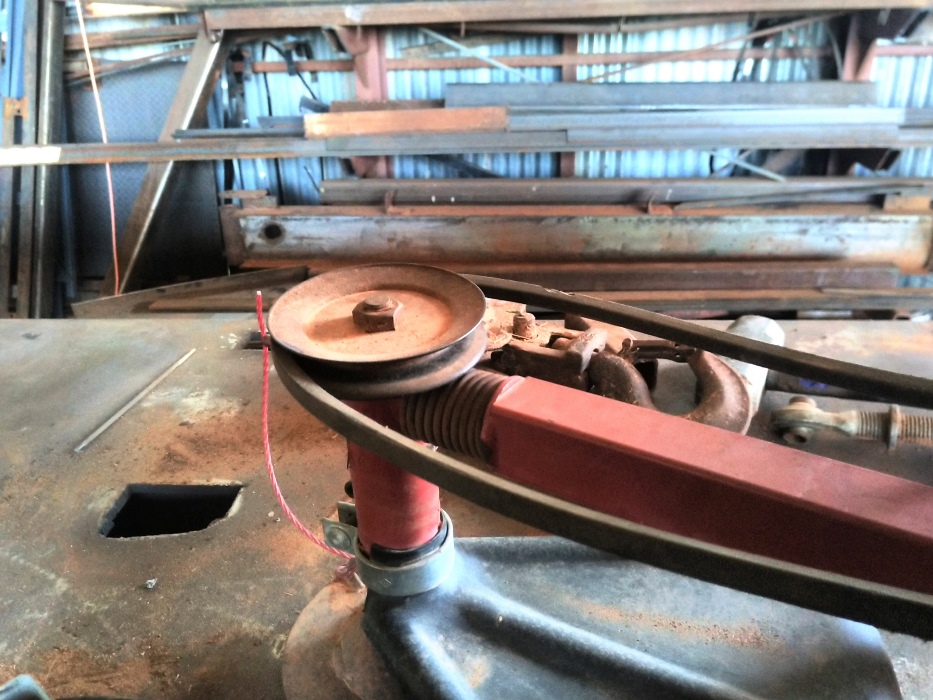

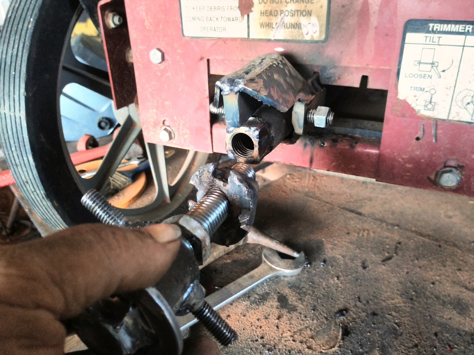

My Swisher 6 Hp string trimmer brush cutter Has always been a royal pain to try and start because the belt drive added a lot of resistance to the pull rope. I solved this once and for all by adding a clutch which loosens the belt here is how I did it
Attachment 45767
Attachment 45768

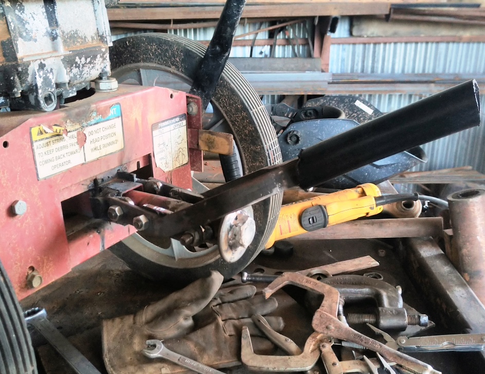

This is how it looks when the clutch leaver is pulled down

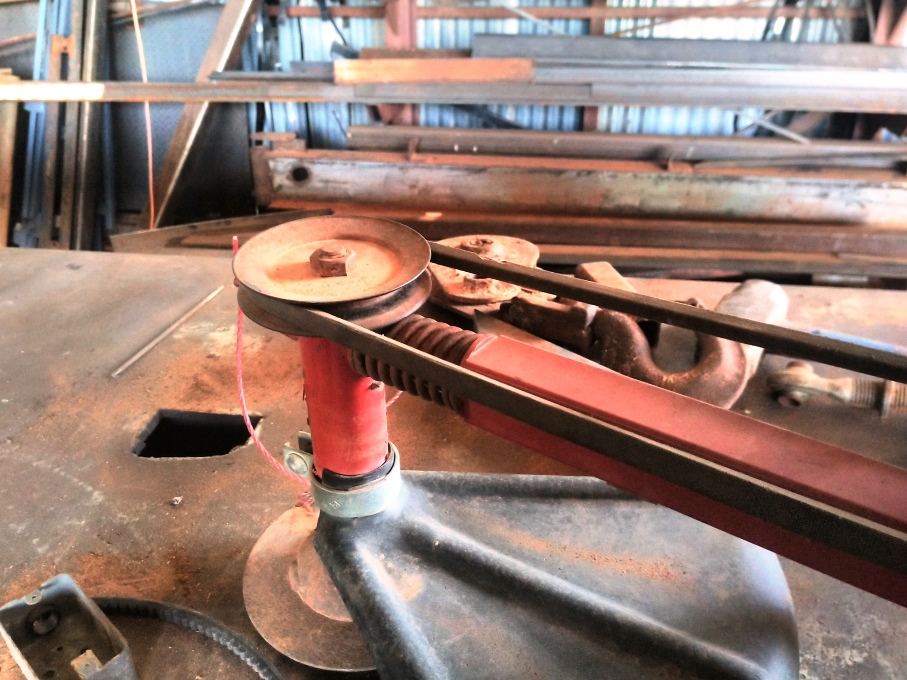

Attachment 45769

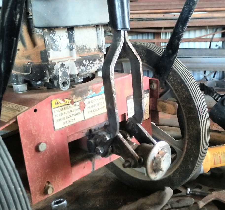

Now in the released or run position
Attachment 45770
Attachment 45771

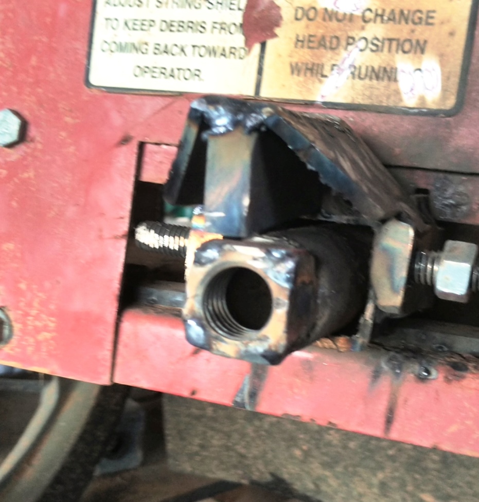

I welded a nut to the end of the stem then made it square,
Attachment 45772

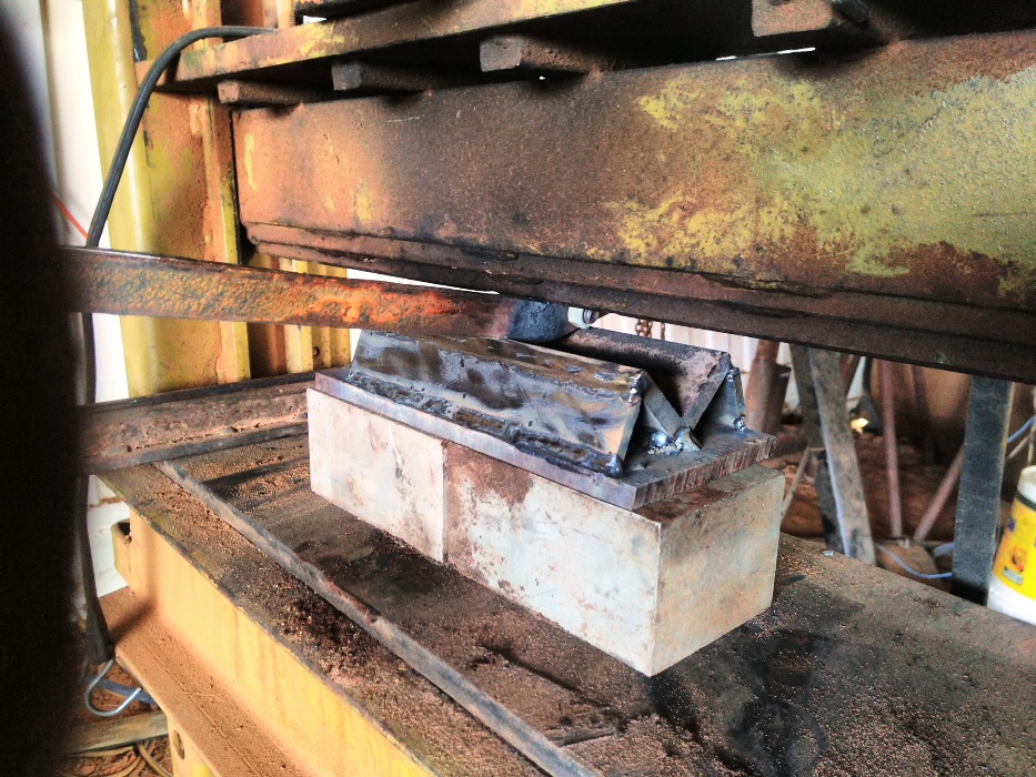

Then made a 3 position cap to go over the nut the 3/4" bolt makes the clutch adjustable
Attachment 45773
