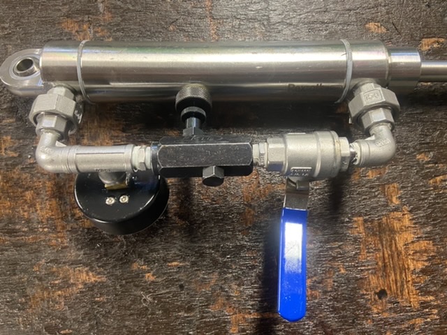

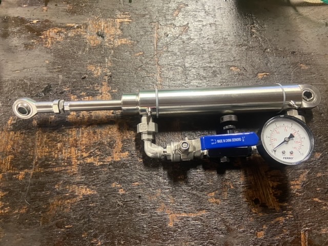

The needle valve is fitted with a check valve, so the saw frame can be lifted with the needle remaining set at the required pressure feed rate. The 1/4 turn ball valve can then be used to close the oil flow. This allows the frame to be lifted and not travel down at the set needle valve rate. This is important for setting the stock material in the correct position in the vice for cutting.

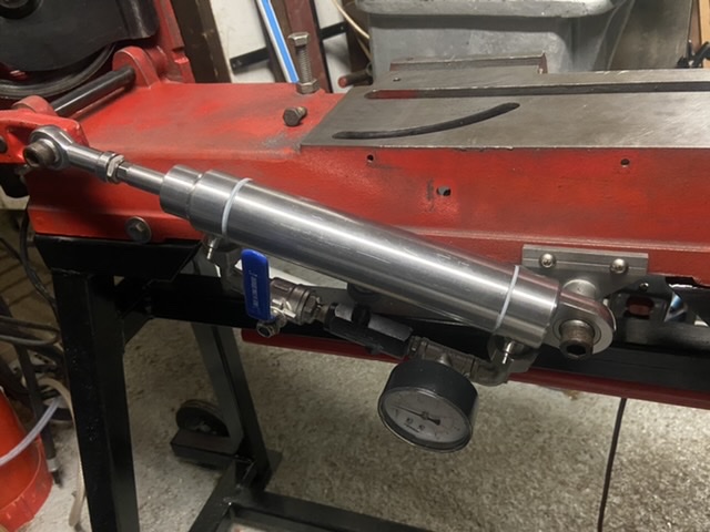

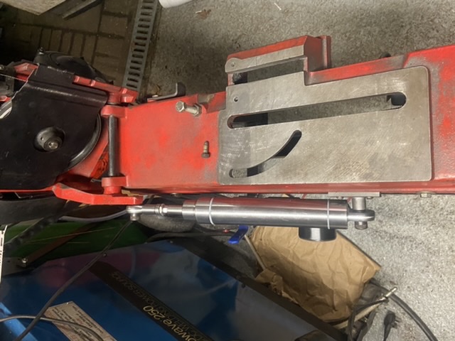

The cylinder is set so the main body of the ram/ cylinder is below the stock material to try and prevent swarf landing on the ram and damaging the seals.

The blue handle is the 1/4 turn ball valve next there is a needle valve/check valve and then the pressure gauge.
Attachment 41313

Attachment 41312
photo shows the complete assembly which I tried to keep as compact as possible.

Attachment 41314 Attachment 41315
