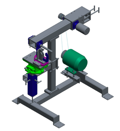

    Abrasive Tube Notcher Plans
    Abrasive Tube Notcher Plans for Sale - $15.00
    $15.00 - Click here to buy now via PayPal and download instantly
    30-day money-back guarantee.
    If you purchase these plans and are not 100% satisfied, we'll refund your purchase price.
    These plans include:
    • A 43-page PDF manual with:
    • 38 large technical drawings in color and black-and-white.
    • Bill of materials with costs.
    • Links to purchase exact parts online.
    Feel free to post any questions you may have in this discussion, either before you purchase or during construction. Or, post pictures of your finished abrasive tube notcher.
    You can view the finished version on my website, I've been using it so much I haven't had time to paint it yet!
    http://kustomsbykent.com/shopequipme...-tube-notcher/
    I also have video's of it in action:
    Ask any questions you might have, I'm happy to answer!

    Don't you use a lot of belts ? The cost of the belts can get out of line or no.
    There is a tool company that makes the notchers using hole saws, it is also nice and portable
    Supporting Member KustomsbyKent's Avatar
    Dec 2014
    South Dakota
    275
    2,840
    Thanked 231 Times in 133 Posts
    KustomsbyKent's Tools
    Hi G.Paul,
    So far I've only gone through a couple of belts. Because the belts are so long, there's a lot of abrasive area. Also, you shift it back and forth as you grind it away, so you spread the wear area out. If you drove it into the belt hard, then you'd blow out the belt.
    I don't like the hole saw tube notchers: they don't work well if you have to remove another 1/8" or change the angle slightly to get a better fit. I've used hole saws in the vertical mill, and while they work, I've never been impressed with their performance vs the abrasive tube notcher.
    Some guys will just use an angle grinder with a cut-off wheel and clean it up with a flapper disc and swear by it... I have done that too, and it works okay for small tubes, like 1" or smaller going onto larger tubes. But for the best fit-up, the abrasive tube notcher gives the best fit and best finish.

    Hi Kent,
    Just a suggestion for future modifications would be a locking swivel in the vice possibly like used on a lathe for accurate angles in the notches. otherwise it does seem very good design. if i can come up with a good bi-directional set up i will share it with you
