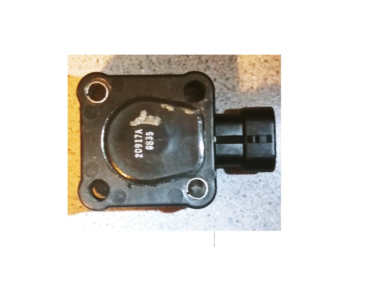

So, I removed assembly to analyze how to introduce contact cleaner to what is basically a drum switch.
Attachment 38843 Attachment 38844

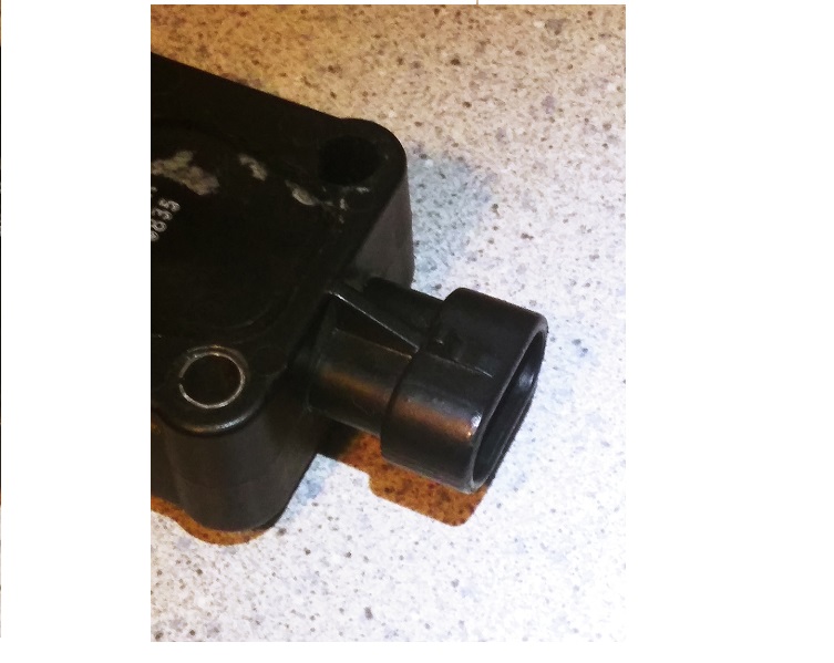

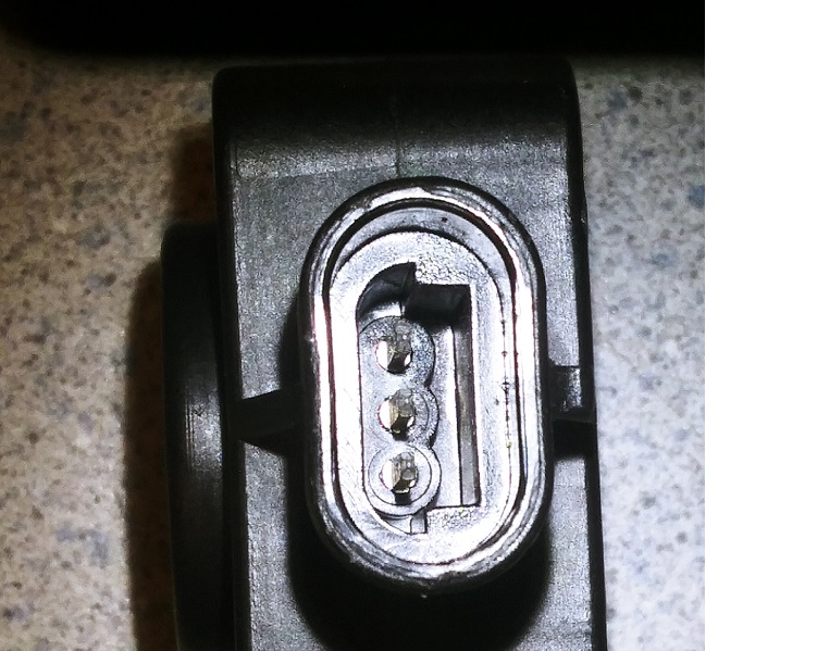

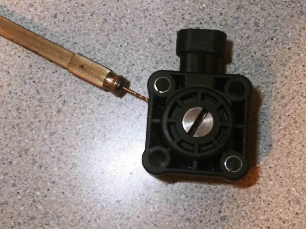

Pic 1 depicts drilling through outer wall at about 20°, clear of the cavity bottom, beyond 'standoffs' and through switch proper, and again from opposite diagonal position. Body thickness and logic say internally, there is a commutator not a rotor, and why deep position was chosen, about .12 up from switch face, the cavities not visible when assembled. Very easy test of rotation didn't reveal any interference with shank end of drill, of 1/16" diameter.

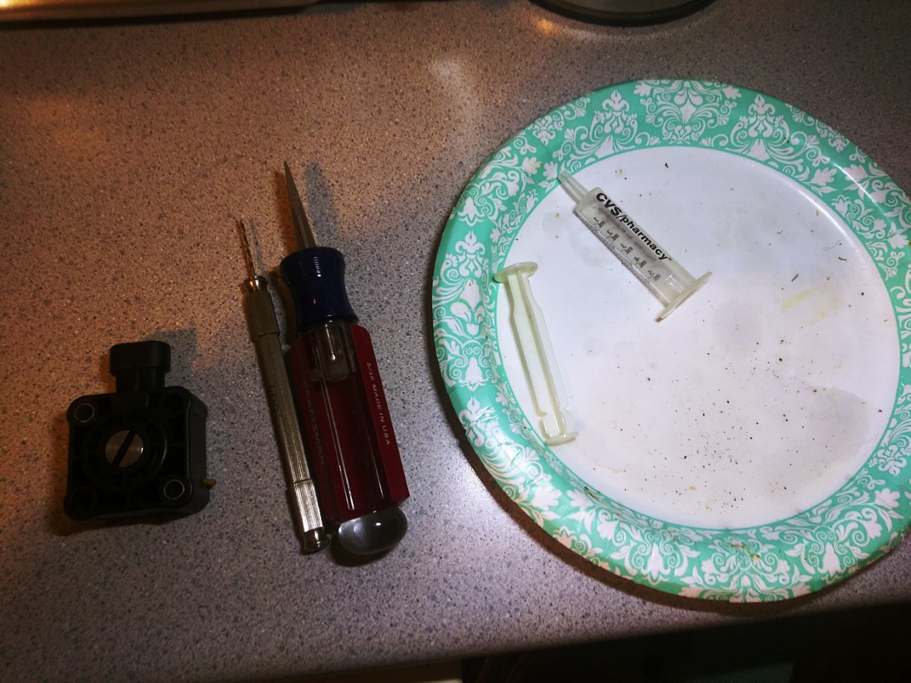

Pic 2 Then plugging outer holes with toothpicks, used syringe to fill one cavity while operating the barrel with 90% iso-alcohol, it drained out other side. Part way along, I hosed down the cavities to help reveal whether anything would flush from inside. That was seems inconclusive.
The switch is evaporating alcohol out now under an incandescent lamp.
