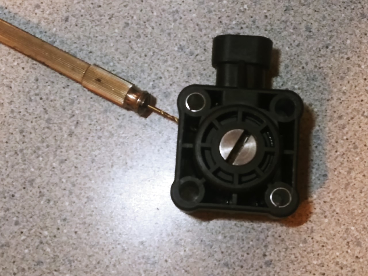

    So, I removed assembly to analyze how to introduce contact cleaner to what is basically a drum switch.
    Accelerator sending unit remedy......maybe.-orifice.jpg Accelerator sending unit remedy......maybe.-flush.jpg

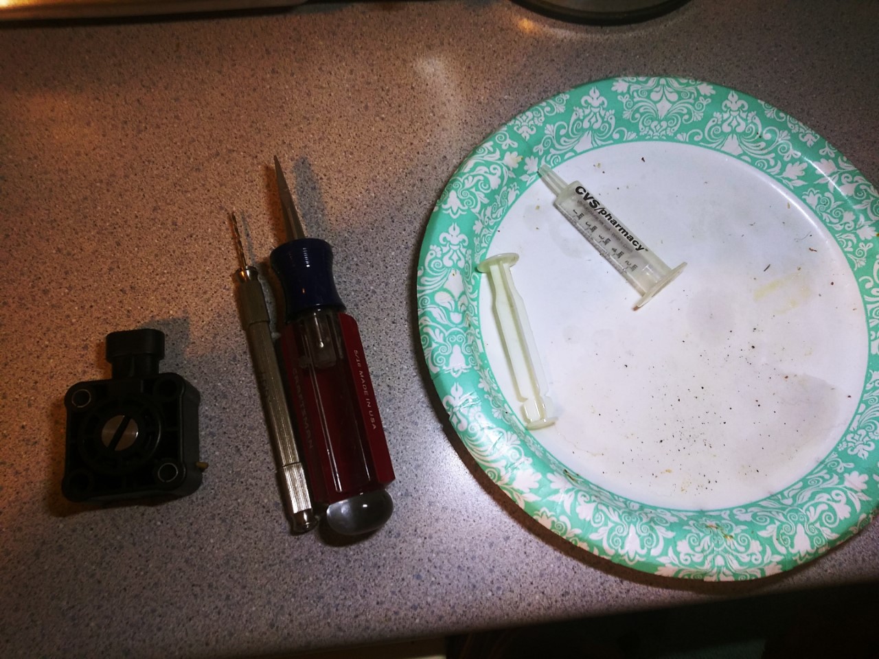

    Pic 1 depicts drilling through outer wall at about 20°, clear of the cavity bottom, beyond 'standoffs' and through switch proper, and again from opposite diagonal position. Body thickness and logic say internally, there is a commutator not a rotor, and why deep position was chosen, about .12 up from switch face, the cavities not visible when assembled. Very easy test of rotation didn't reveal any interference with shank end of drill, of 1/16" diameter.
    Pic 2 Then plugging outer holes with toothpicks, used syringe to fill one cavity while operating the barrel with 90% iso-alcohol, it drained out other side. Part way along, I hosed down the cavities to help reveal whether anything would flush from inside. That was seems inconclusive.
    The switch is evaporating alcohol out now under an incandescent lamp.

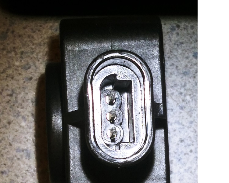

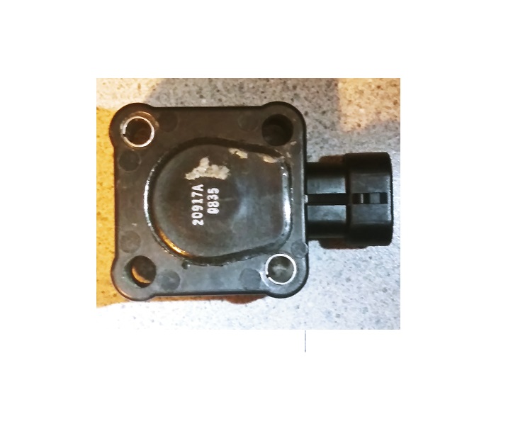

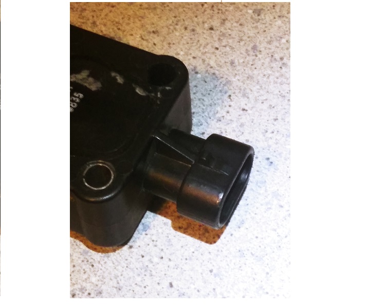

    Yes. I ran cross visual matches that didn't display the connectors well enough to understand configuration used by Dodge via rockauto.com. Not been involved service wise with drive-by-wire before. Took added pics to aid continuing search. The 20917A number doesn't retrieve anything until combined with 0835 - no switch but complete assembly. Still puzzling,
    Accelerator sending unit remedy......maybe.-pn.jpgAccelerator sending unit remedy......maybe.-lug.jpgAccelerator sending unit remedy......maybe.-connector.jpg
    and $154 is about one-fifth the expense of those shown, yet not in stock anywhere, and discontinued through Ford! 2005? Even the shop doing the work couldn't find one. The APPS is hard to find, the TPS (throttle position sensor) easier, but deemed a fault when dynoed.
