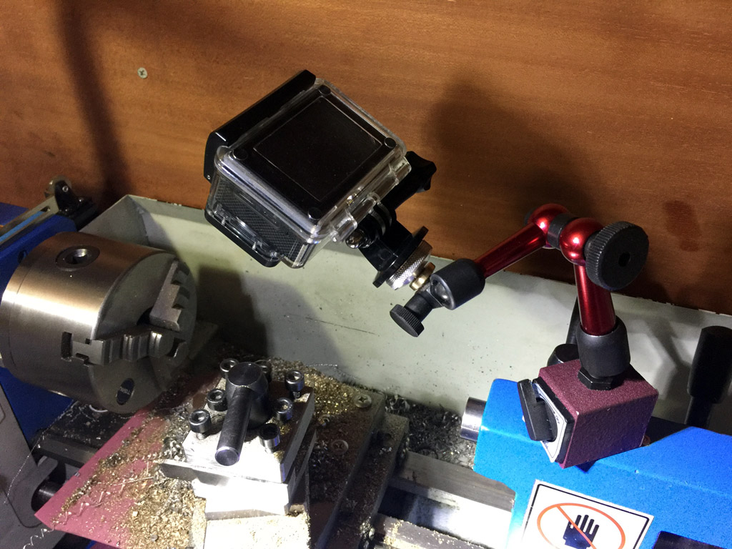

    Action Camera holder for lathe

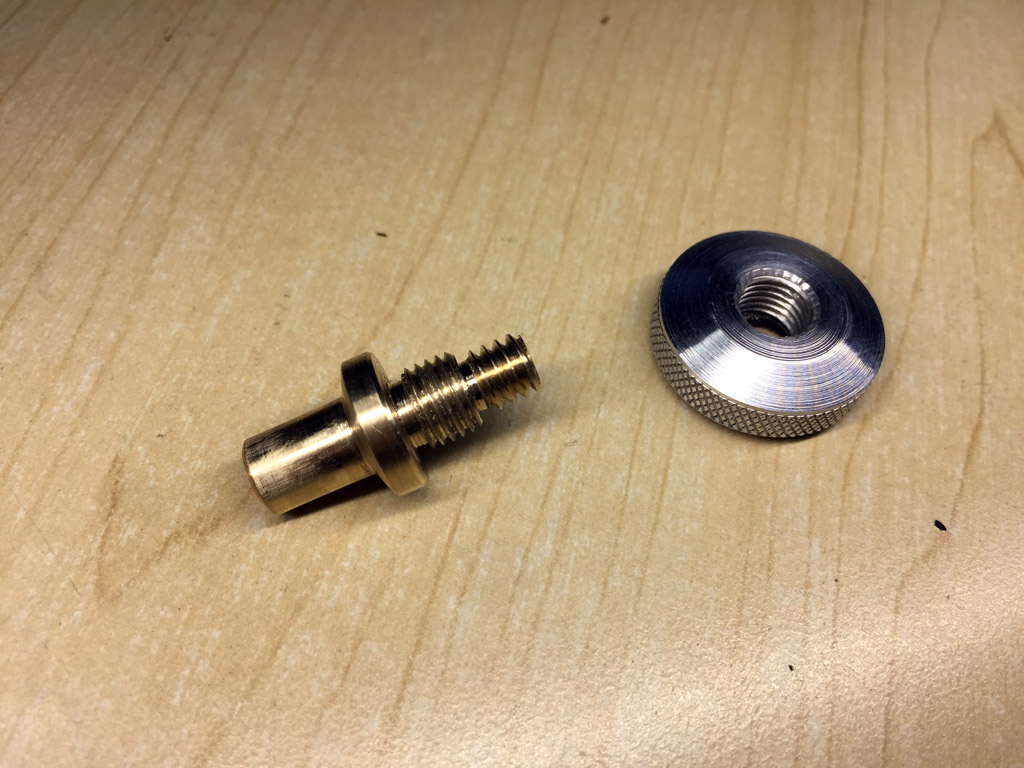

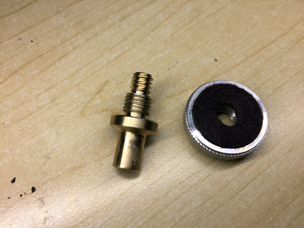

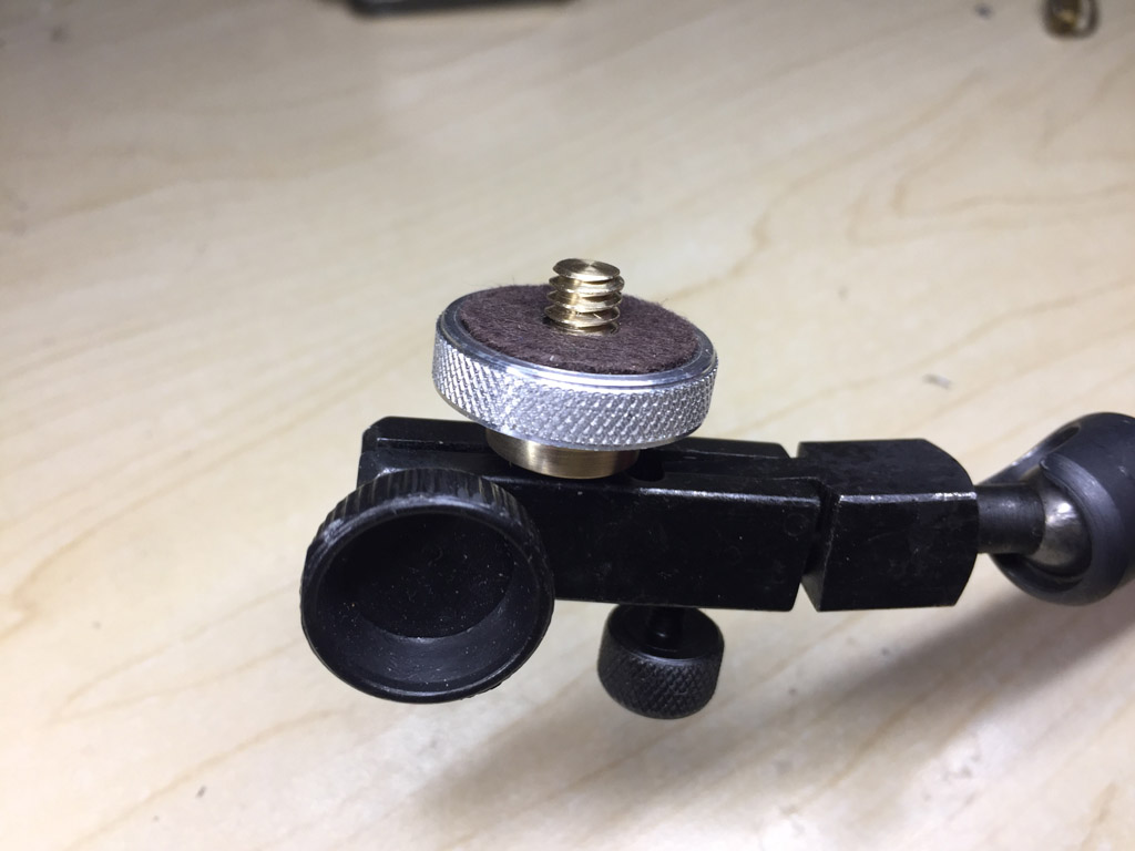

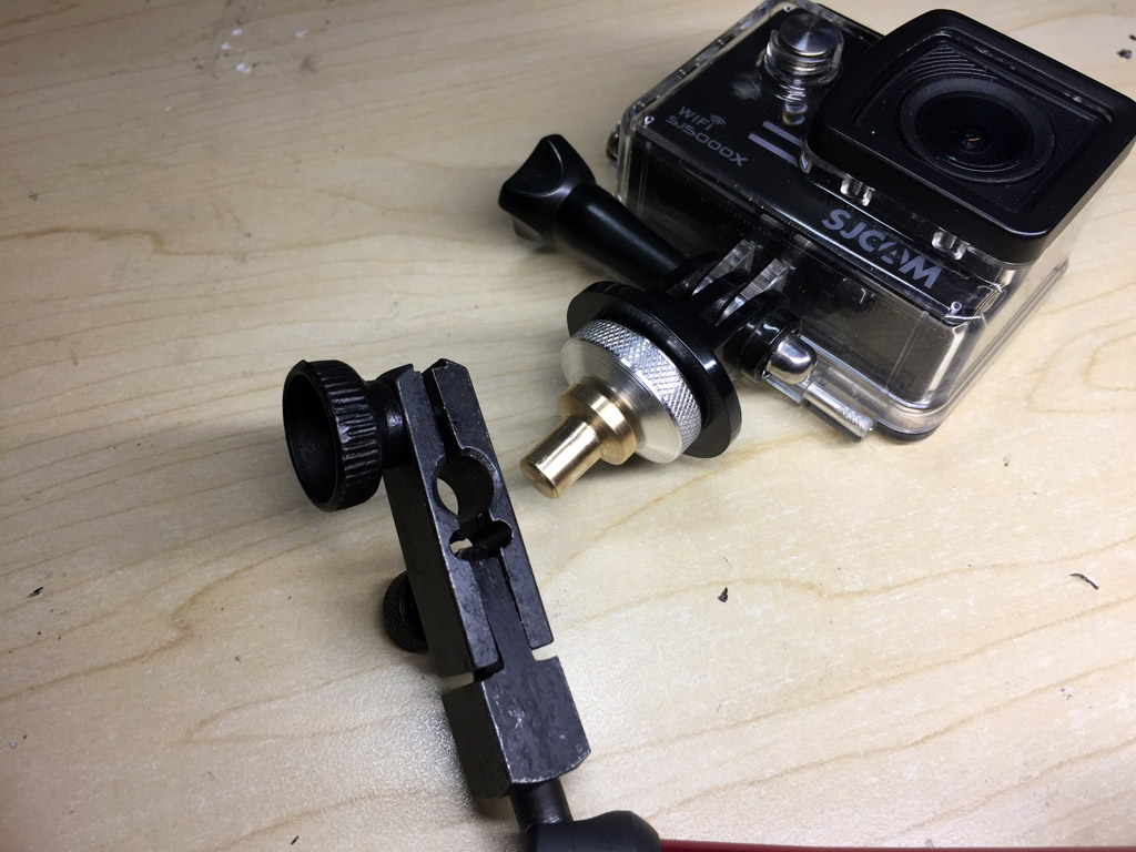

    I make a simple Action Camera holder for my mini lathe.Use some copper and aluminum,made a conversion screw and nut,installed on the Magnetic Dial indicator holder.They can be adsorbed on any steel and they are stable.
