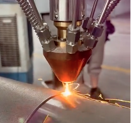

    So, is this a neater, cleaner version of "spray welding," or are they just laying down a weld bead with a wire feed I don't see.

    Looks to me like it is a spray head, I do not see any wire making that arc.
    Pic is a little larger if you click it.

    Pretty hard to tell from the video. It is depositing a lot of material quickly, but the arc seems kind of dim. Not a camera thing as the background is clearly visible.
    That machine is certainly tech I have never seen before. Would like to know more about it.

    I don't think it's an arc welder, but a laser. The closer I look, it appears there are at least two streams of powder aimed at what would be the laser's focal point, and the sparks (at least some of them) would come from individual, stray particles crossing the laser path above the weld.
