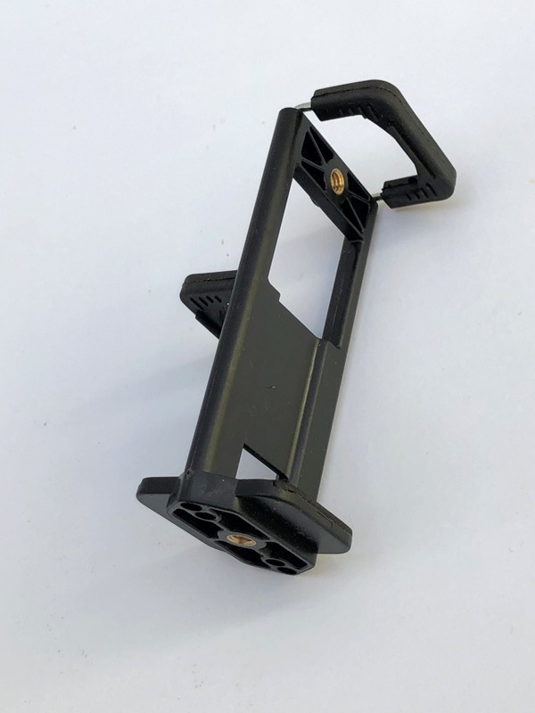

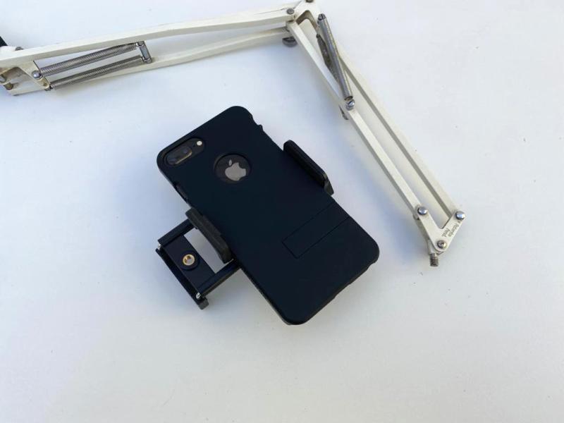

Adjustable arm phone holder
With a cheap phone holder
Attachment 38154

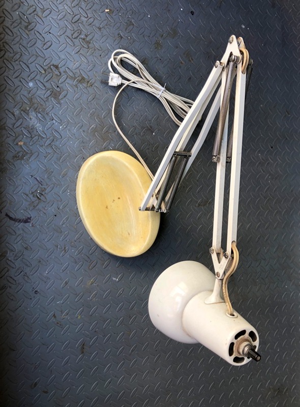

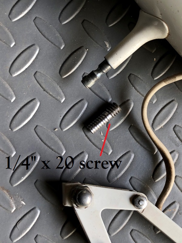

An old lamp out of use
Attachment 38164
And a modified ¼ x 20 screw
Attachment 38156

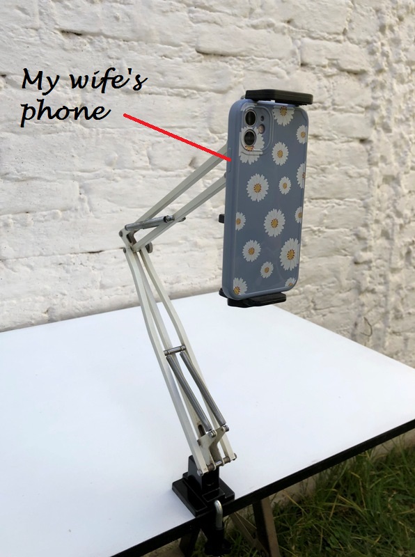

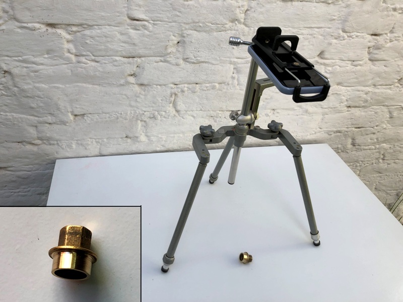

I made this adjustable arm phone holder.
Attachment 38158

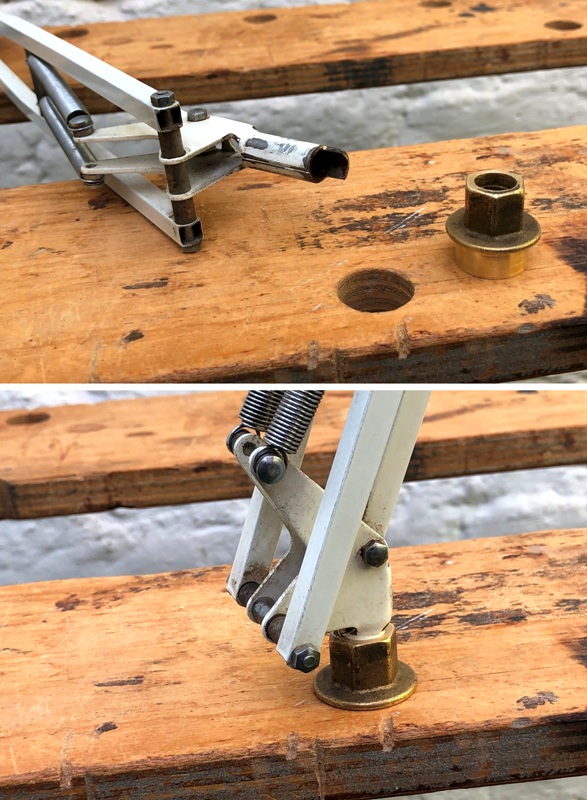

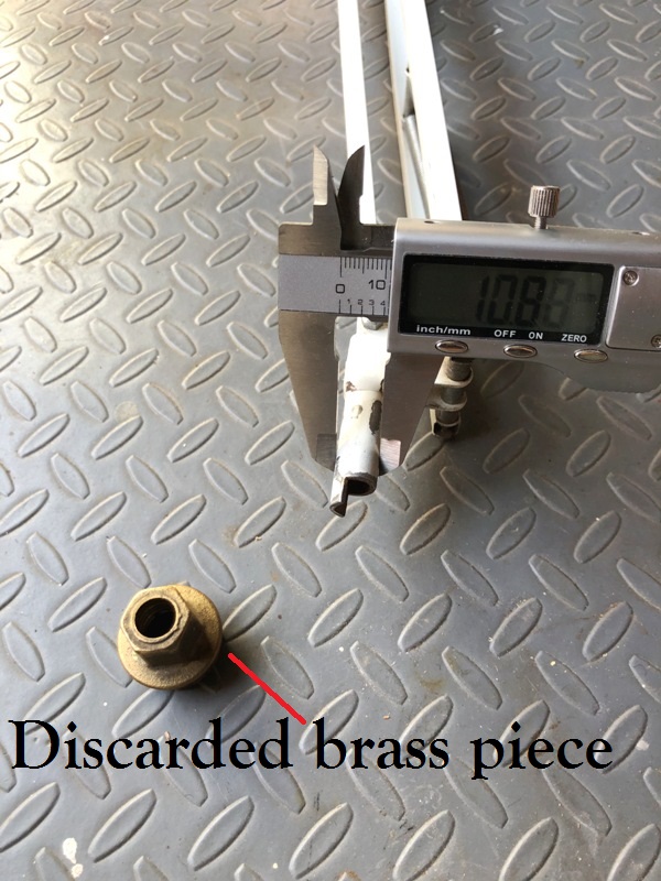

A modified brass piece (from discarded plumbing) serves as a bushing to fix the holder on the workmate or workbench (3/4” holes).
Attachment 38159

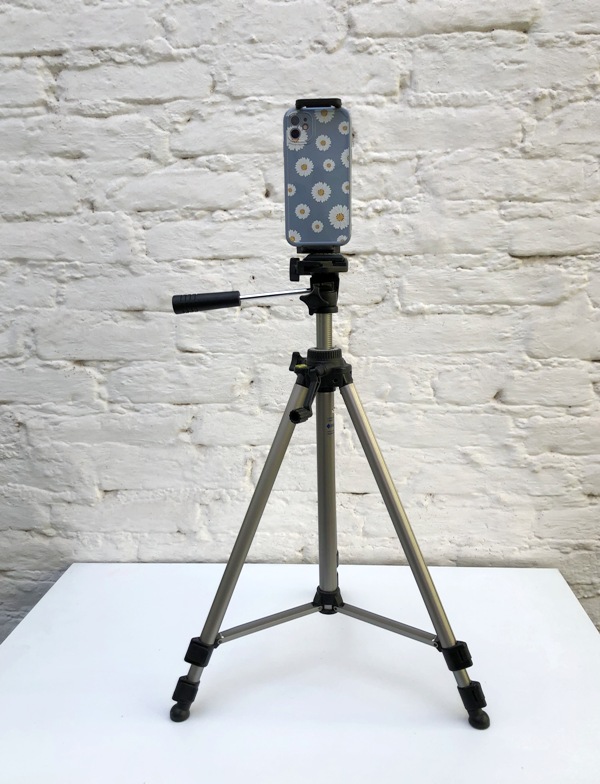

Attachment 38160

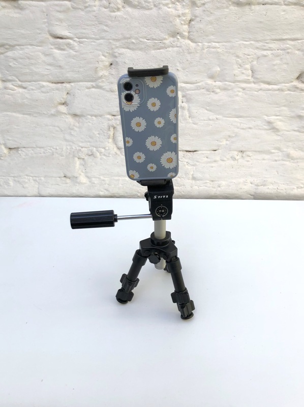

This phone holder also works to support the phone on tripods to take pictures or videos.
Attachment 38161
Attachment 38162
Attachment 38163
