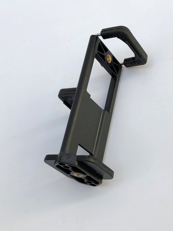

    Adjustable arm phone holder
    With a cheap phone holder
Name:	1-Phone holder.JPG

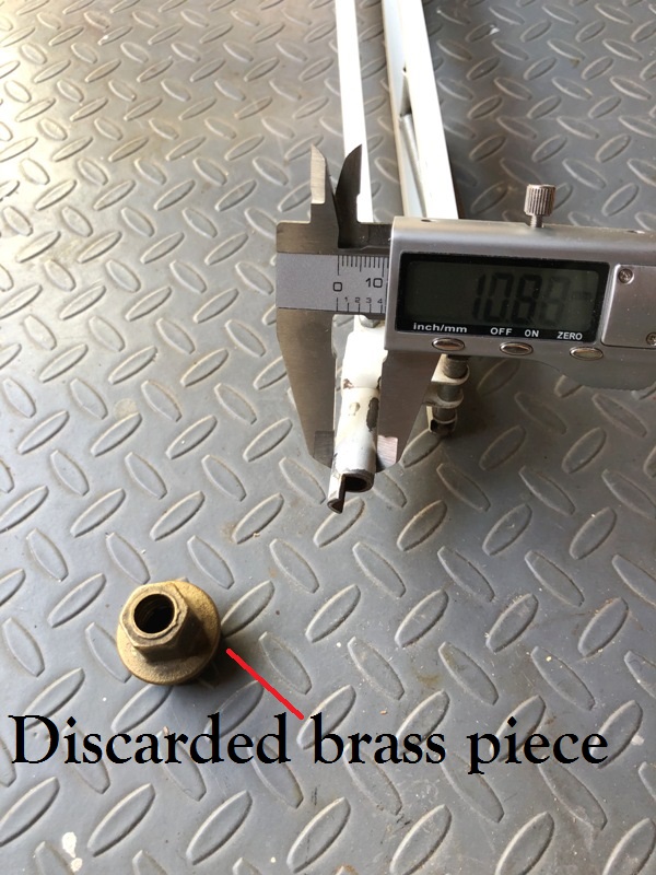

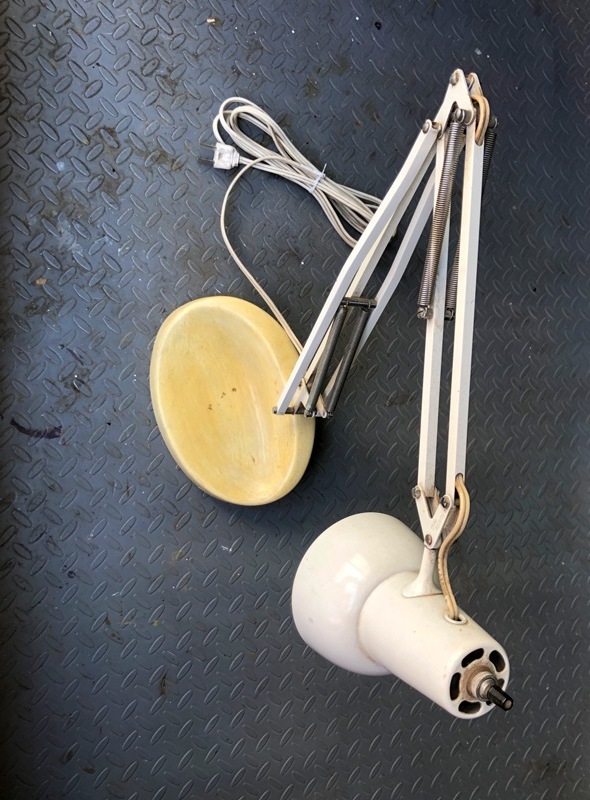

    An old lamp out of use

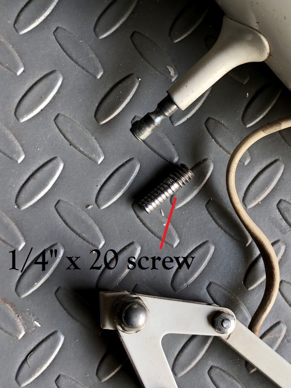

    And a modified ¼ x 20 screw

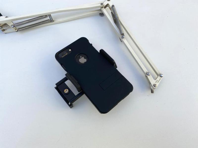

Name:	4-Phone in holder.jpg

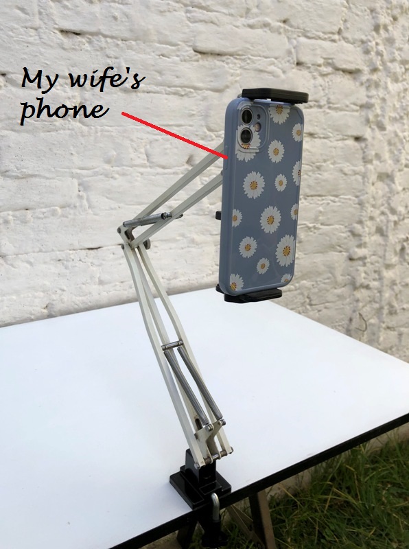

    I made this adjustable arm phone holder.
Name:	5-Arm and bracket.JPG

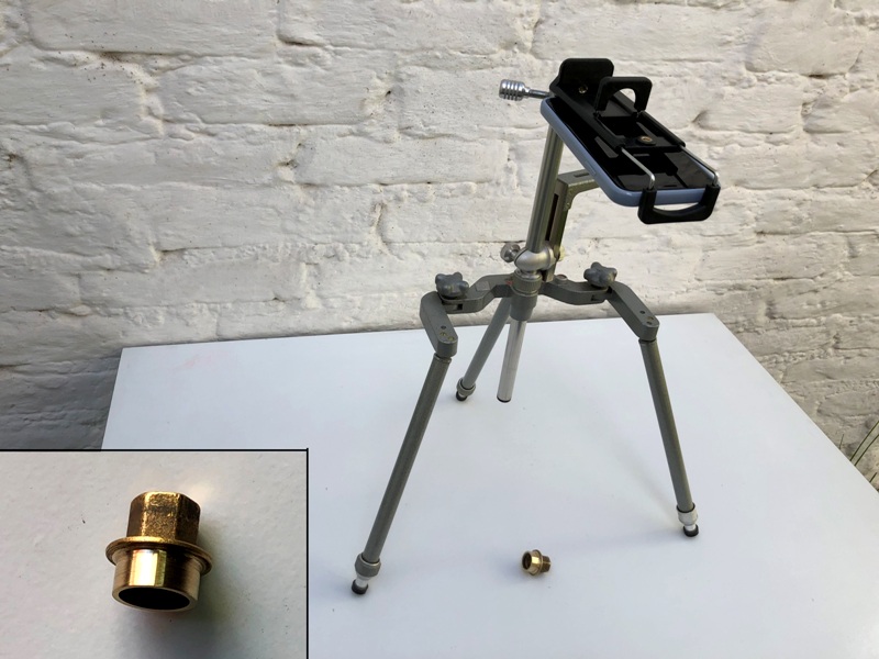

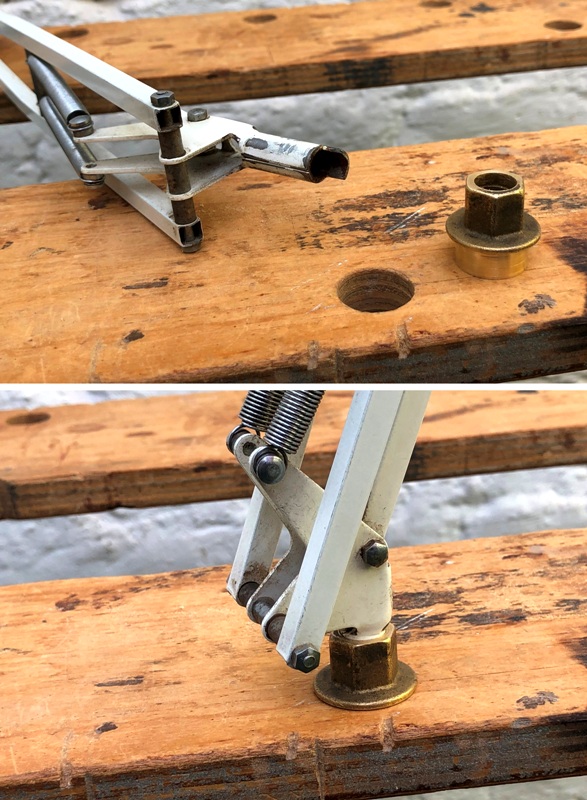

    A modified brass piece (from discarded plumbing) serves as a bushing to fix the holder on the workmate or workbench (3/4” holes).
Name:	6-Arm pivot.JPG
Name:	7-Brass bushing.JPG

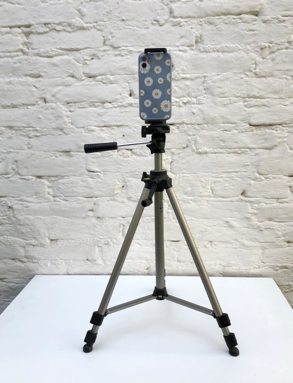

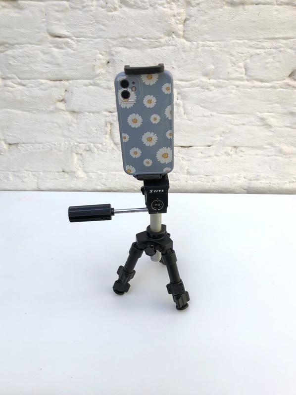

    This phone holder also works to support the phone on tripods to take pictures or videos.
Name:	10-Tripod and image.JPG
