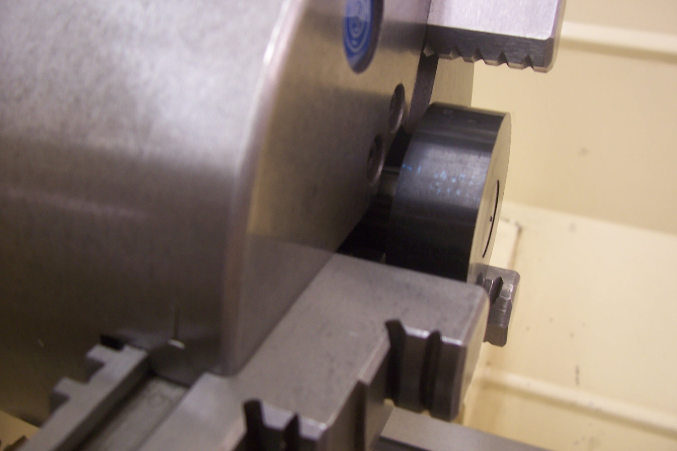

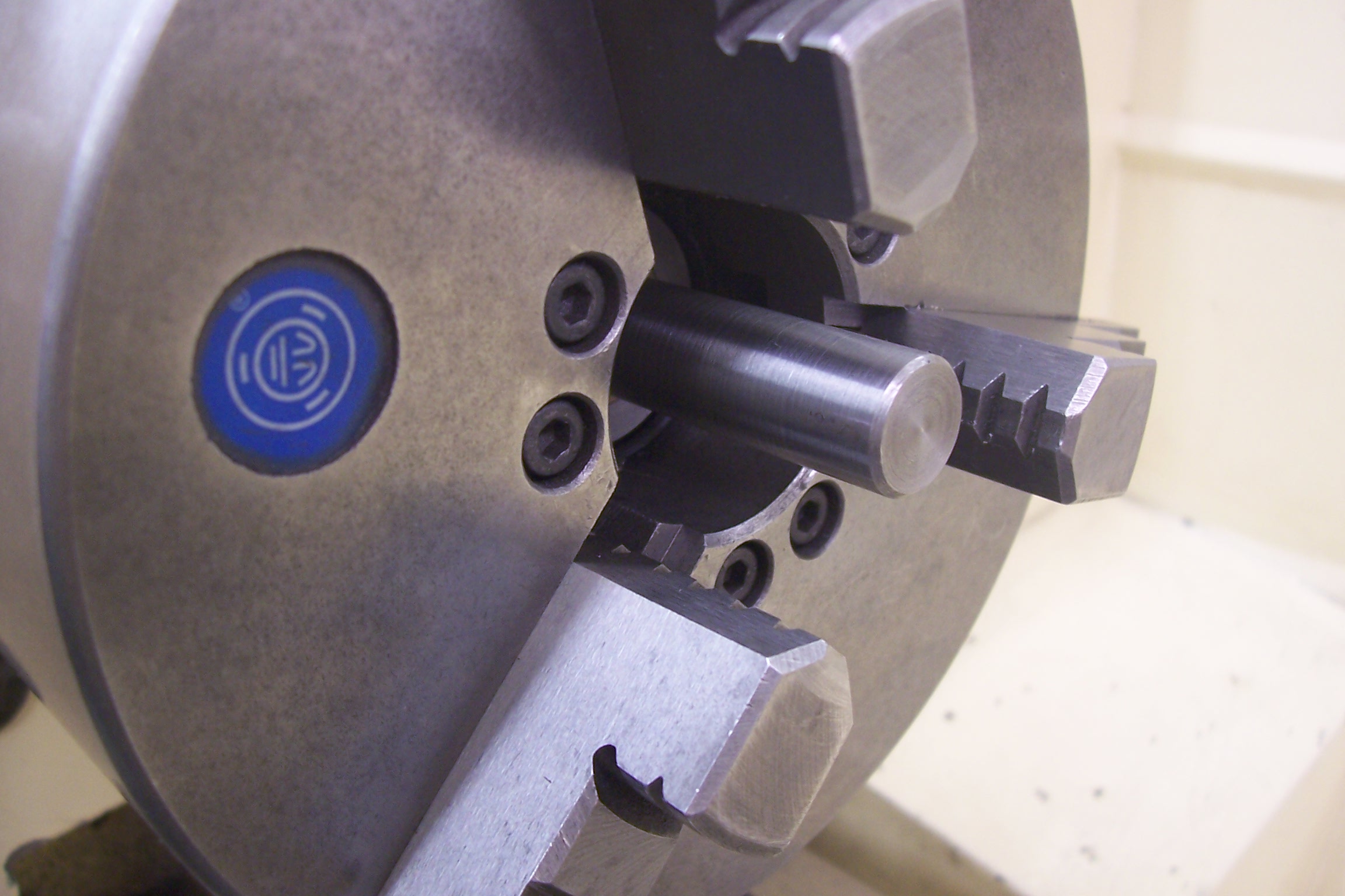

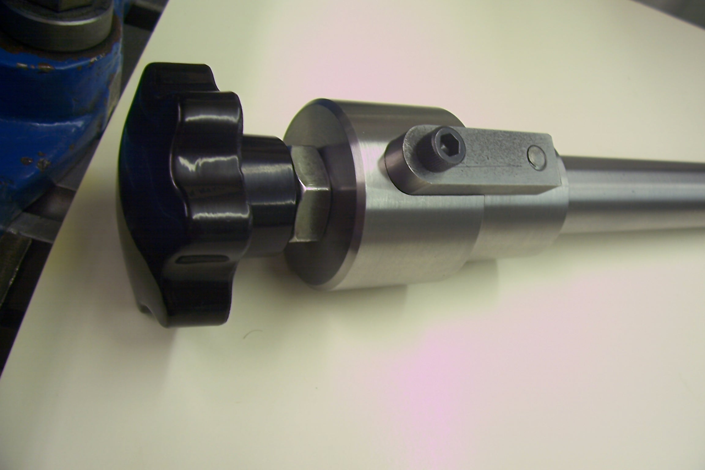

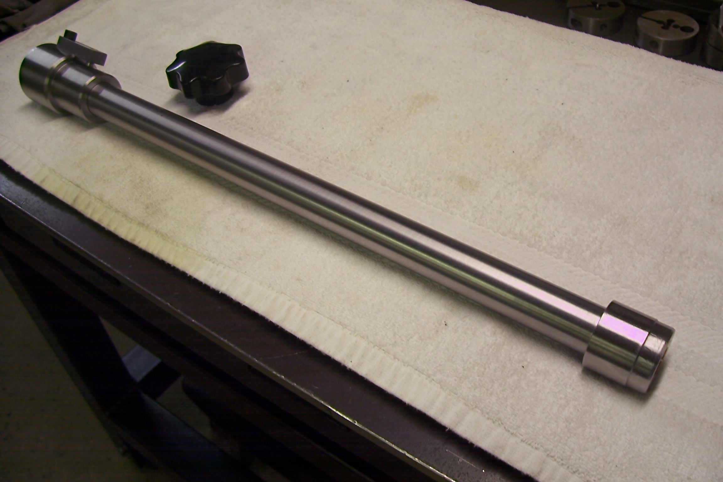

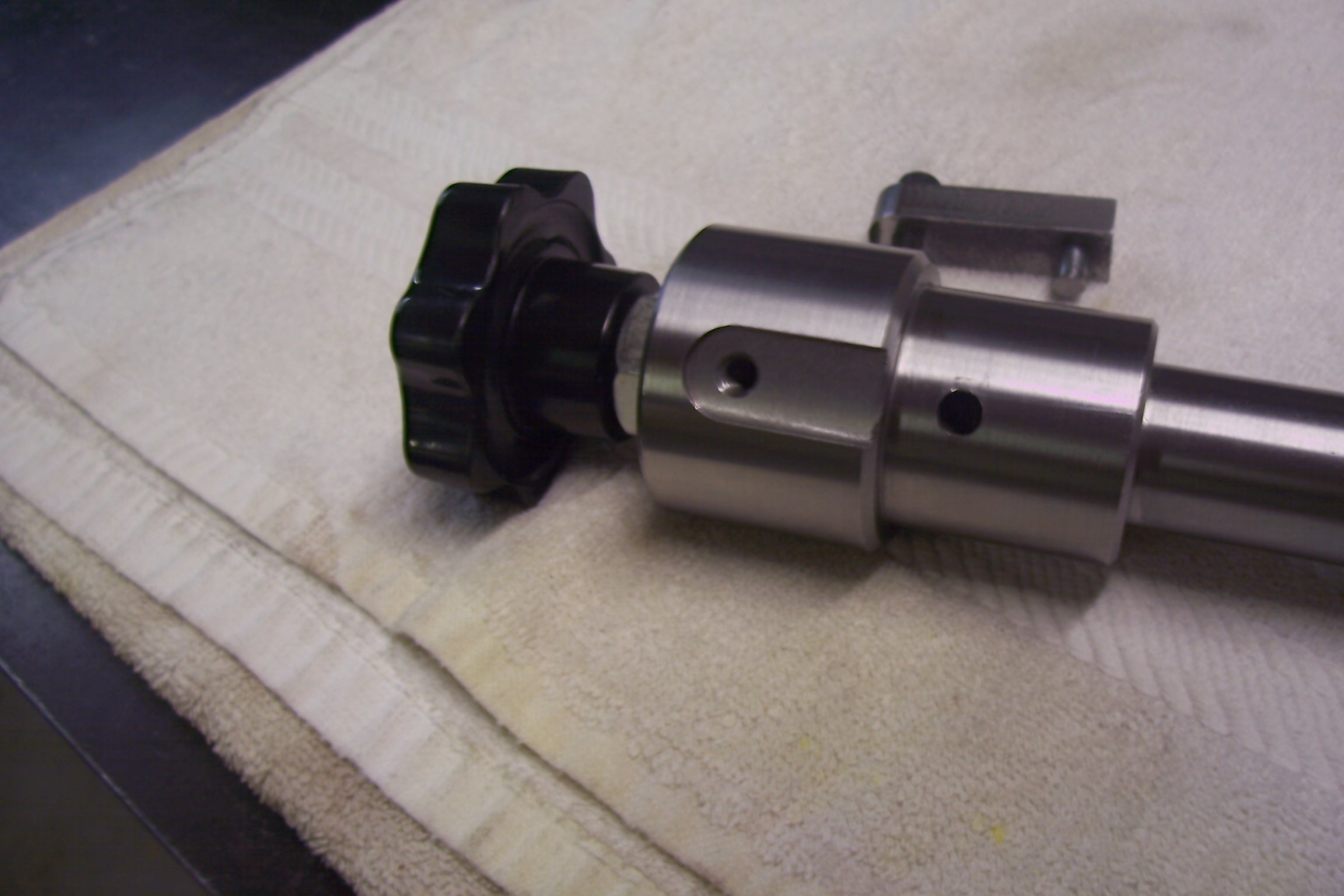

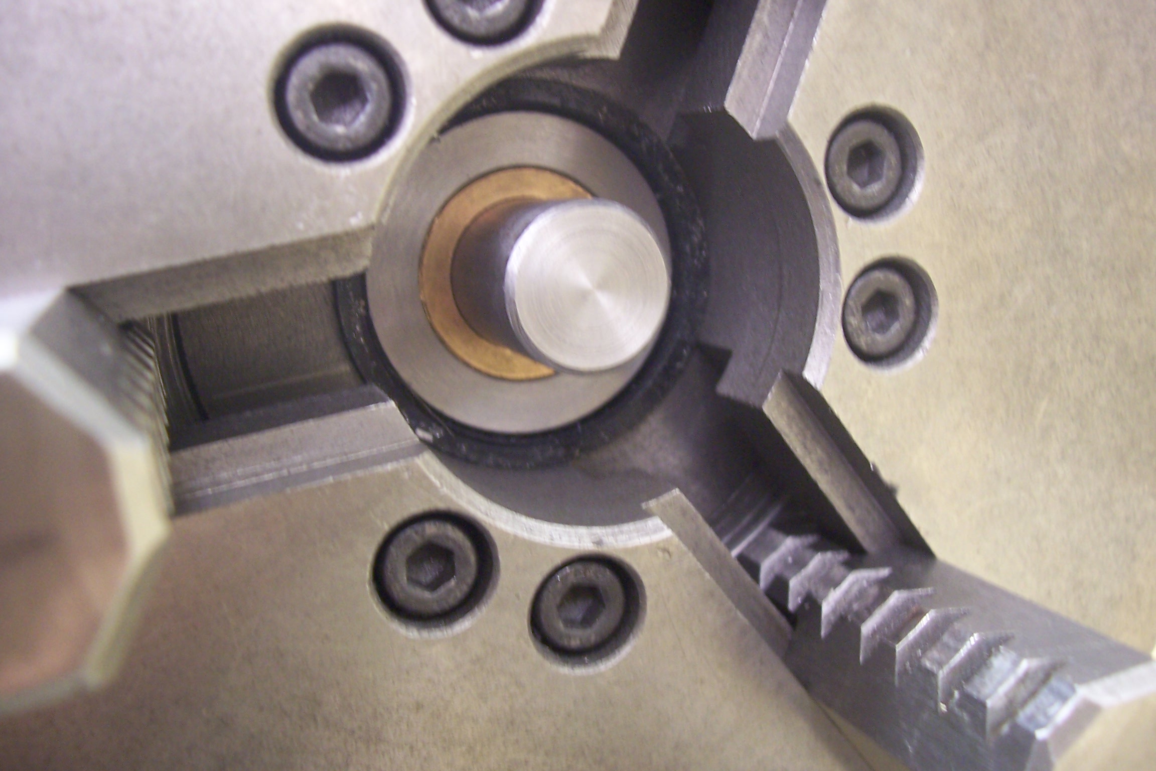

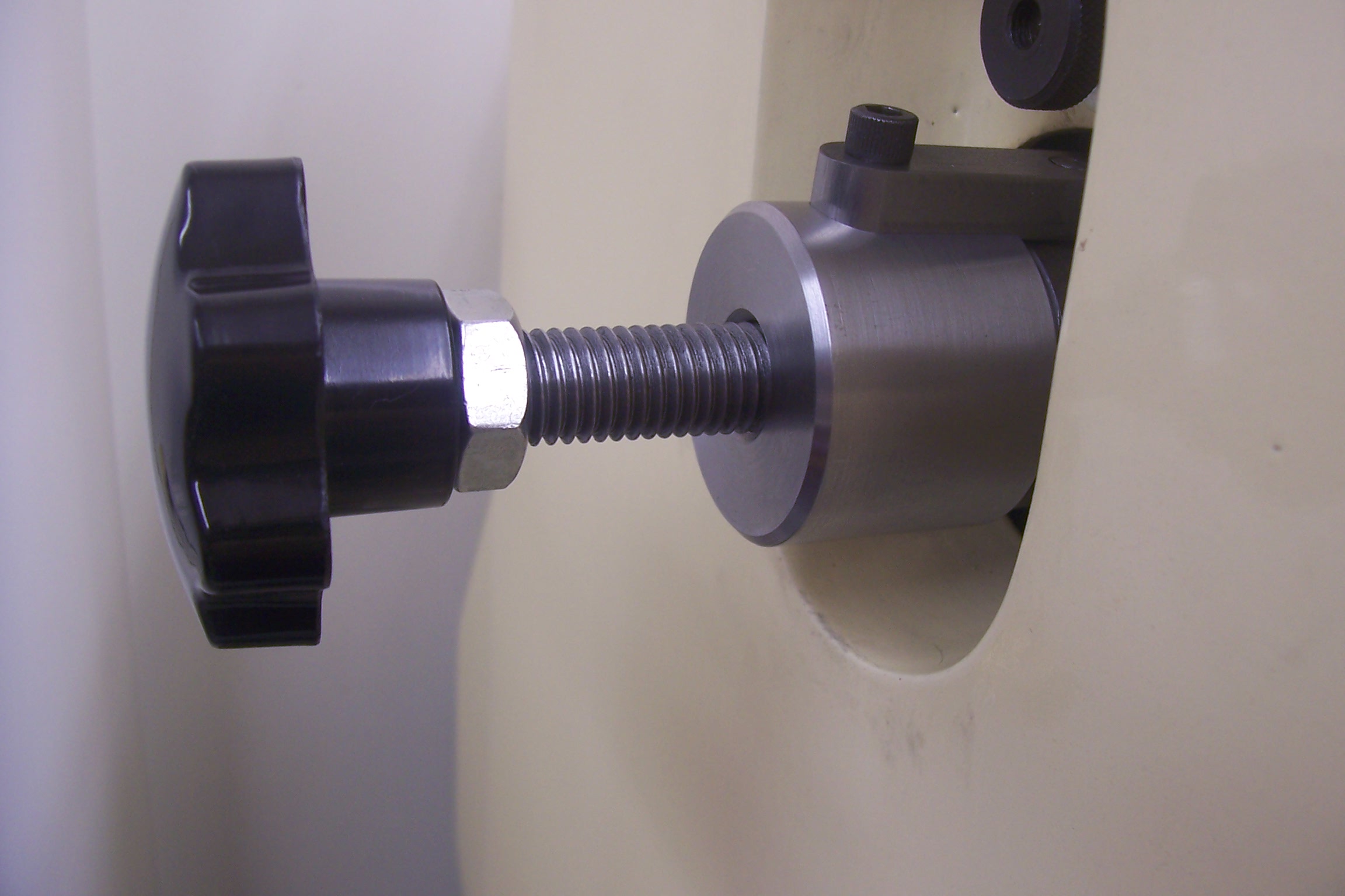

Hi, I would like to show you my version of a spindle mounted chuck work stop. this one retracts allowing full use of the chuck while still mounted in the spindle. it also uses different diameter pucks that slide onto the 5/8" rod for different diameter work. It attaches at the rear of the spindle with a single Allen bolt. The main body is 1" DOM with the ends pressed onto it.The depth is set by adjusting the (cr) 5/8" rod with the thumb screw. It can be used with or without the slip on puck of your size choice, as visible in the last photo. It is for repetitive lathe work. Hope you like it. Thanks for looking.
