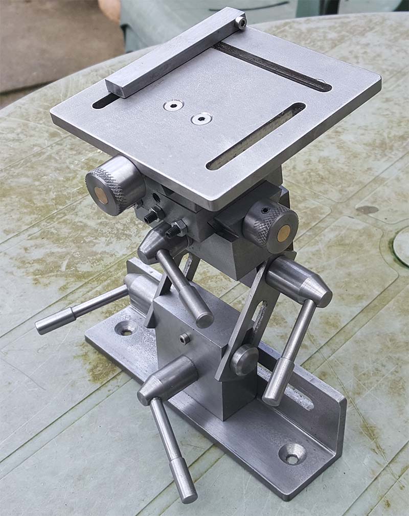

    Hi
    One thing I have never been able to do is off hand sharpening of lathe tools
    so up till now I have always used indexable insert tools and when they get blunt or broken
    just replace the insert but they just dont make fine cuts like a HSS tool
    I do have one tool that uses HSS bits and thats a Diamond tangiental tool which came with a little jig
    to make sharpening simple as it sets all the angles for you automatically
    Recently I found Harold Halls web page and have been trying some of his projects with a lot of success
    like his tool for sharpeneing the end face of end mills
    Today I finished building his advanced grinding rest which was a fun build with turning , milling and dovetail cutting.
    I still have to make the accesories for holding round / square tools ready to be sharpened but hopefully I can soon start using HSS tools that I sharpened myself
    Here is the grinding rest to Harold Halls design
