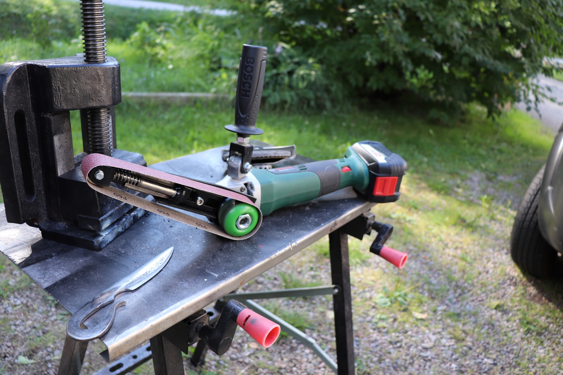

Definitely the Epic Super hero of getting the Most and Best out of tools. Love the flight of the Valkyries!! Think you are getting your money's worth out of that vice resto also!! Does the belt fold over on the bearing end after a while?
Great Build Tuomas, Thanks for sharing it.
PJ
Thanks buddy.
Fixing that vise really was a good decision. Cost about 10$. New that kind of heavy duty vise would have been somewhat pricey. Also, that shape makes it more handy for my use.
Belt folds around the edges of the bearings after couple seconds of use with full speed. That keeps belt running straight.
I made first version with three bearings, that didn't work as well it does with two.

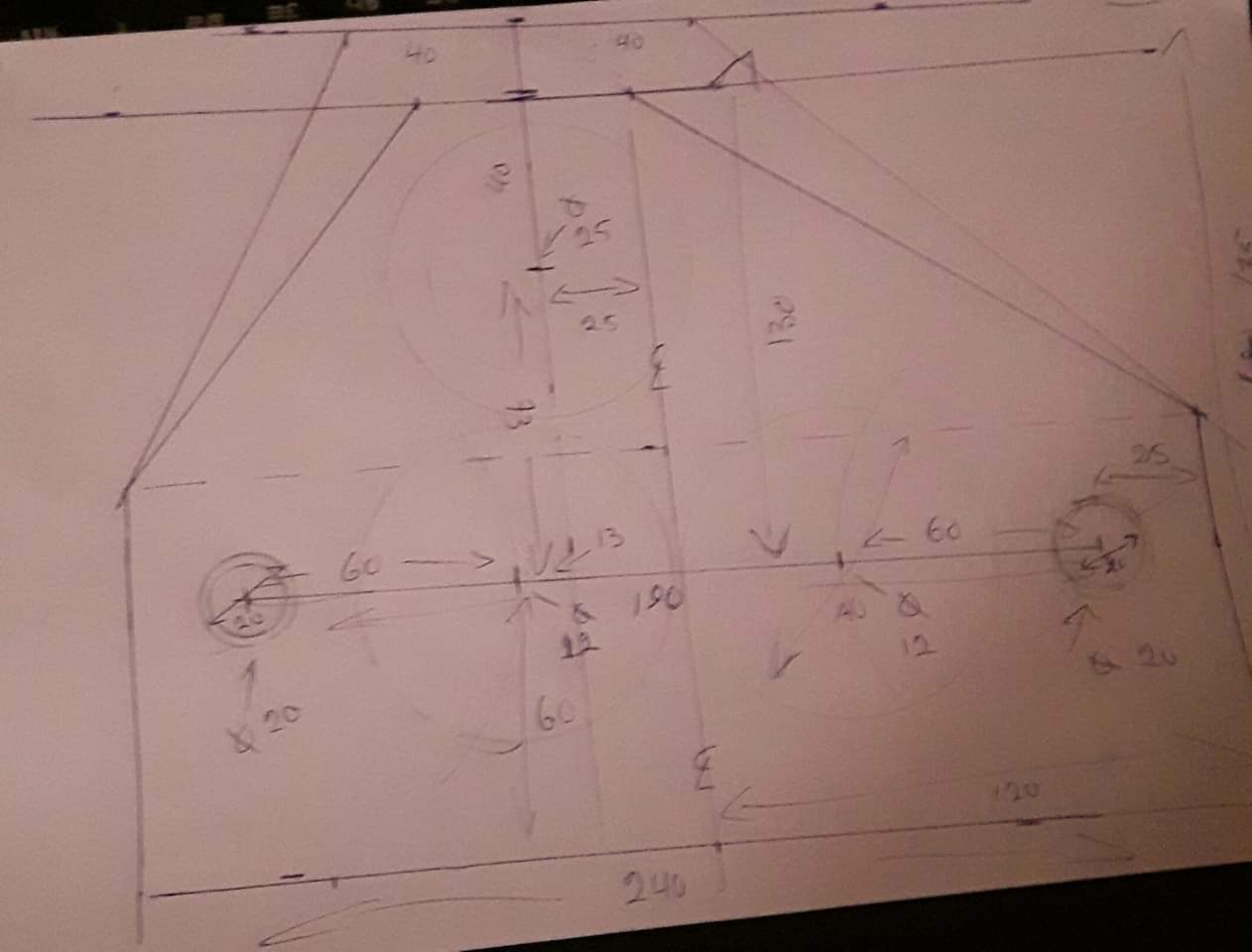

Btw.. people asks plans from me sometimes.
Here's my plan for the ring roller that i have been building atm.
Attachment 26135

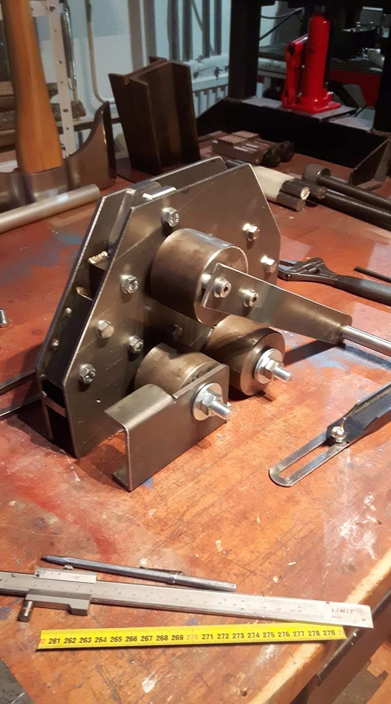

And here's the build atm..
Attachment 26136
I just make notes for myself, from measures need to remembered etc... I think those ain't very usefull for others. :D

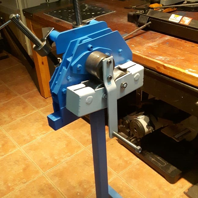

Finished ring roller.
Attachment 26243
I supposed to make this video long time ago.
