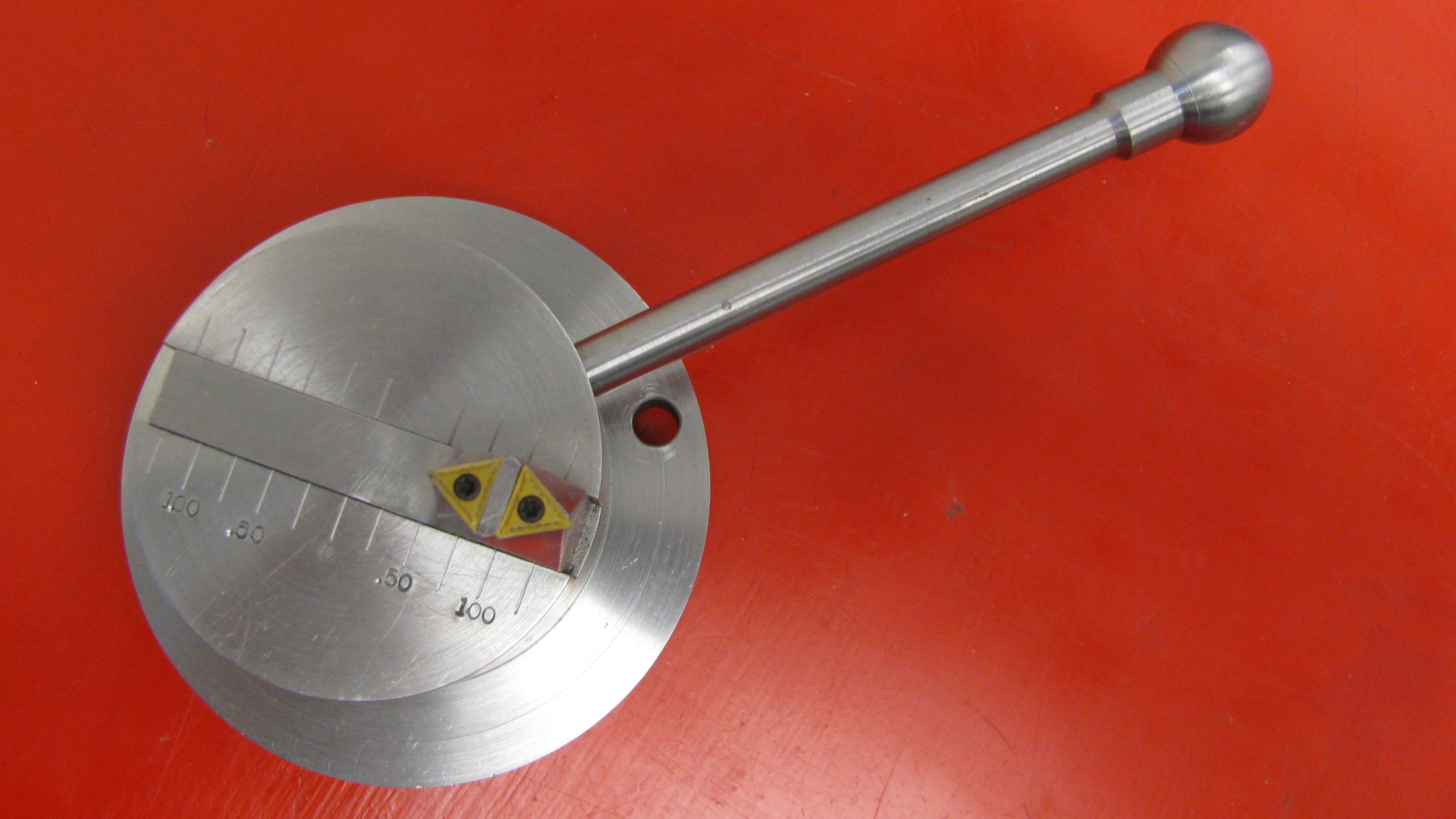

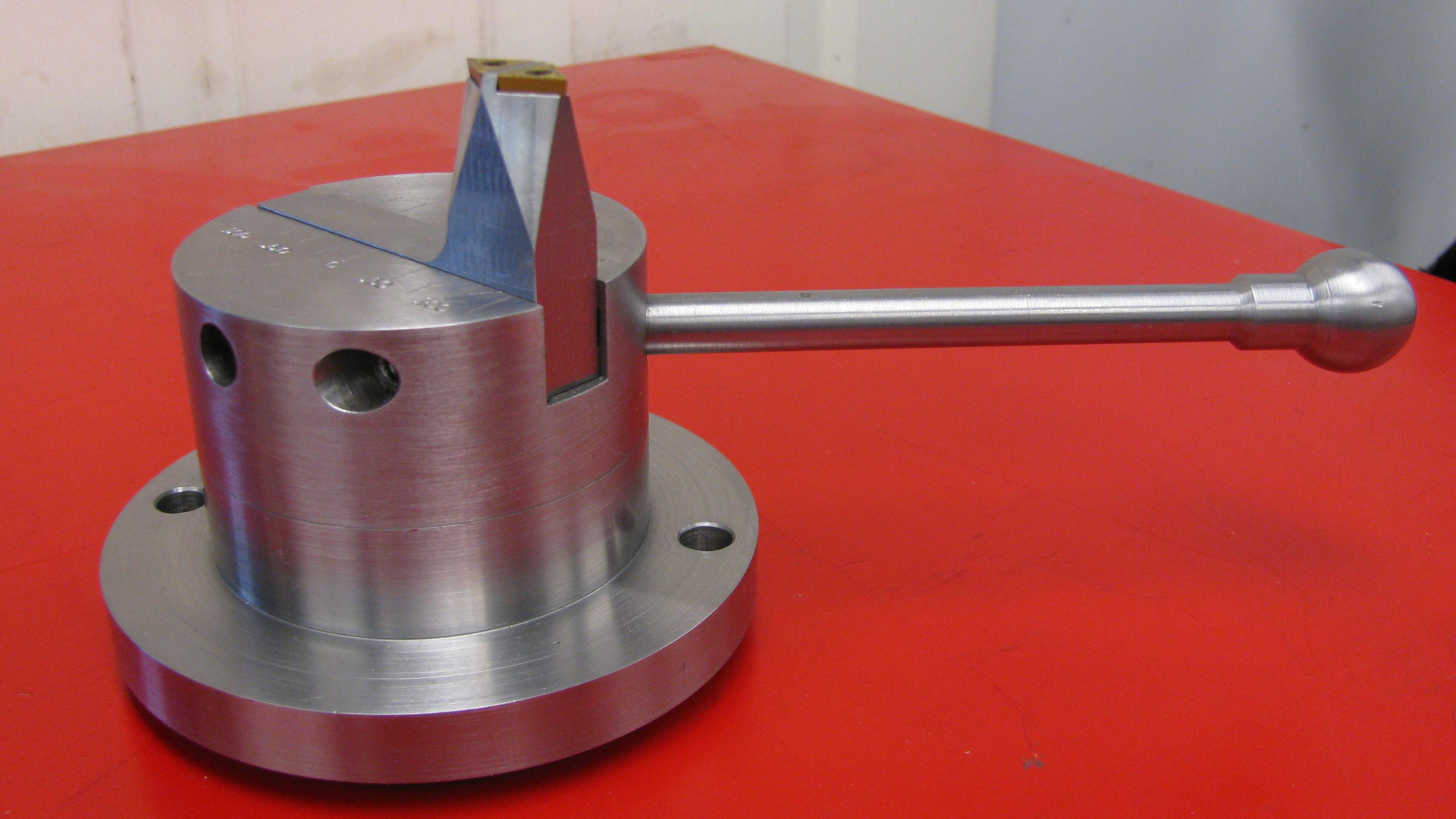

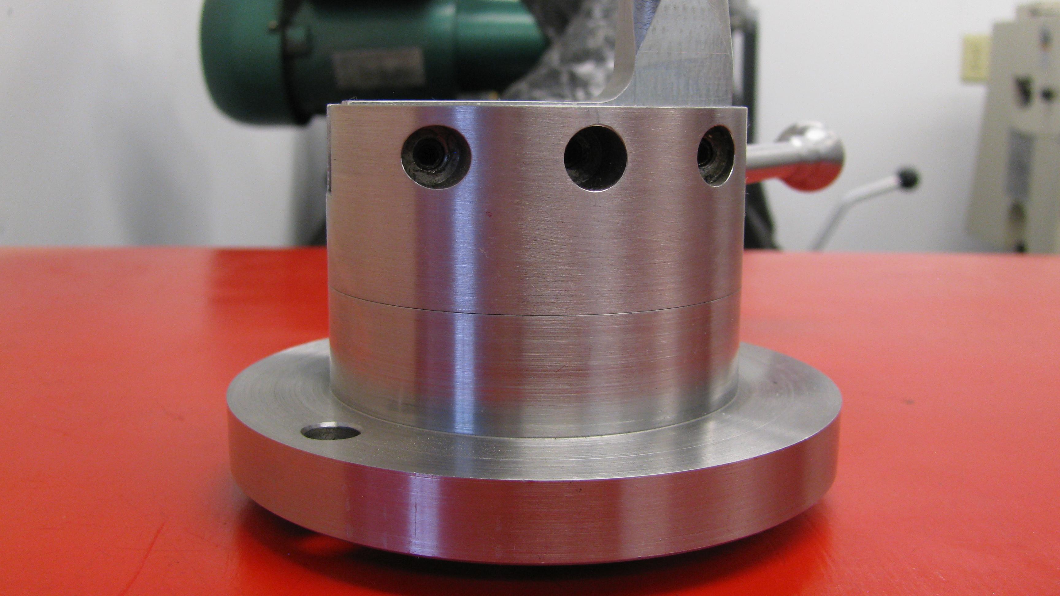

    Another Ball Turning Tool I completed sometime ago. Nothing unique or special about this version but it does do a good job of
    producing spheres. The one troublesome aspect is one has to remove the compound slide to fit this devise to the machine.
    Another Ball Turner-ball-turner-no-1.jpgAnother Ball Turner-ball-turner-no-2.jpgAnother Ball Turner-ball-turner-no-3.jpg

    Thanks, that just gave me the idea of how to make an inside radius turner for smaller radiuses. Actually, looks like yours would do that as well.
