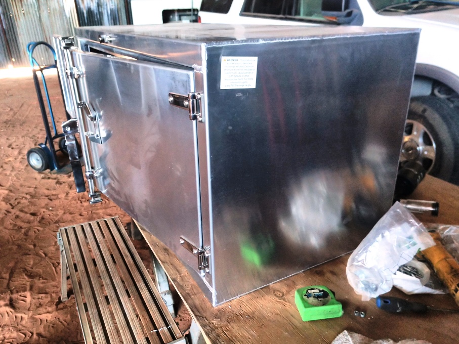

    This is a third version of the explosive's drome box. So far, each cargo box has been configured differently as per customer's requirements.
    And this one is by far the simplest to assemble fewer panels to cut since there are fewer "E" tracks required. fewer holes to drill fewer number of stainless screws and stainless rivets should translate into a lower final cost. But wait until the box mount is posted,
    the box

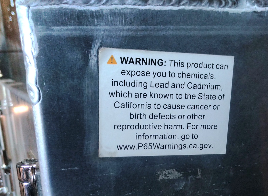

    Even has the obligatory prop65 warning. I guess just touching this box will cause your babies to be born naked or give them or you cancer.

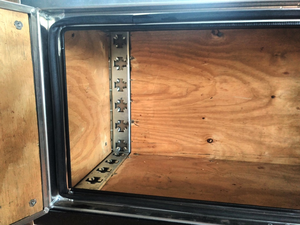

    inside the box note only 2 "E" tracks mounted at each end. I added an edge protector to prevent personal injury from contact with the sharp edges Who knows it may even help prevent birth defects since the driver can't cut him/herself and get infected
