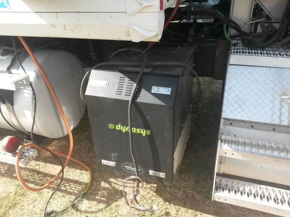

We've had this 6KW APU sitting in my storage for over a year now so it was high time to put it to use.
Bob showed up with a new toy to add to my collection and needing to take his reset for his electronic logbook
What better time than now to mount the APU
Attachment 30713

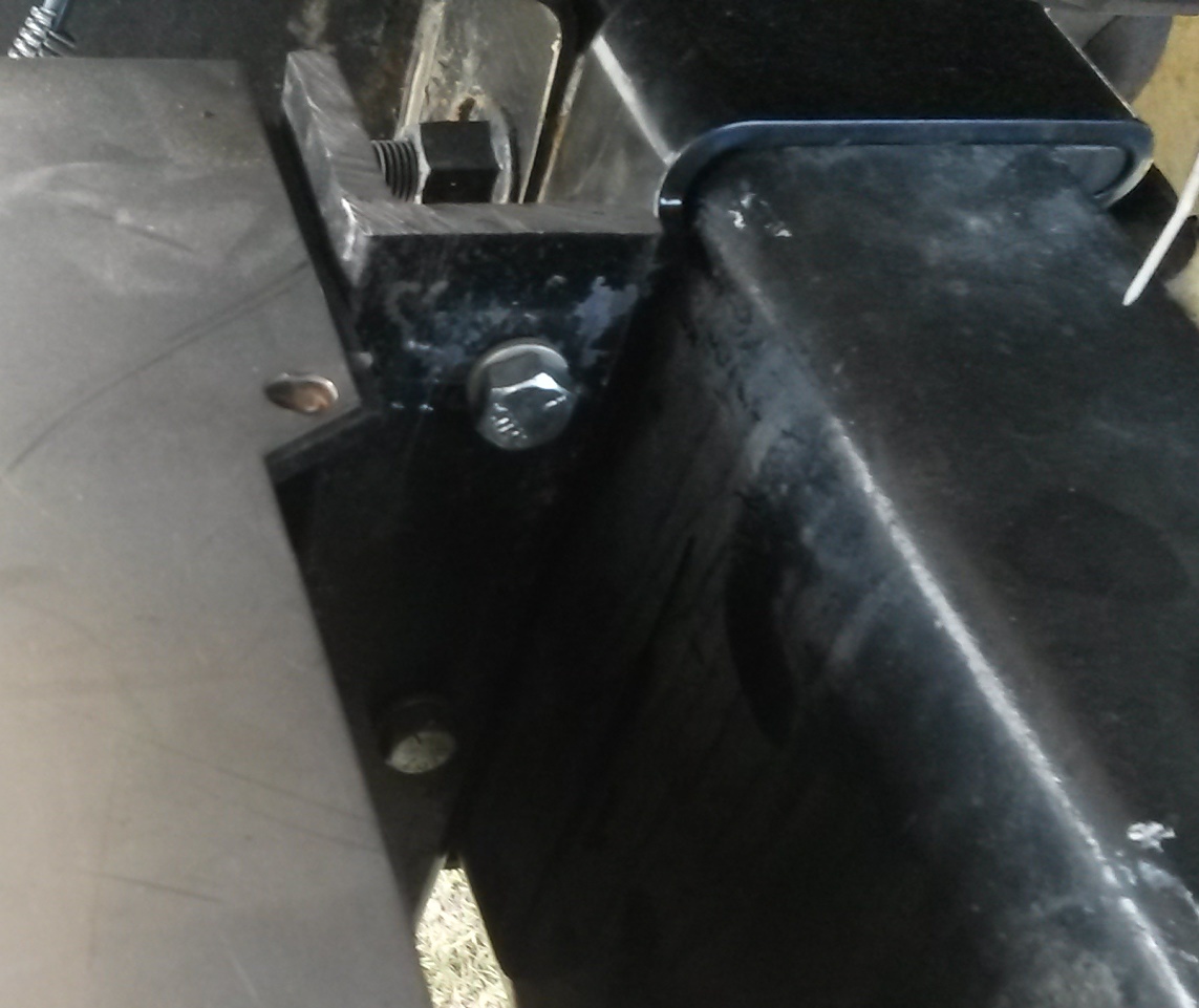

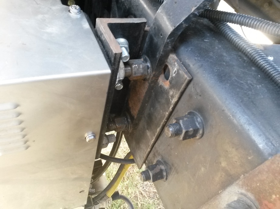

This is the bracket I had to make to mount it with On 1 side I was able to use a bought bracket and only had to make a 2 1/2 x2 1/2" angle bracket by drilling 5 holes in it on the other side I didn't have the room due to a cross member so what I did was to use a 3 x3 angle I drilled 5 holes in it 2 to match holes already used to hold the exhaust support brace and 3 to bolt a transition angle with 5 holes in it the opposite of the angle I made for the other side
