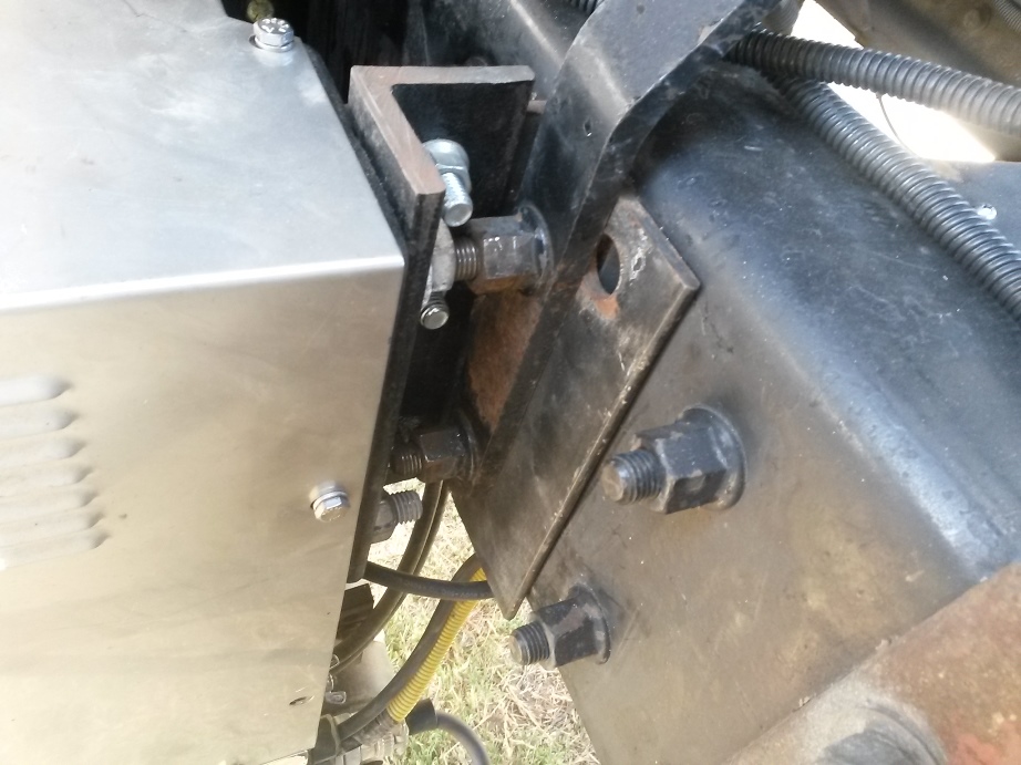

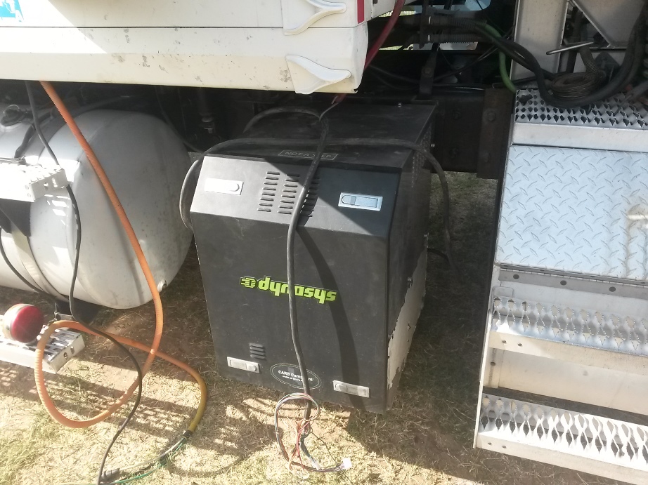

    We've had this 6KW APU sitting in my storage for over a year now so it was high time to put it to use.
    Bob showed up with a new toy to add to my collection and needing to take his reset for his electronic logbook
    What better time than now to mount the APU

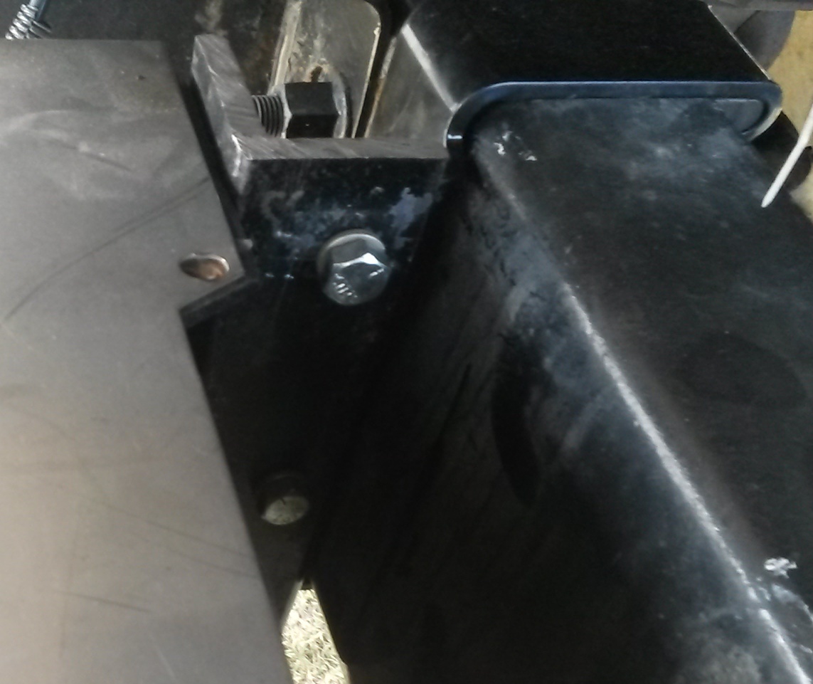

    This is the bracket I had to make to mount it with On 1 side I was able to use a bought bracket and only had to make a 2 1/2 x2 1/2" angle bracket by drilling 5 holes in it on the other side I didn't have the room due to a cross member so what I did was to use a 3 x3 angle I drilled 5 holes in it 2 to match holes already used to hold the exhaust support brace and 3 to bolt a transition angle with 5 holes in it the opposite of the angle I made for the other side
