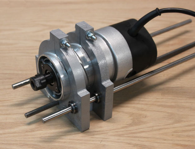

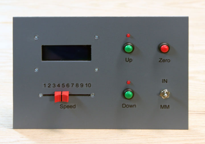

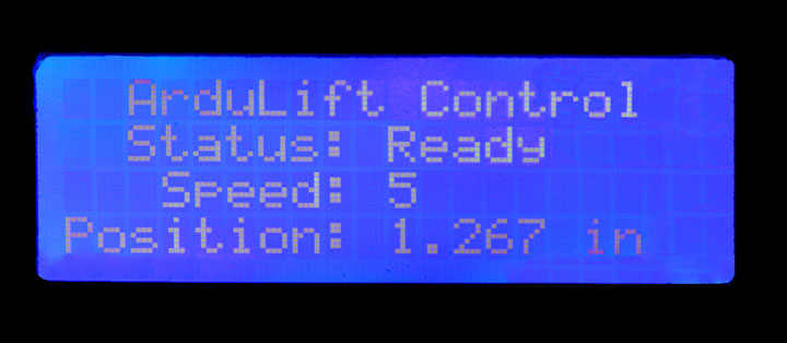

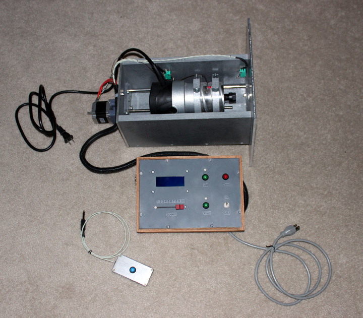

    Here is a DIY computer controlled router lift that was a really satisfying project.
    Made for a drop in router table and uses a stepper motor for precision movement.
    Has an auto zero probe (that thing at the lower left in the first picture.)
    Before you ask me why I bothered, take look at my blog here
    which probably tells you more than you want to know. :^)

    Thank you for posting & documenting such a beautifully well-thought-out design & build!
    As I read your build log, I thought of a way to simplify & strengthen the screw attachment to the end-grain of the plywood box would be to use barrel/dowel nuts (instead of threaded inserts), which would wholly eliminate the opportunities for cross-threading inserts and for pull-out or splitting of the plywood.
    http://www.leevalley.com/us/wood/pag...59&cat=1,43455
    http://www.leevalley.com/us/hardware...76,45375,44238
    Again, thanks much for sharing this!
    Good idea. I found that the inserts work pretty well, as the forces involved aren't in the direction where the inserts are weak, but if I ever see some kind of failure, I can always remove them and use the cross dowels. With your permission, I may mention this on the blog.
