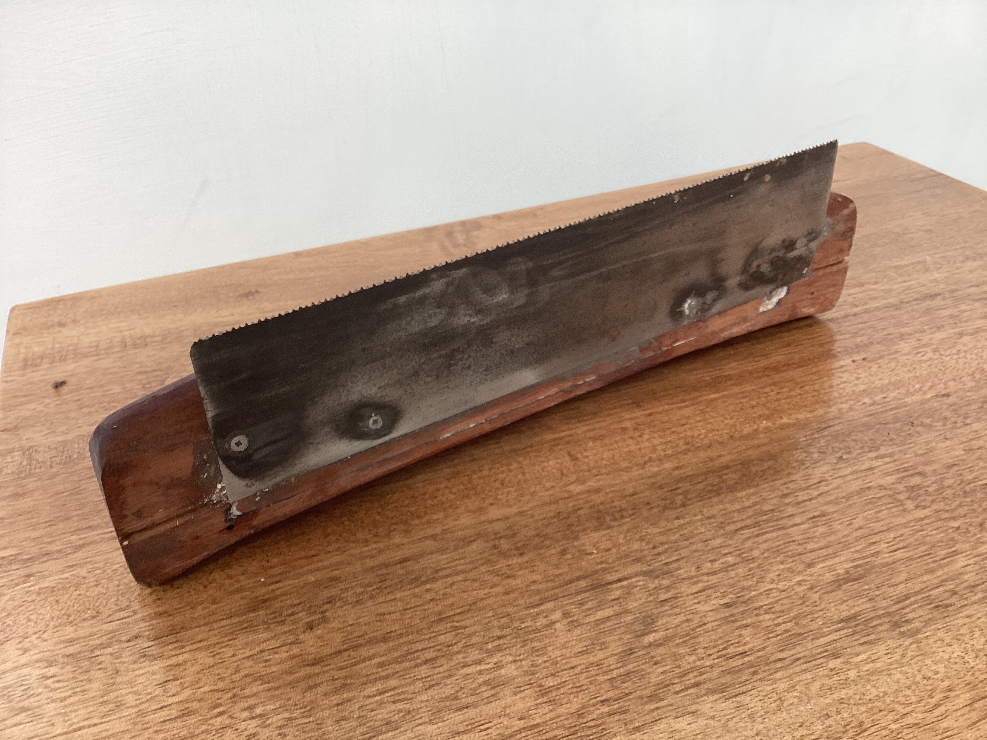

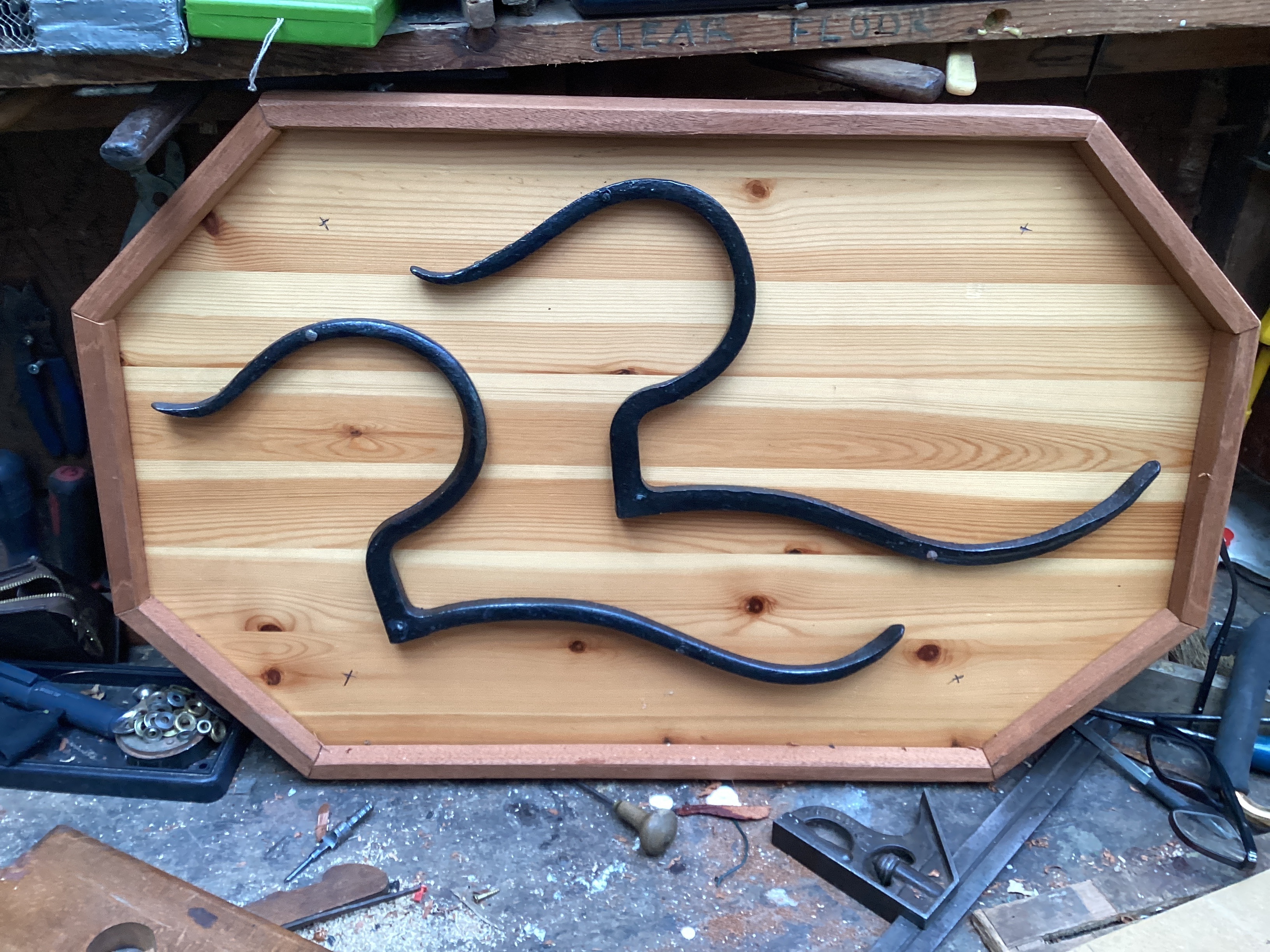

Without having ever seen an armchair saw, let alone actually used one, having only seen a picture of one, apparently used by French cabinet makers, I thought it would be nice to have an example. Cutting the shoulders of tenons on chairs I have found well nigh impossible in the past. The opportunity arose when, only days after desiring one, but lacking the moulding, which in the image on Pinterest, was an ogee, I went into work and found an antique bed head broken in half (and it had been sold, too) with the veneer all splintered. It was given to me to make any use of it, or just to burn. Some has been cut into strips to make a new door sign.Attachment 45712
(The numbers - two ducks- were formed from the tines of an old garden fork)

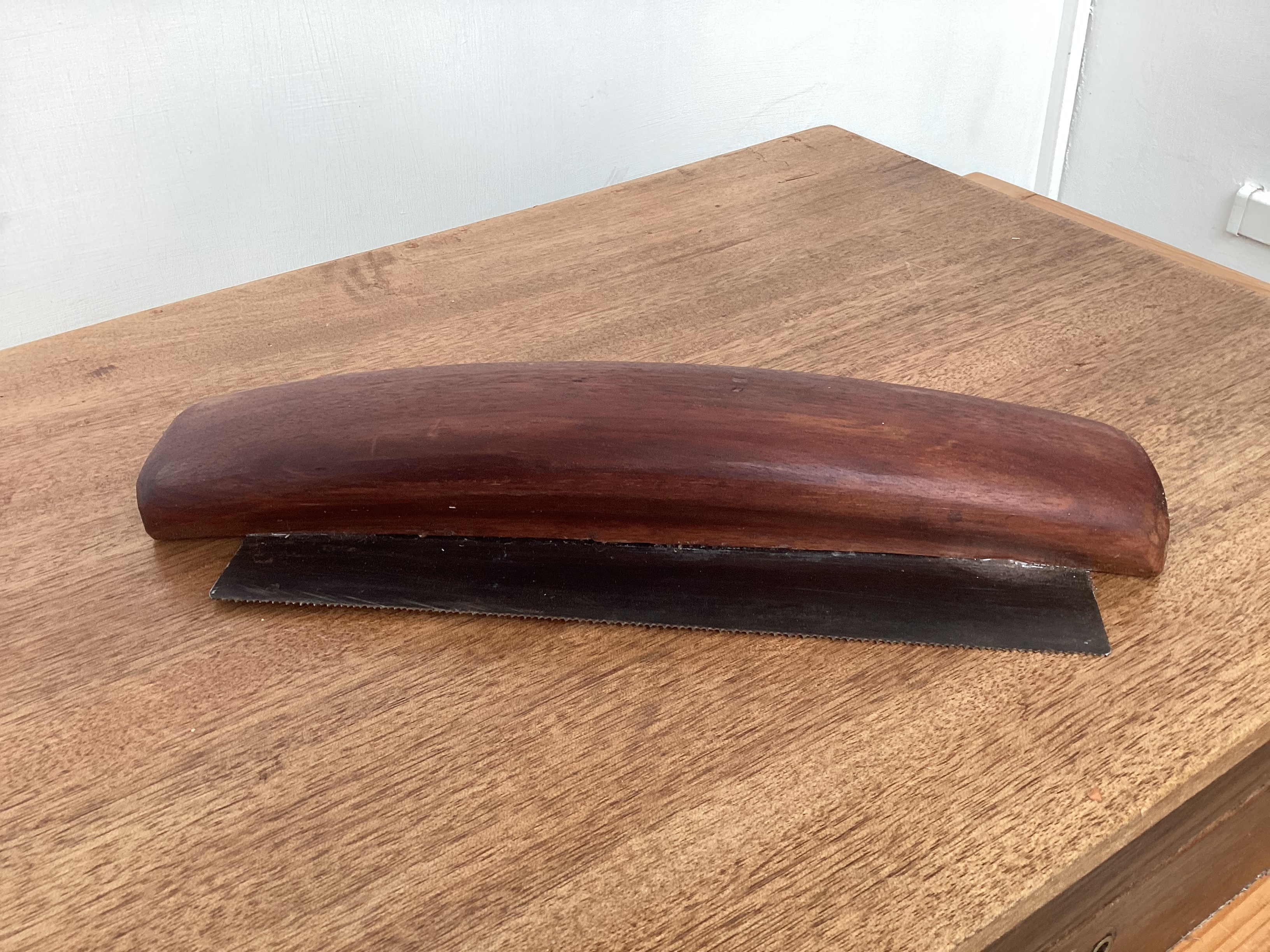

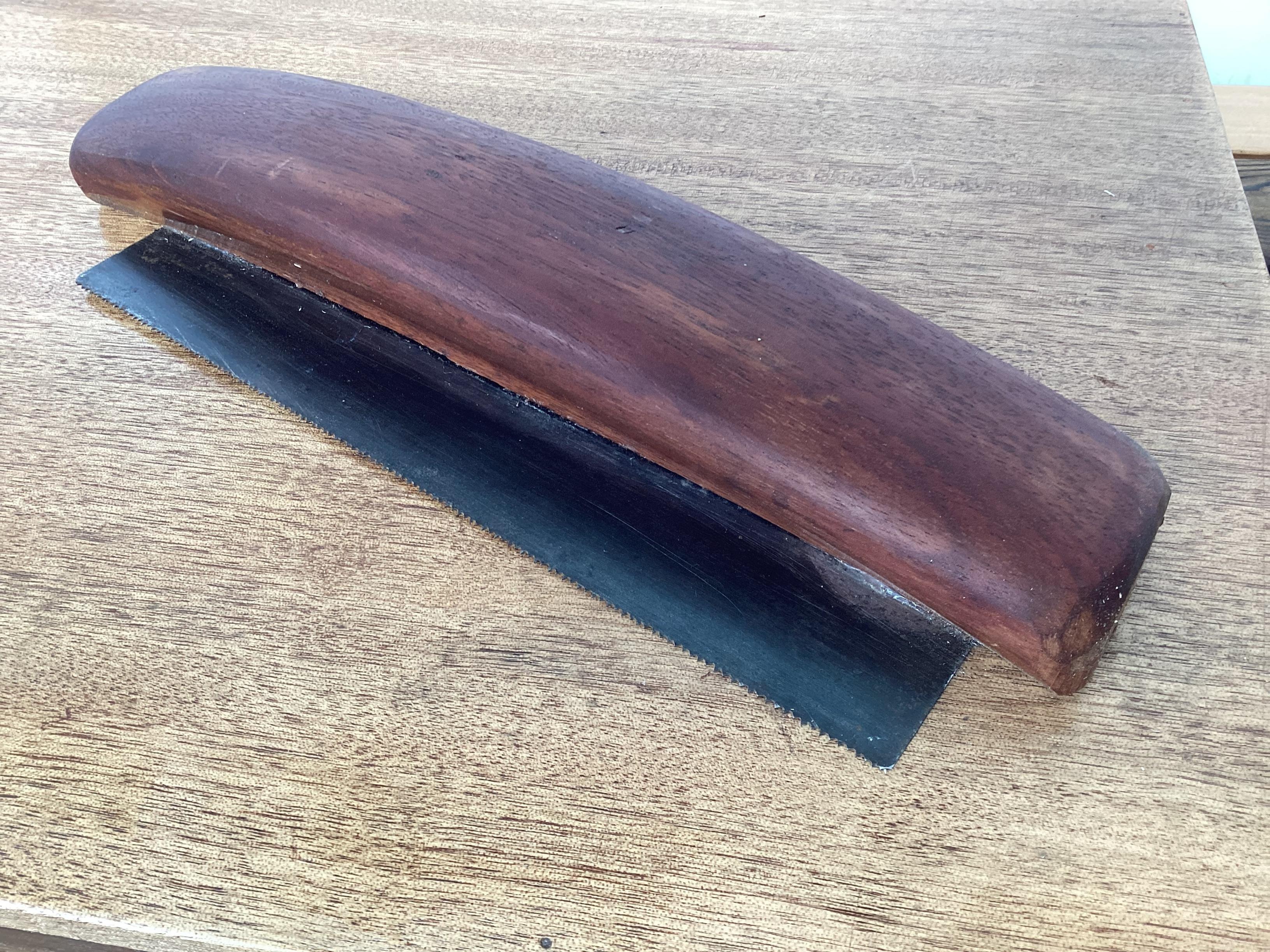

The moulding at the top is the one used for the saw. The blade is salvaged from an old 10” tenon saw, which had a broken handle, but a brass back. I modified a masonry bit to drill 4 holes in the blade, after forming a shallow rebate for the blade. Having inserted the screws, the heads were sanded flush.

The white you see in the wood is a bit of plaster to fill a dead knot.
It was made right after making the sign, so didn’t take long, I was already knackered from putting away the things to make the sign.
