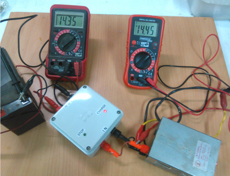

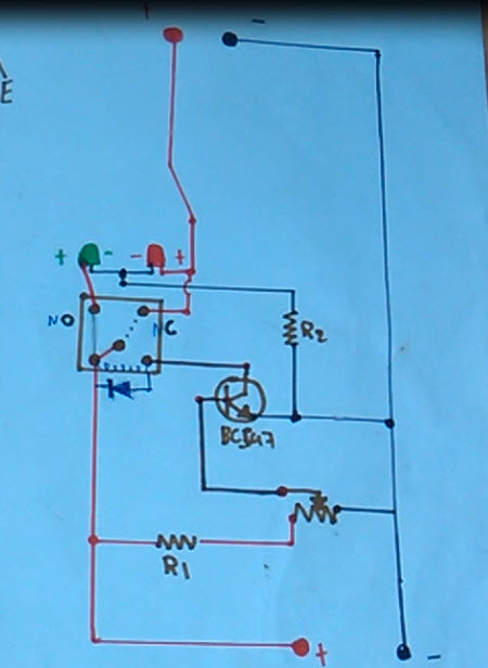

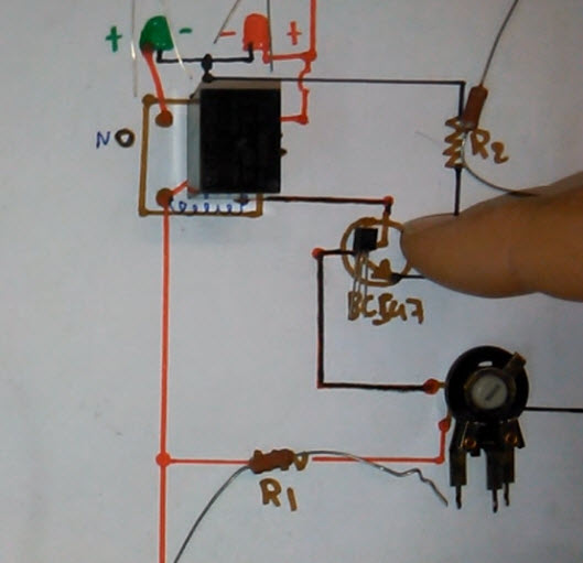

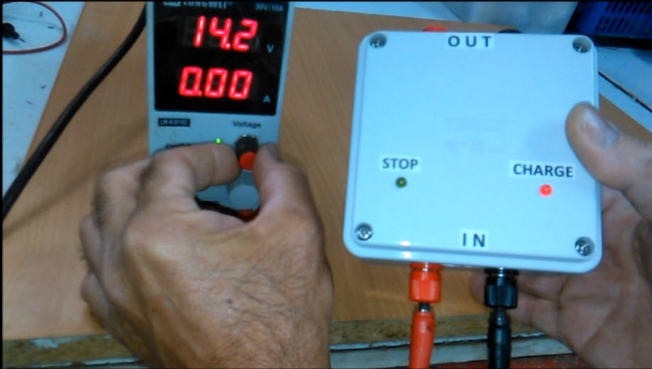

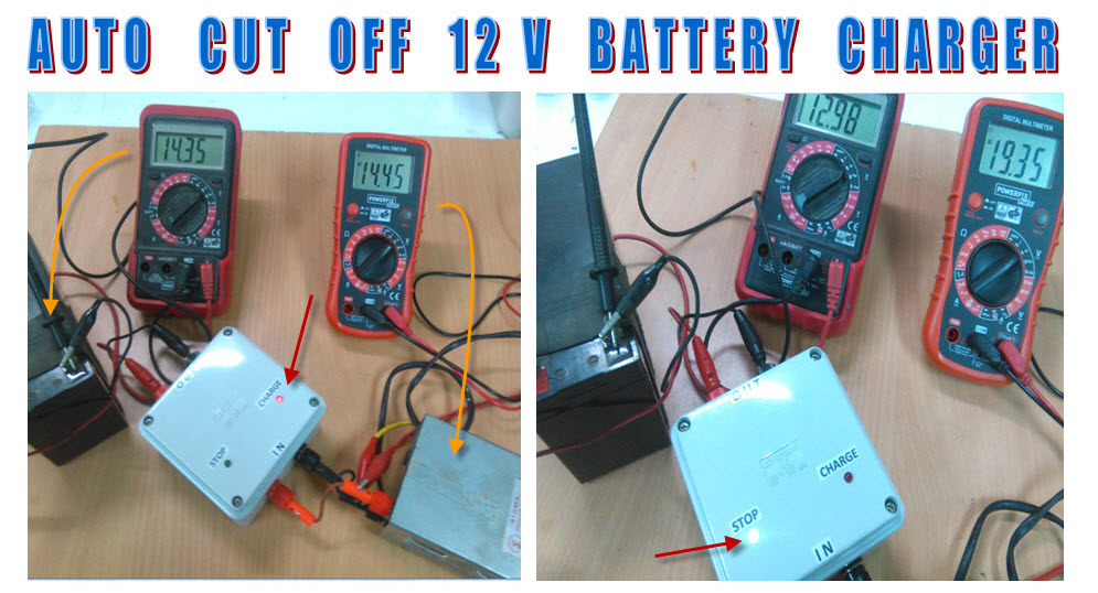

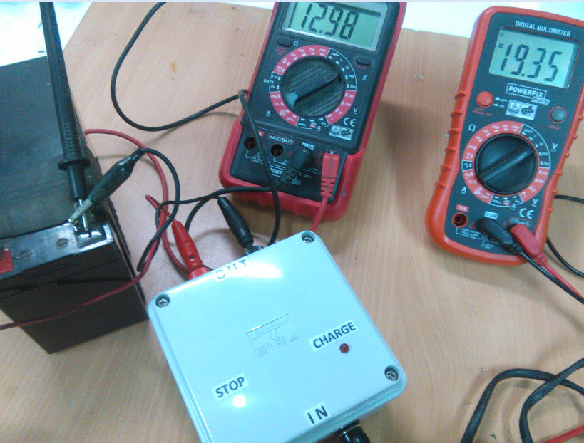

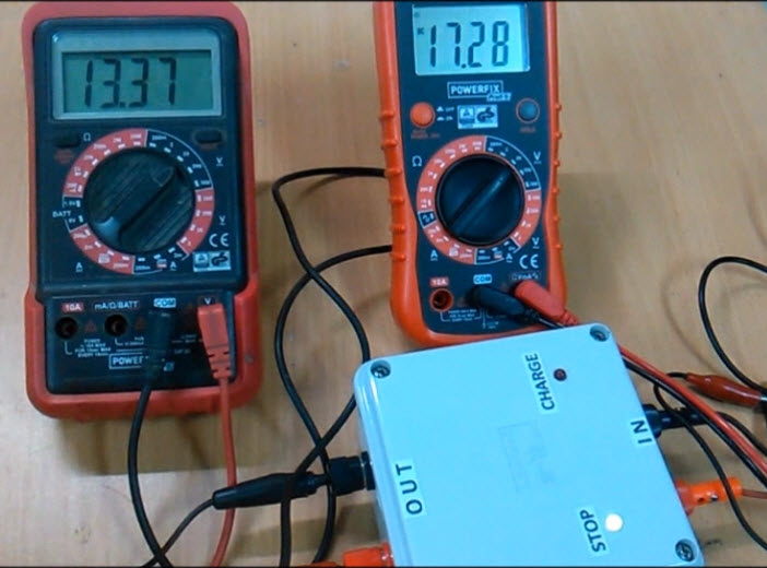

    AUTO CUT OFF 12 V BATTERY CHARGER
    An easy and cheap construction to protect our 12 v batteries from over charge voltage. The max voltage to charge a lead–acid 12 V battery must be 14.7-14.8 V.
    YOU CAN WATCH THE CONSTRUCTION AND THE USE HERE:
