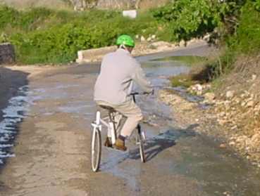

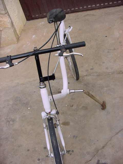

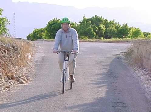

Here are some pix. of an extreme case of offset wheels.
Attachment 16770 Attachment 16771 Attachment 16772
I built this coasting bicycle for some experiments with 2WS, I could change the steering ratio but also change between same sense and opposite sense steering. These pix show it with same sense steering with which I could happily ride it with the wheels almost, but not quite, laterally disposed. That bike was a hoot to ride, impossible without a huge smile on your face.
