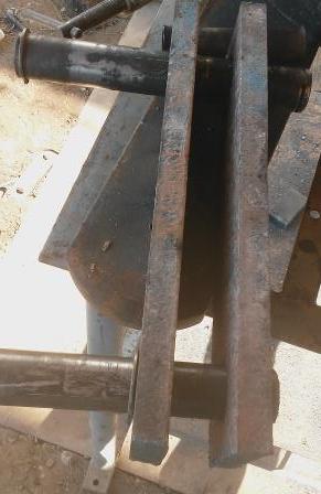

Recently a customer and close friend of mine placed a Ford 755 backhoe in my custody for life as he stated it All I needed to do was get it running and take care of the upkeep.
Well It hasn't been used but once or twice since I borrowed it briefly about 18 years ago to dig a storm cellar at my house.The last time it was started was 6 years ago. Anyway long story short it only took a short time to get it running and hauled to my place. It was then that I decided that I wanted a quick release attachment for the hoe bucket as I plan on building a mesquite root grubbing bucket for it and attaching my 6 ft hydraulic flail mower that I salvaged

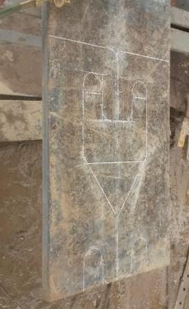

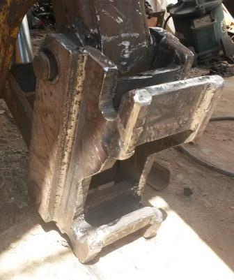

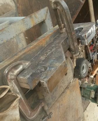

To start out with I had a hunk of 1" ASTM 514 (T1) steel left over from some previous job Perfect use for it I thought.

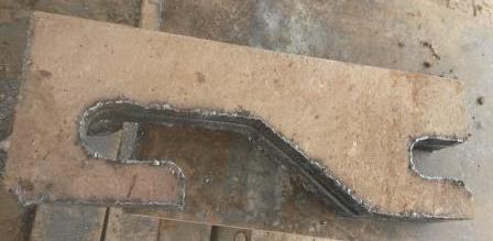

first I laid out the side pieces and some other bits than hand torched them into parts.

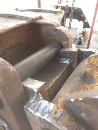

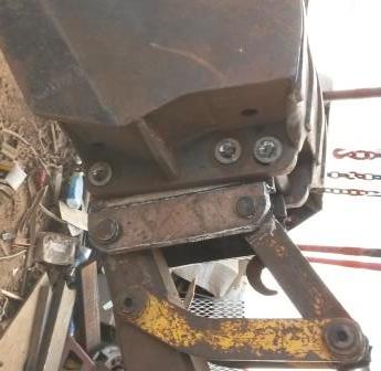

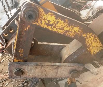

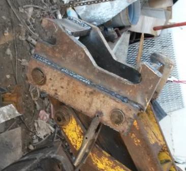

Attachment 13388 Attachment 13389 Attachment 13390 Attachment 13391 Attachment 13392 Attachment 13393 Attachment 13394 Attachment 13395
For the lock for now I took the easy way out and used the 3rd hole in the bucket latter on I may add a flip lock inside the attachment for the times when a bucket I might be using doesn't have 3 pin locations
Attachment 13396
