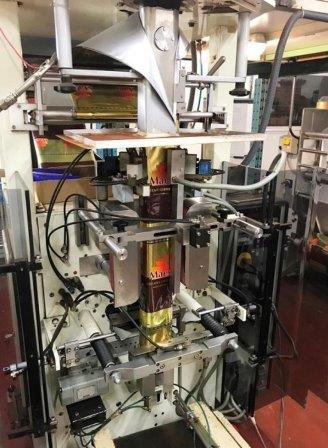

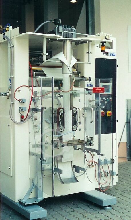

    I worked for a while at Nestle, the factory produced and packaged Nido powdered milk (not the alleged milk factory Bombed by the US in Iraq, Nestle didnt produce powdered milk outside of the UK and yet the news loved to show the cans and bags of Nido lying around the bombed out building). The machines responsible were 2 made by Bosch and an old girl made by Rovema which we lovingly called the rocket launcher on account of its shape. In its life it had packaged tonnes of powdered milk and was barley ever turned off. Thes pictures are of similar Rovemas but not as i remember the old girl. It was like a huge cast iron thing painted white ish.
    Attached Thumbnails Attached Thumbnails Bagging milk in the 1960s - GIF-4632948.1597836363__.jpg   Bagging milk in the 1960s - GIF-used-rovema-v250-sachet-machine-m1903209314-1.jpg

    The film passes over the collar and is joined using a vertical hot iron, a horizontal Irons and blade at the bottom of the formed bag seal the top of the bag thats filled and the bottom of the bag thats filling. When the heater jaws open the cut bag drops (the bottom of the next bag is already formed). The bags dropped onto conveyors and taken to Bosch packing machines. It picked up a flat cardboared box and using a series of steel tines folded and glued the base of the box, the bags of milk dropped in off the conveyor and the box then traveled through anothe couple of metal tyne which folded the box shut + a squirt of glue. Cant remember how many packs per box or boxes per pallet layre but they travelled into an old palletiser which was like an elevator as a layre was built up the layre would lower untill a full pallet was made up. The paletiser was interesting as it used a cam for its control logic. Like an old music box. It had a series of cams and limit switches to time all the machine functions, it was a bit of a bitch to be honest.
