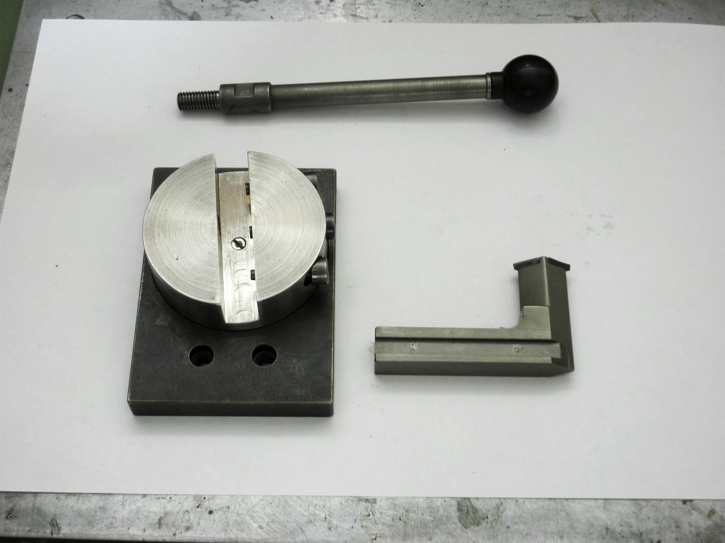

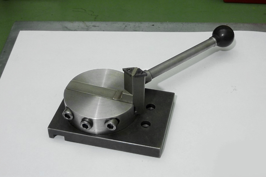

Hi again,
The ball and radius turning attachment is the very first tool I’ve made for my lathe; in reality the design¹ and the making of this tool is shared 50-50 with an old friend from a machining forum here in Greece.
Attachment 29929 Attachment 29930 Attachment 29931 Attachment 29932

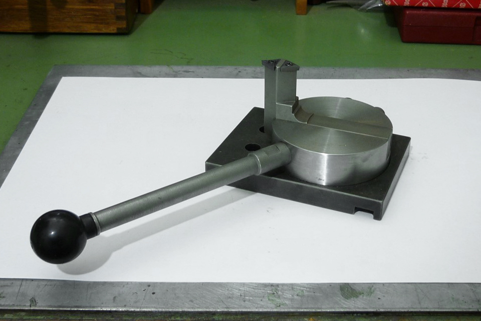

I have to mention that the size of this tool is overkilled, meaning that it doesn't need to have so wide base plate, a round body of this size as well as a lengthy arm like my tool has; let me explain a bit more.
The tool it can make a sphere up to 59 mm in diameter (it’s not wise though, to exceed the safe limit of the 50mm). So having a main body of 64.50mm in diameter and an arm with 70mm in length, the only that can give is trouble; because you will need to keep bigger distance from the chuck when you will need to make small spheres since the base of the arm will protrudes much more from the main body and could possibly hit on the chuck. Plus that you will have an overhanging part, with more flex and vibrations (depending on the diameter of the material in use) as it will want to climb on the cutting tip especially on potential deeper cuts.
To sum up, if you have a lathe similar with mine and you interested to make this tool, I suggest you to make the main body somewhere around 55mm in diameter, a base plate with an appropriate size so to accommodate the diameter of the body and as for the arm must not exceed 60mm in length.

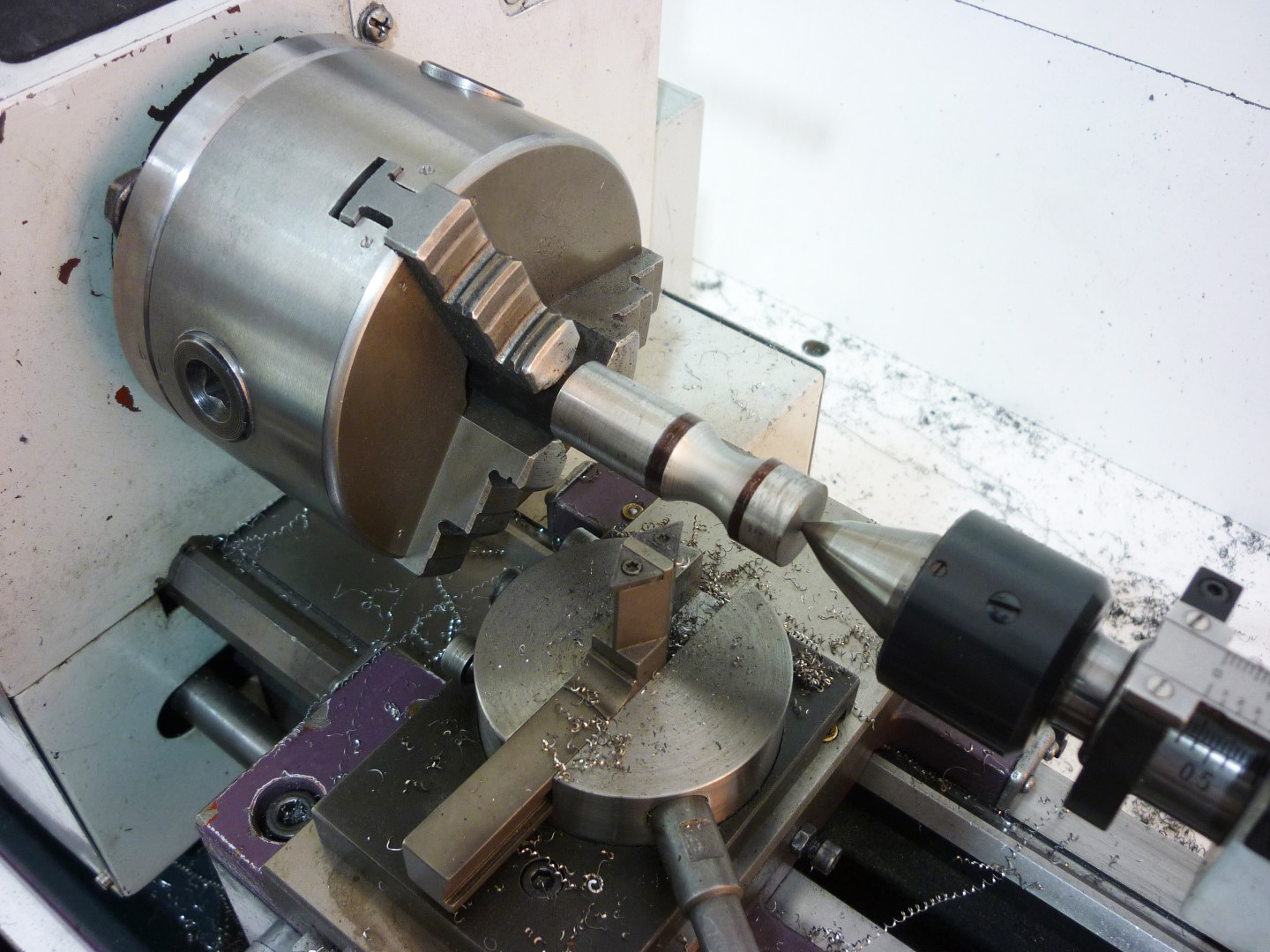

Attachment 29933 Attachment 29934

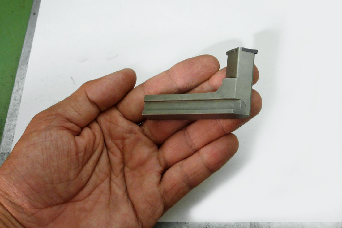

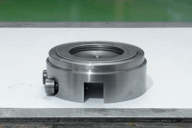

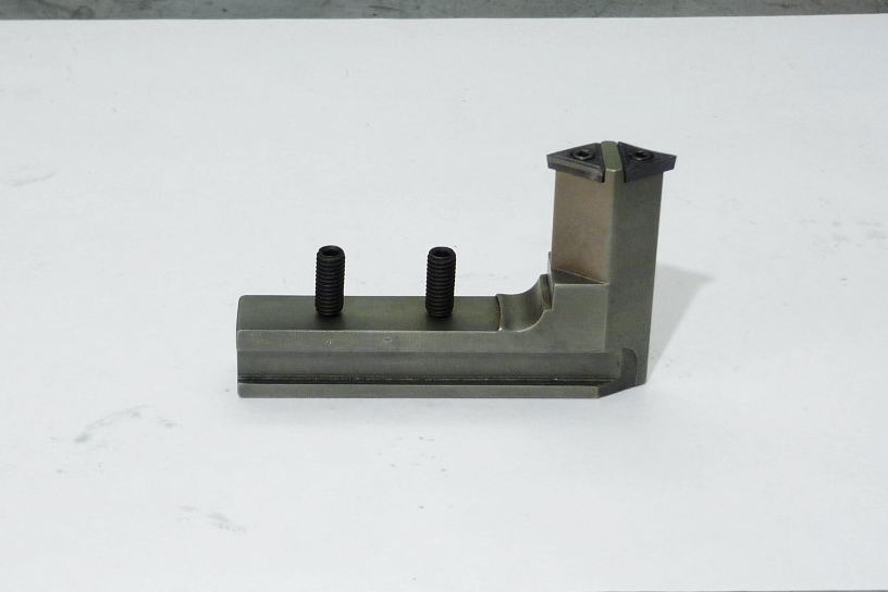

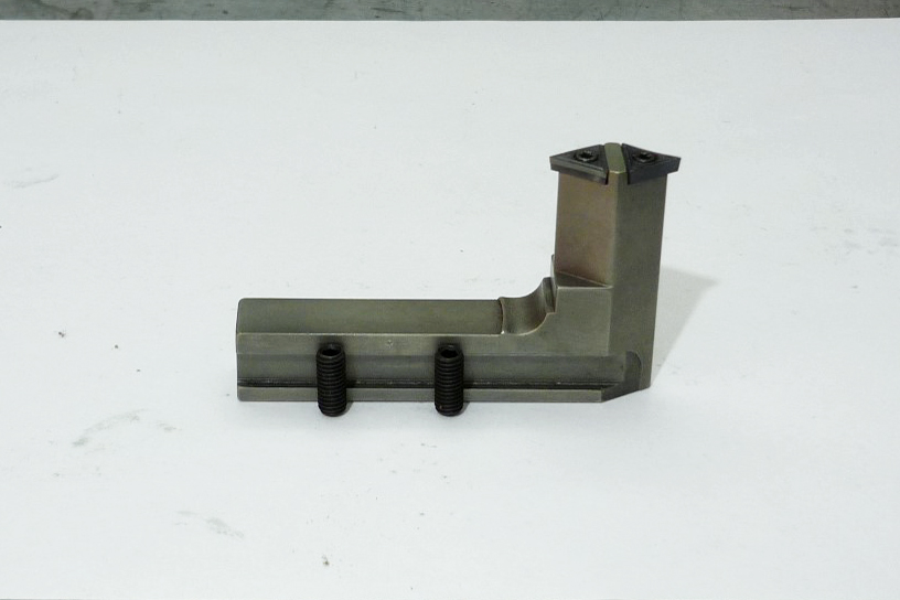

Now, one of our mistakes was that we didn’t think to draw and make a second slot³ on the base of the arm so to make it more secure when I wanted to reverse it for turning radiuses.

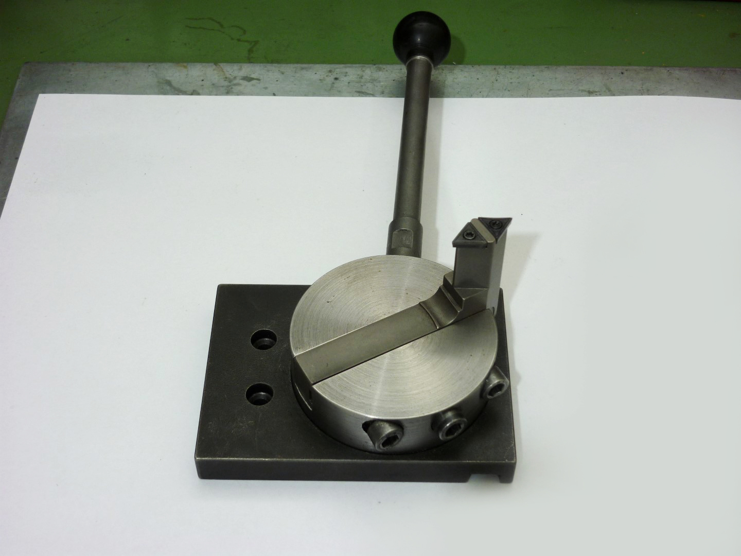

Attachment 29935 Attachment 29936
As I said before the dimensions of the tool are for my lathe - Optimum D180x300 – having a center height² of 90mm; I have heard though for slight differences on the center height (+/- 1mm) in the exact model of my lathe from other hobbyist.
So, in order for you to set the cutting tip precisely at the center height of your lathe I suggest you to do this: drill and tap two holes on the base of the arm for a 5 or 6mm set screws (it is important that the height of the set screws to not exceed the height of the arm’s base).
Attachment 29937 Attachment 29938
Something that it’s also important, is that if you use set screws for height adjustment and you planning as well to make the side slots³ on the arm’s base, you must not forget to leave enough clearance for the up and down movement so the locking screws on the main body will not interfere while adjusting the height.
Another advantage of using set screws for the height adjustment, is that you can set the cutting tip so as to have a positive, normal or negative rake (depending on the material you will turn, the size of the sphere or the arc you going to make and the depth of cut).

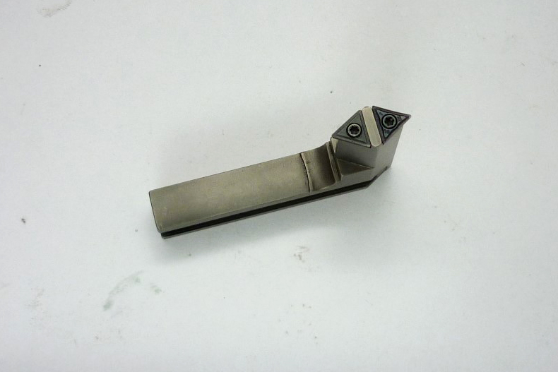

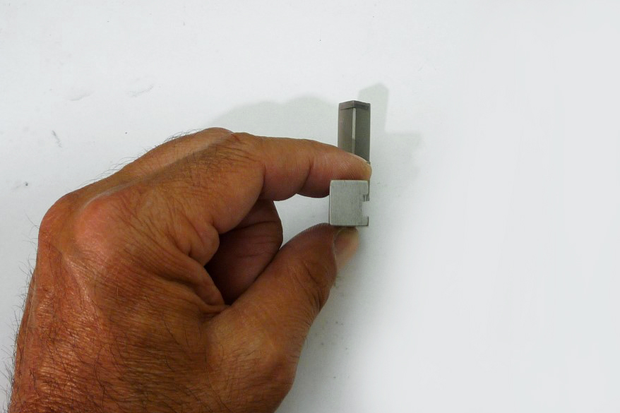

I use TCMT 110204 carbide inserts for my tool, but it’s up to you what insert you want to use since that you can change the dimensions after you download the drawing.
Attachment 29939

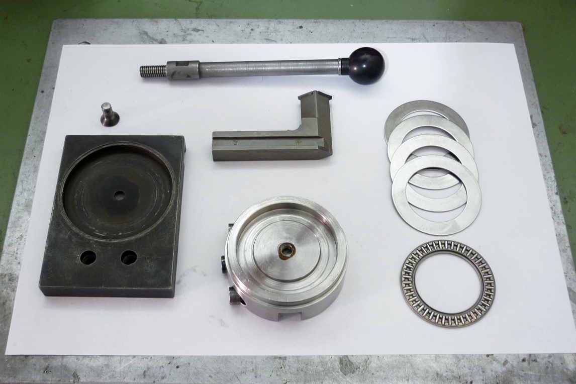

The arm is the only, heat treated part (case hardened)

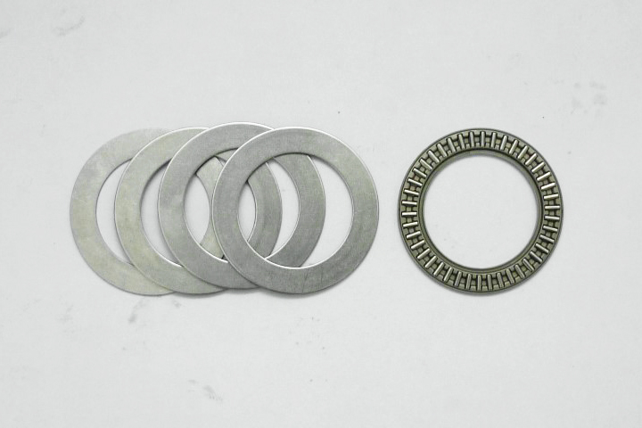

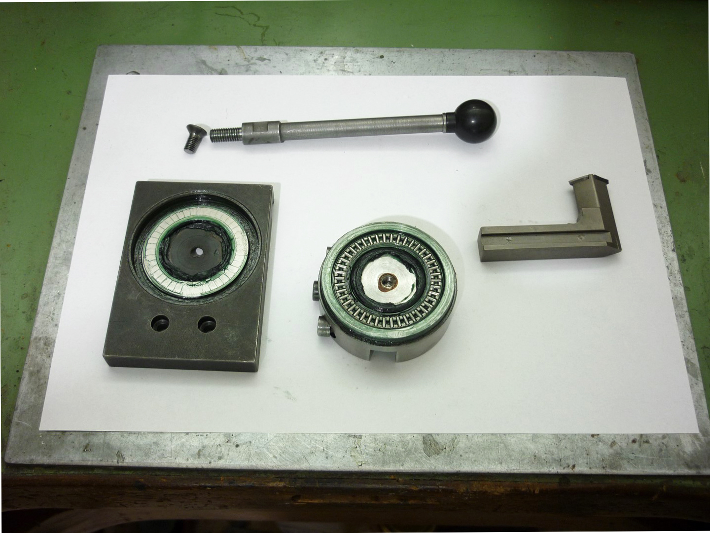

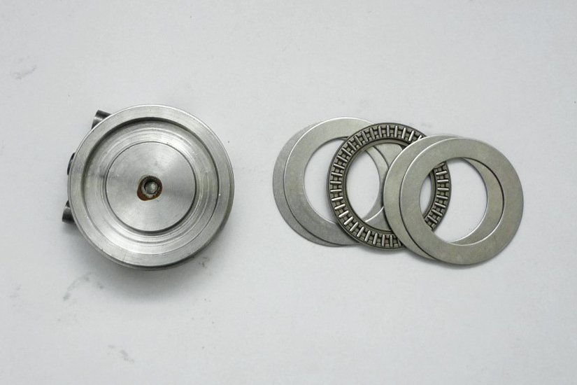

The bore at the bottom of the main body was initially designed for using a 51107 thrust bearing but without the supplied washers, but I changed it because I realized that the hardened balls could wear out the base and the body with use. So, I used an SKF needle roller thrust bearing with 2 washers for each side (total thickness 6.0mm) so to reach the right height as the main body will set in the base plate as well as to have some clearance for preloading, that means that I had to decrease the depth of the bore by taking a cut at the face of the shoulder, so the depth of the bore became 5.93mm (I hope that this makes sense).
Attachment 29940 Attachment 29941 Attachment 29942

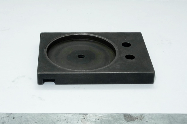

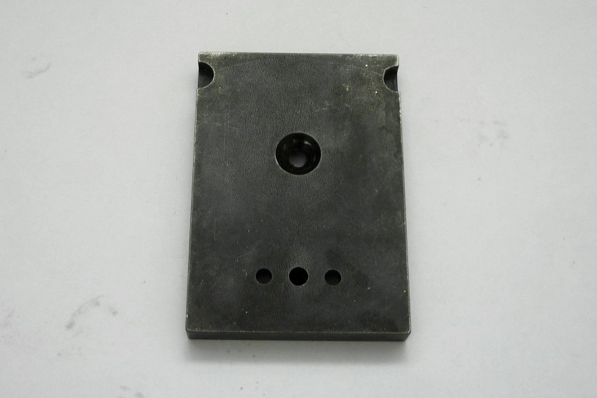

One last feature we’ve added to the design of this tool is the tiny shoulder on the base plate for keeping the movement of the body free and the bearing clean from metal chips or any other debris from turning.
Attachment 29943
The two hemispherical pockets you see on the upper corners on the bottom of the base plate, is for setting the base without to interfere with the oilers of the cross slide, something that you will not need to do if you make the base smaller in size.

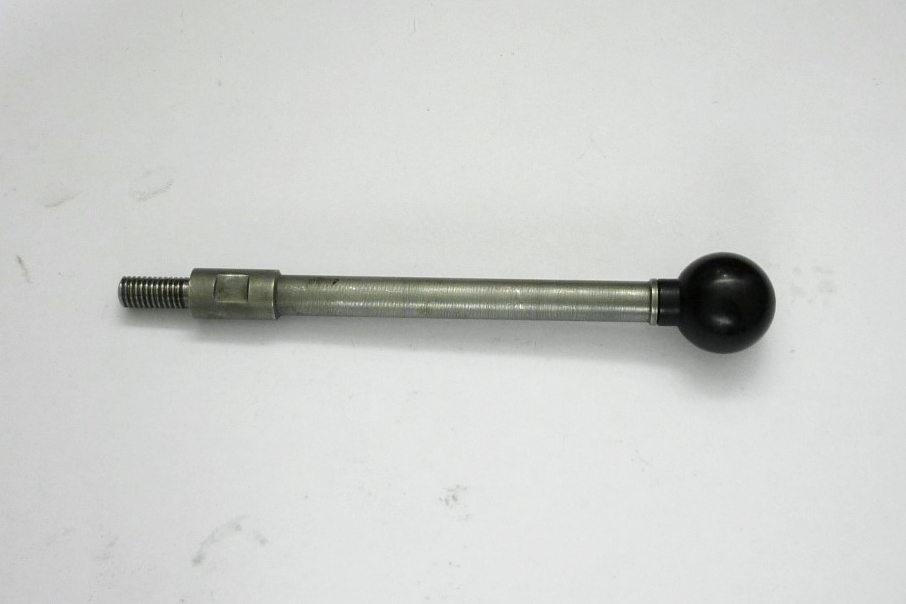

As for the plastic ball on the handle...that was the first thing I've made with this tool.

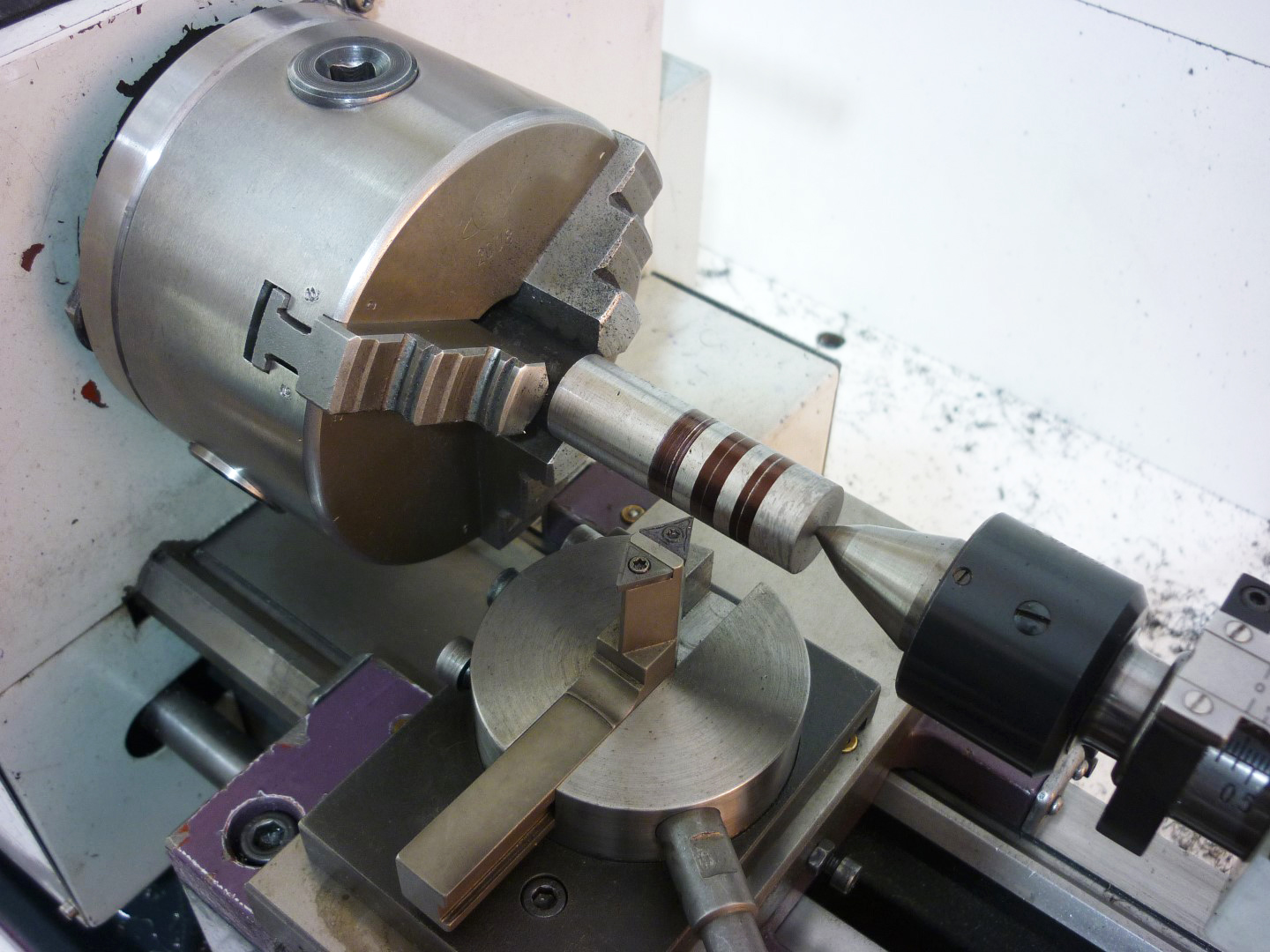

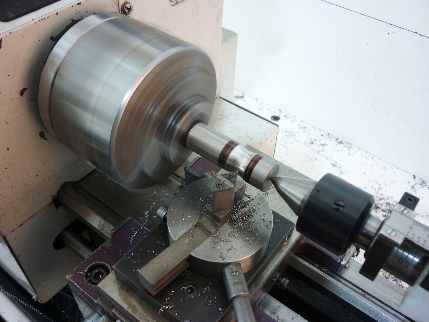

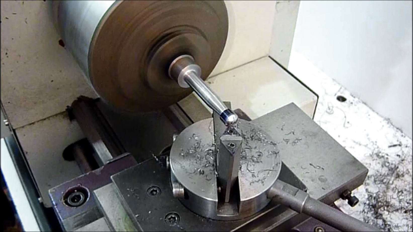

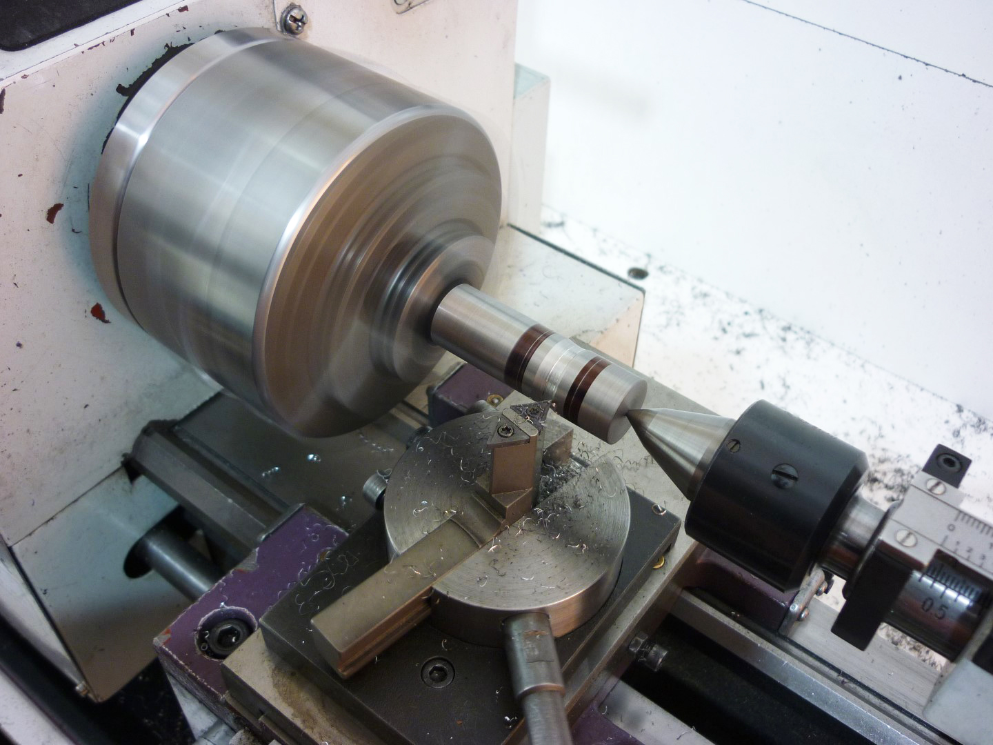

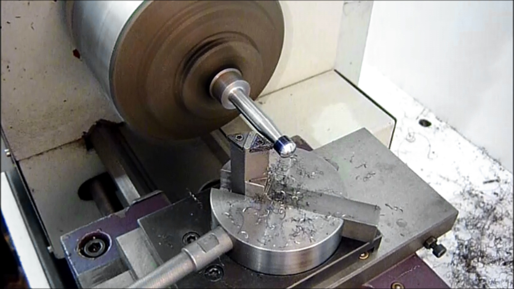

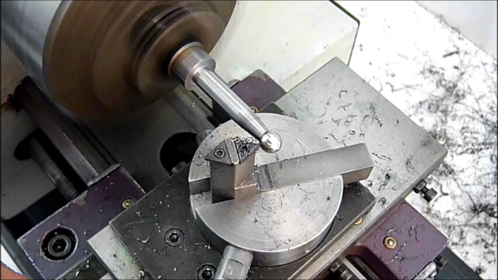

Here are some pictures with the tool as it used
Attachment 29946 Attachment 29947 Attachment 29948 Attachment 29949 Attachment 29950 Attachment 29951 Attachment 29952
