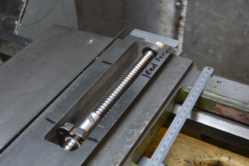

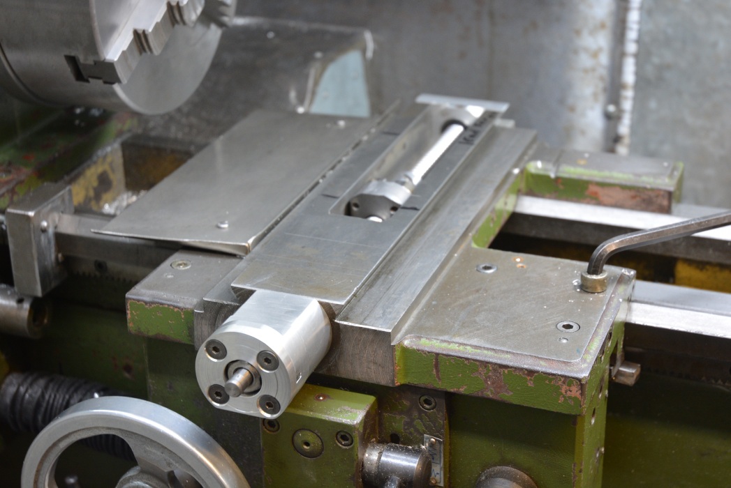

    I did not start out to build this but the project just grew. Some time back I converted the cross slide ACME screw to ball screw. That is described in this previous HMT post
    Lathe cross slide conversion to a ball screw
    Ball screw and electronic lathe conversion-ballscrew_21.jpg Ball screw and electronic lathe conversion-ballscrew_23.jpg Click images for full size.

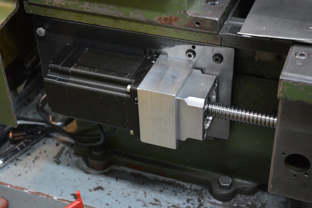

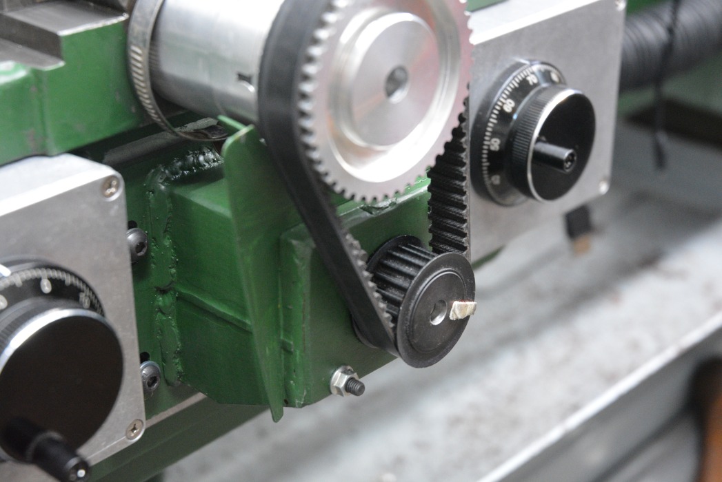

    I was so pleased with the smoothness and precision that I decided to replace the main Z axis leadscrew also. The ball screws do not have half nuts so it meant that it would have to be motorised and that meant that I would need motor drivers and some form of control. I thought that if I was doing that to the Z axis I might as well do it to the X axis also.
    Ball screw and electronic lathe conversion-ballscrew_041.jpg Ball screw and electronic lathe conversion-ballscrew_078.jpg

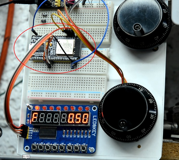

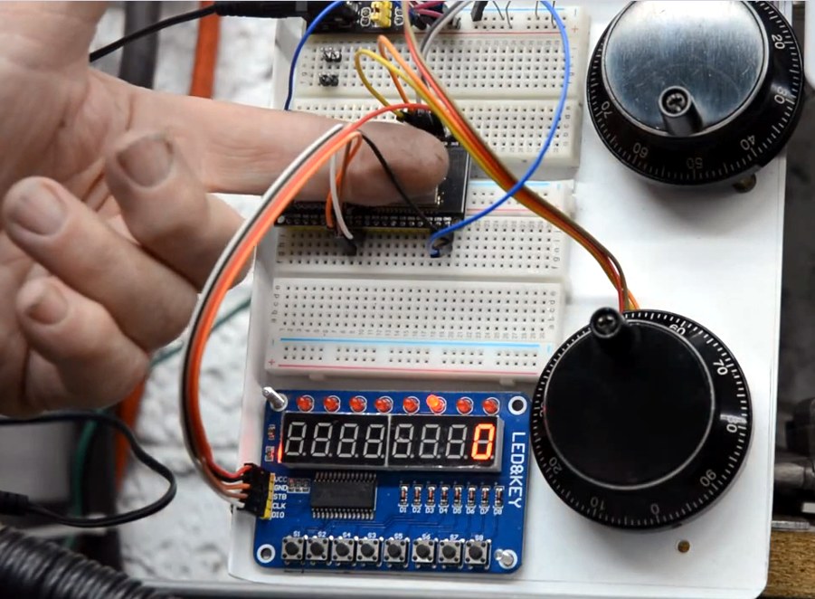

    Then I would have all the hardware needed for a CNC conversion except for a CNC controller which are available quite cheaply. I did NOT want a full CNC. I wanted to retain full manual control but with some common lathe tasks automated. The manual control is fly-by-wire controlled by MPGs (Manual Pulse Generators).
    An Arduino was my first thought for being the controller brains but the base models could not produce a high enough pulse rate for the rapid movements or the coordinated movements of turning tapers or ball ends. I chose to use an ESP32 micro, which is like an Arduino on steroids. The ESP32 is circled below and the finger shows the small size of an amazing amount of computing power.
    Ball screw and electronic lathe conversion-ballscrew_102.jpg Ball screw and electronic lathe conversion-ballscrew_103.jpg

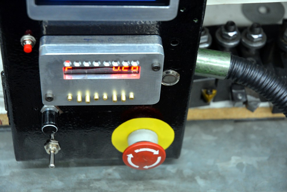

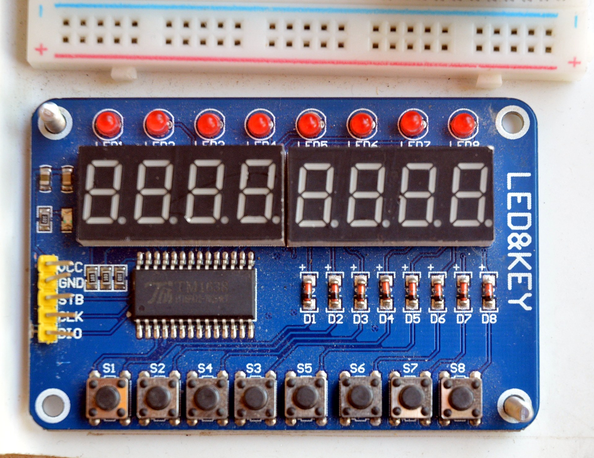

    For entering the control demands I use a small and unbelievably cheap display, "LED&KEY" with buttons as shown here.
    I was planning on using a touch screen display before I saw these. The buttons are very close together and could easily result in two being pressed together. To avoid that I made different length buttons shown in the second photo below.
    Ball screw and electronic lathe conversion-ballscrew_101.jpg Ball screw and electronic lathe conversion-ballscrew_100.jpg

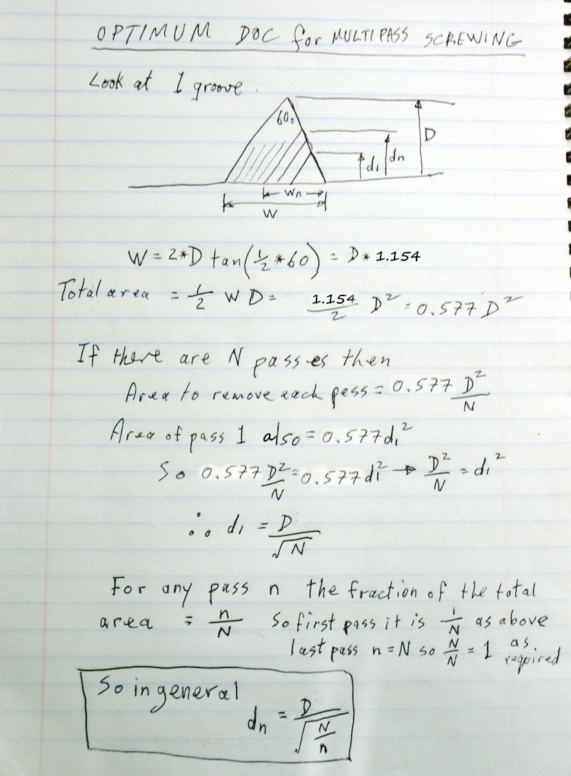

    I'm enthused with threading prospects just like that, figuratively speaking. Repair work can entail need of reproducing, more often only approximation of proprietary diameter and pitch combinations.
    You might like a feature that I have built into the software. For multi-pass threading if you use the same DOC (depth of cut) for each pass then you will remove more material on the final cut than on the first one. This is obviously not optimum because it means that the initial cuts are not very productive if you set the DOCs to suit the final heavier cut. I have programmed in an optimum DOC such that each pass removes the same amount of material. So the first DOC is greater than the final one but both remove the same.
    This only applies to normal triangular profile threads, rectangular shaped threads need the same DOC for each pass. In addition the tool is advanced along the Z axis for each pass to force the cutting to the leading edge of the tool, just as you would do manually with an angled compound.
    Here is the derivation for the algorithm that I included in the software, it assumes that the thread depth is small compared to the workpiece diameter.
