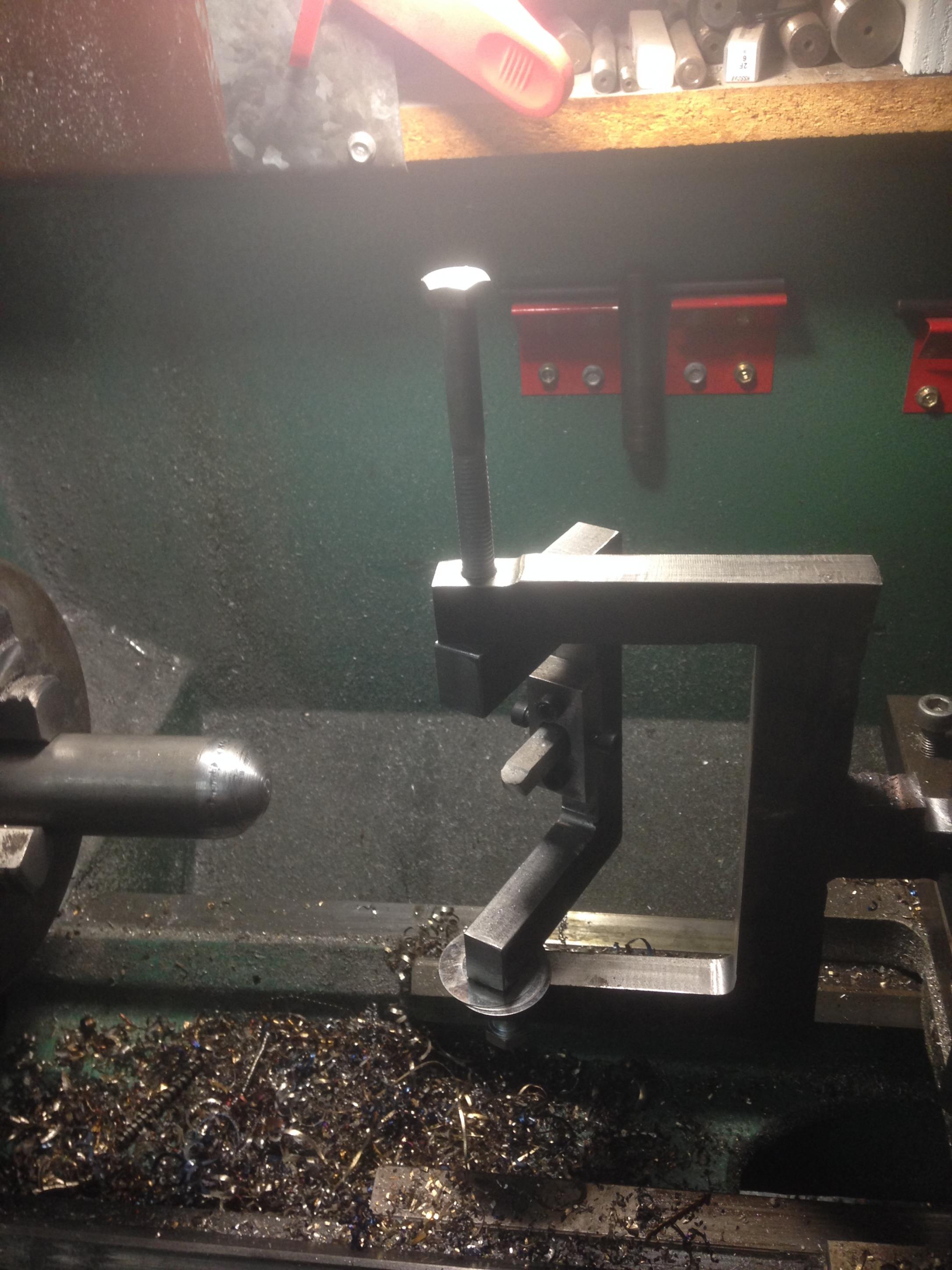

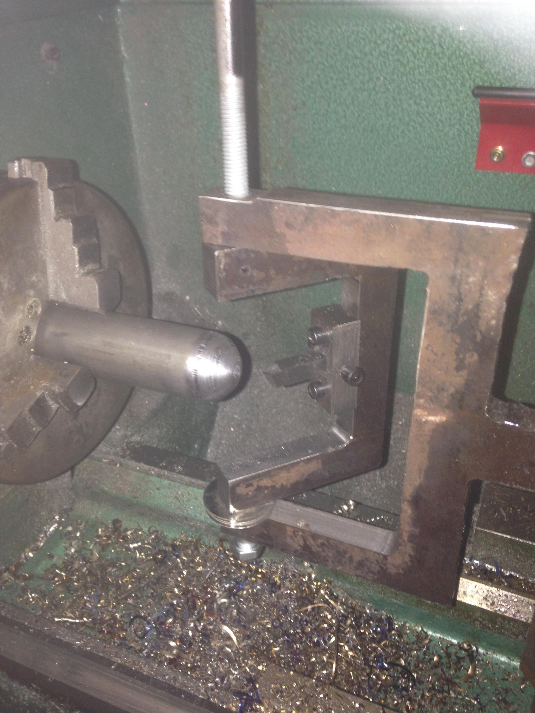

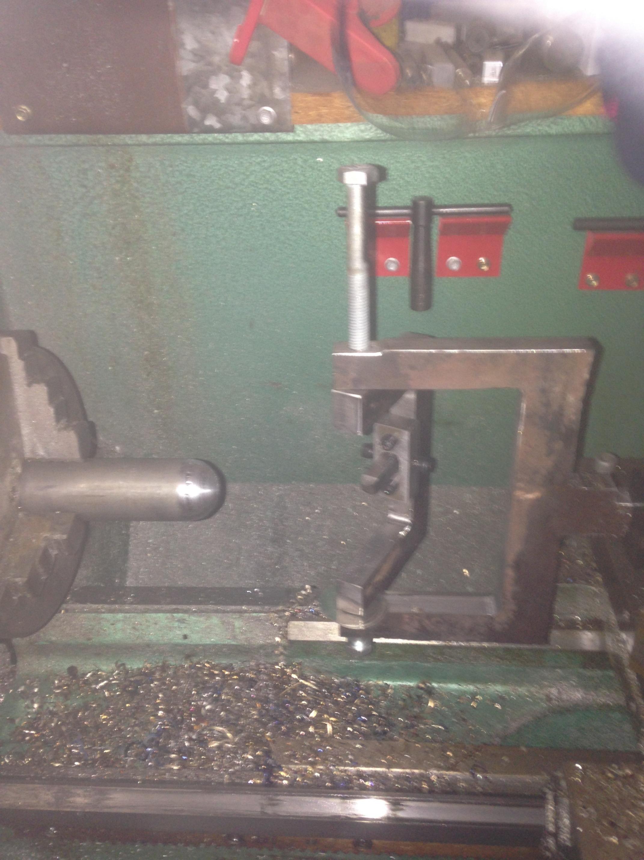

Decided to make my own ball turner.

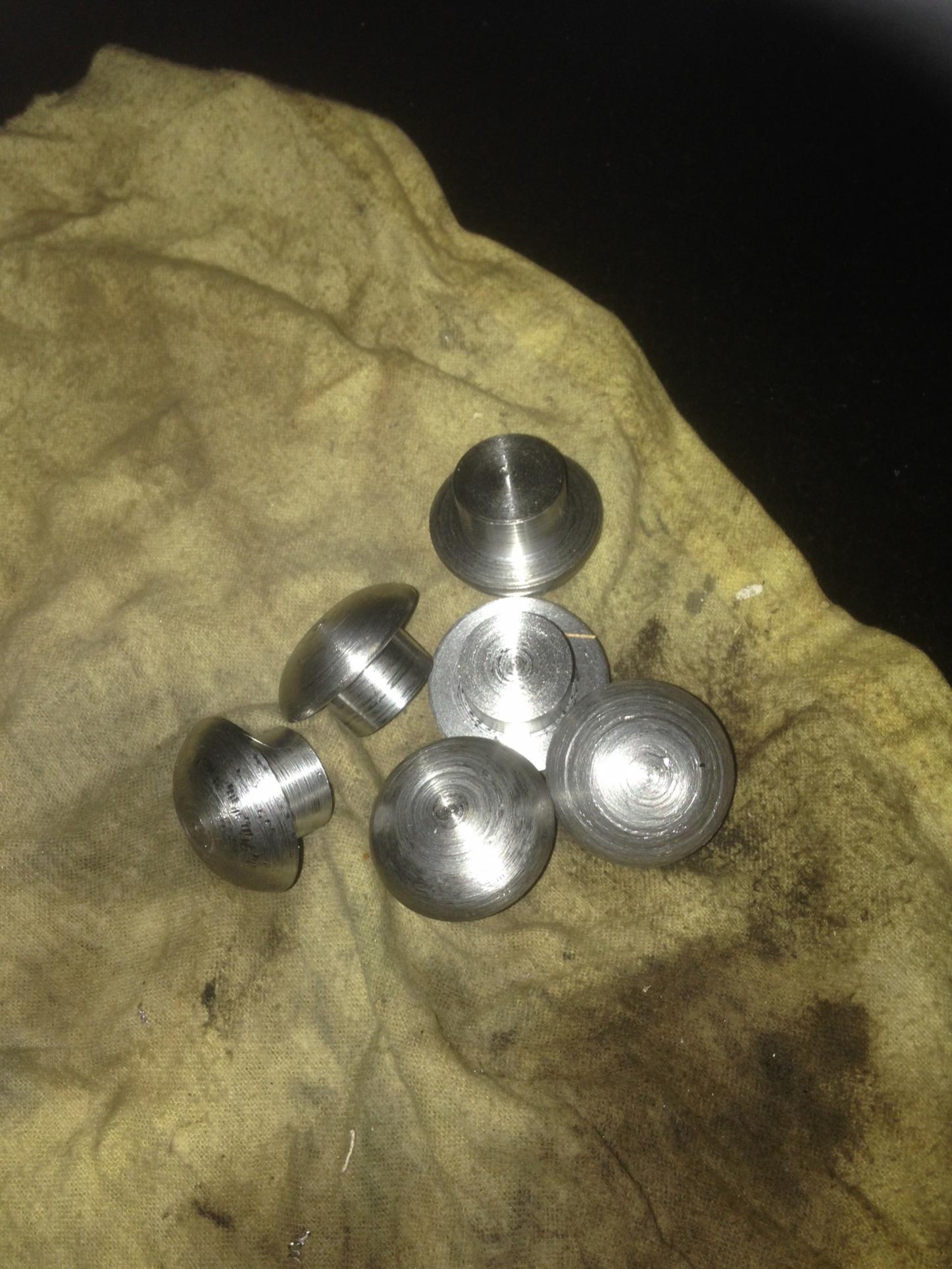

Just to let you know the rough finish was caused by chattering. The tool bit had the wrong shape ground on it and was too large.:headscratch:
