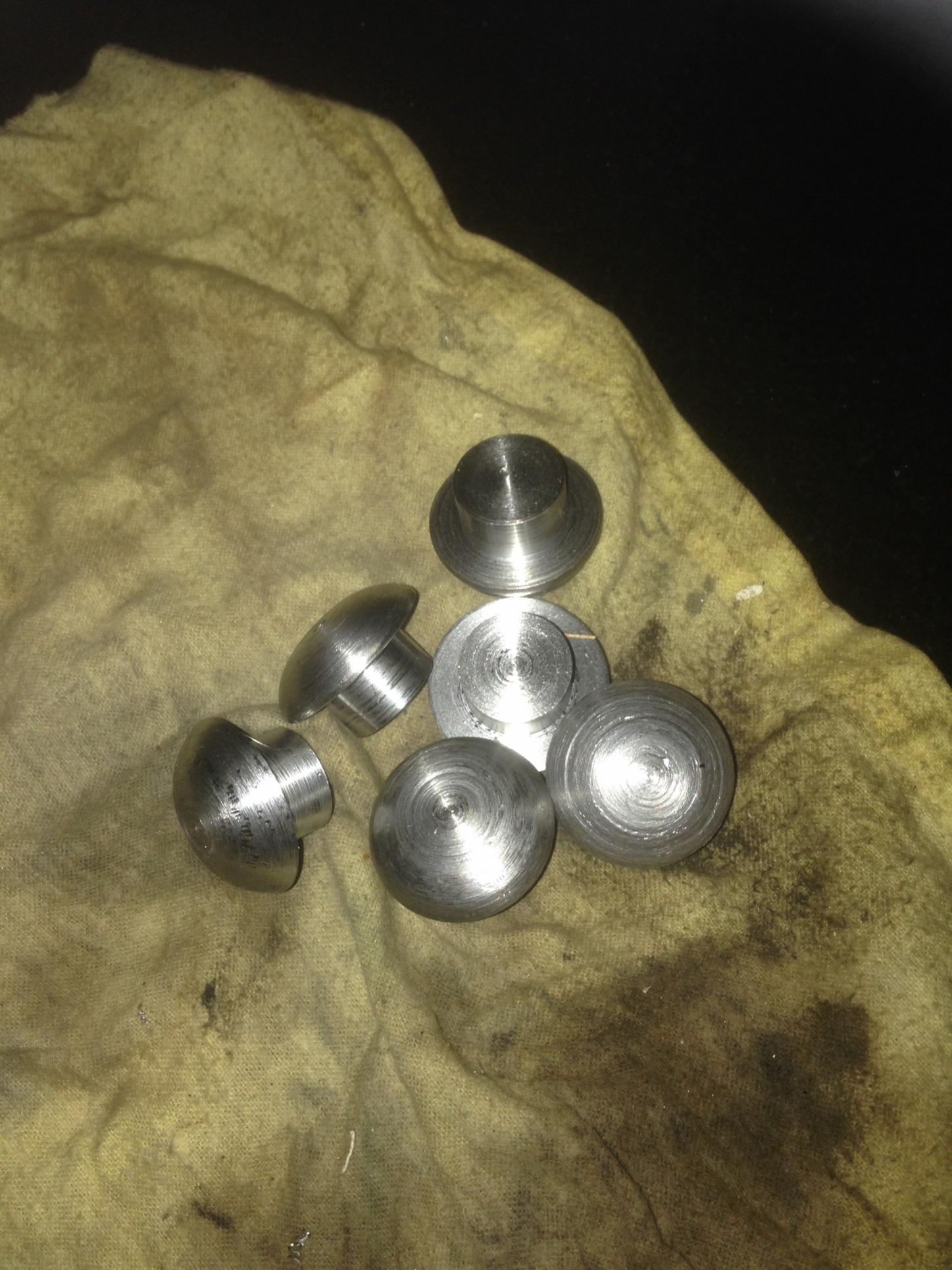

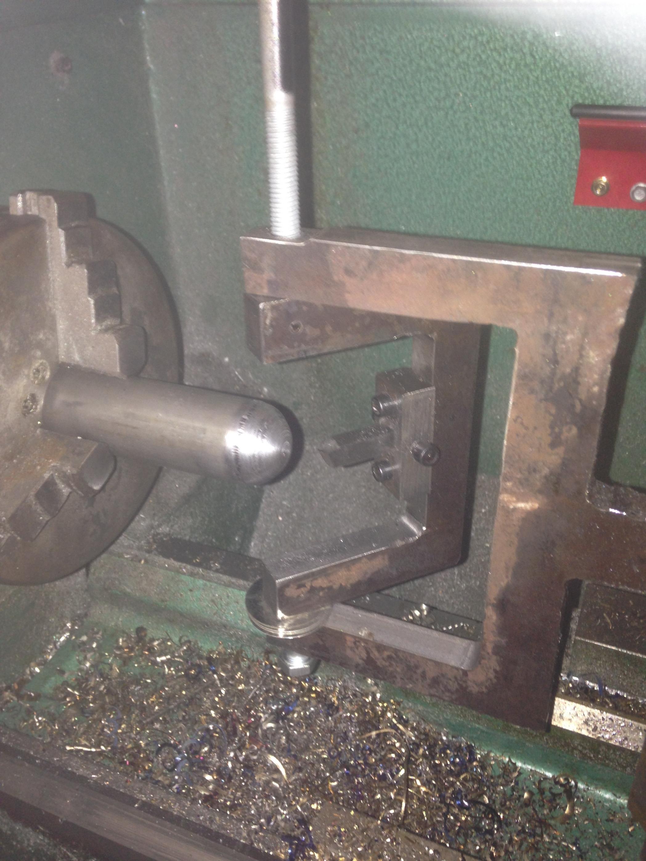

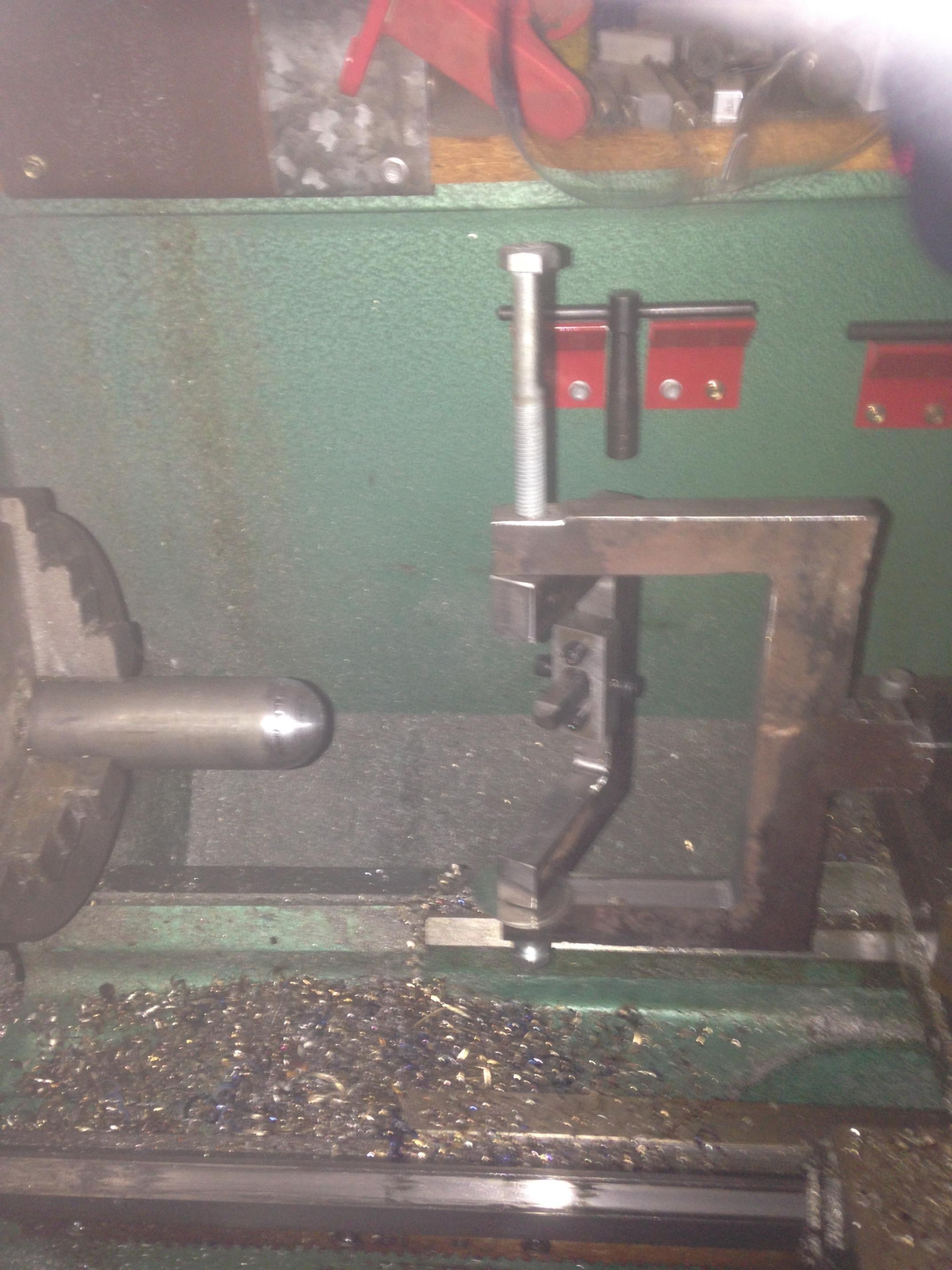

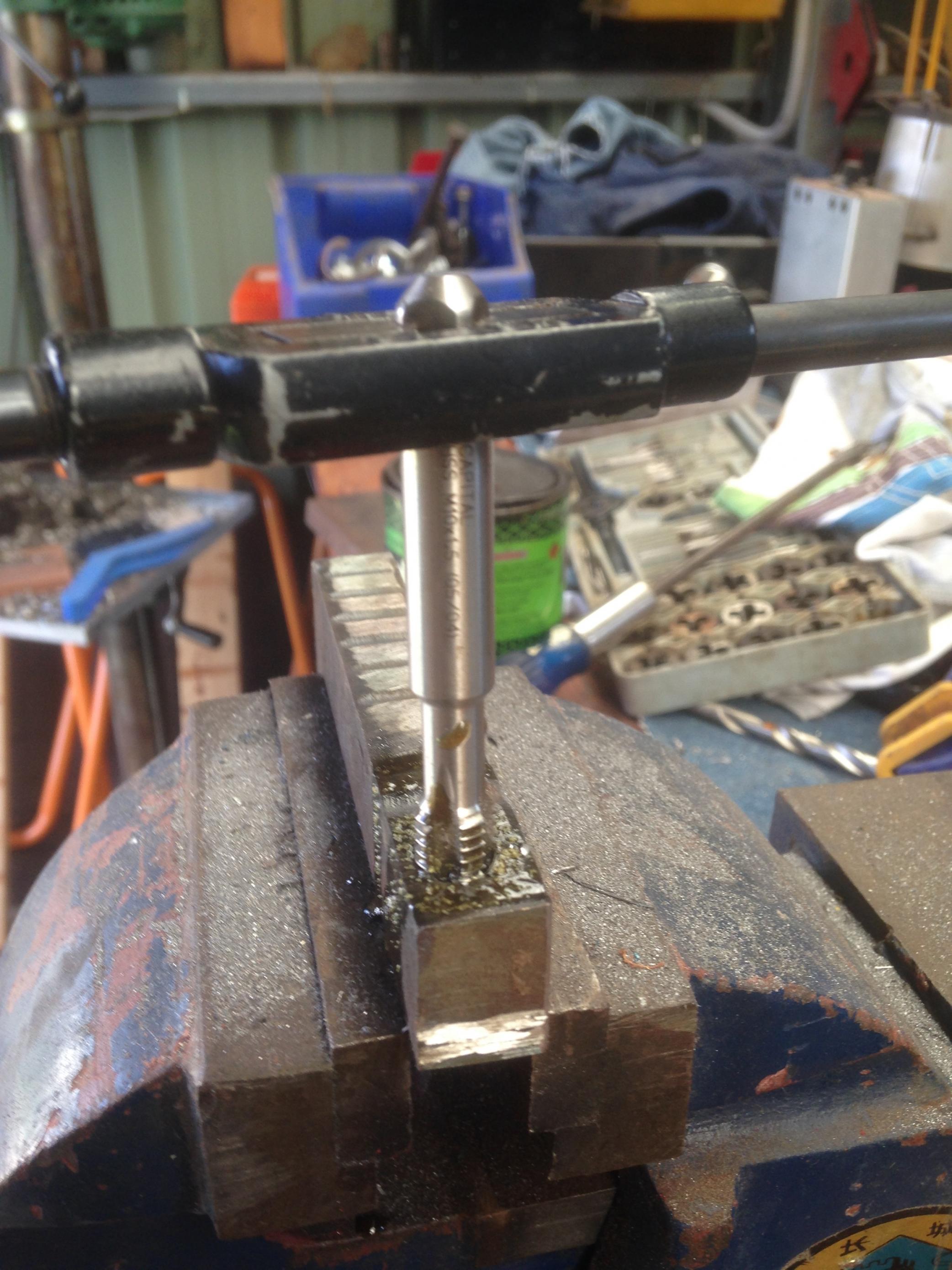

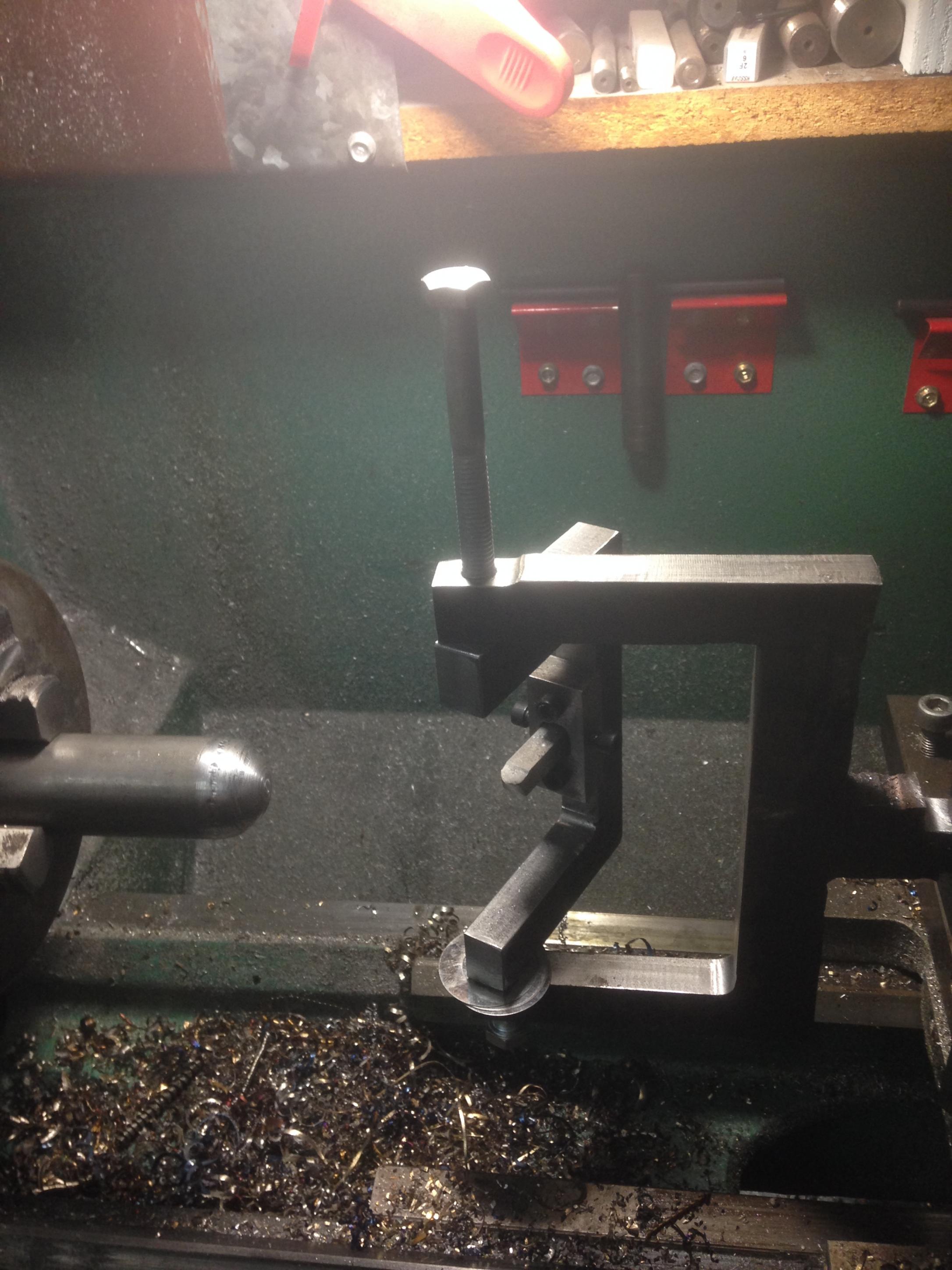

    Decided to make my own ball turner.
    Last edited by takkleberry; Aug 28, 2017 at 05:11 PM. Reason: include finished end caps

    Just to let you know the rough finish was caused by chattering. The tool bit had the wrong shape ground on it and was too large.
