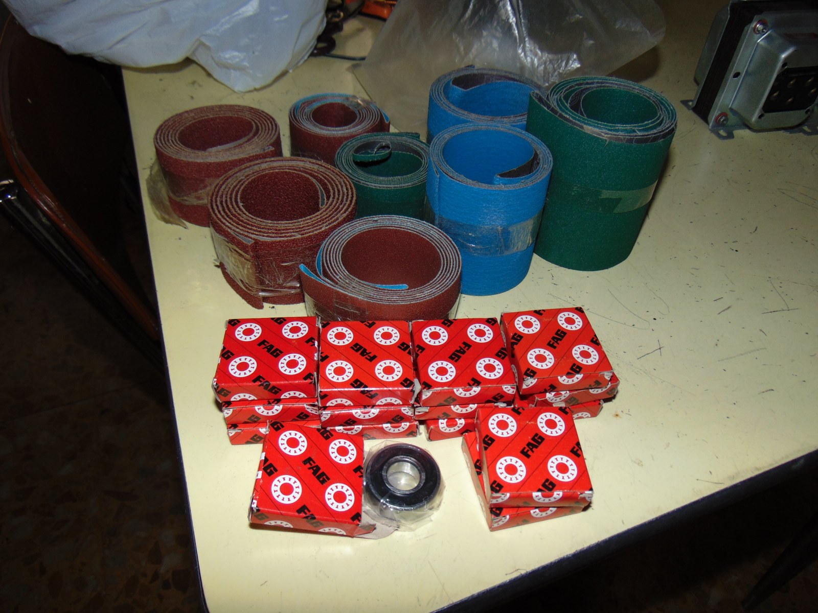

    My uncle gave me some old but good engines, among which one 1,5hp - 2800 rpm, I'm thinking about building a belt grinder. I found on local flea market some abrasive belts, from 6cm to 12cm (2,3" - 4.7") various grit, very long.

    I'm searching for 6003 bearing, hope it's a good choice. I want also to add a cotton polishing arm

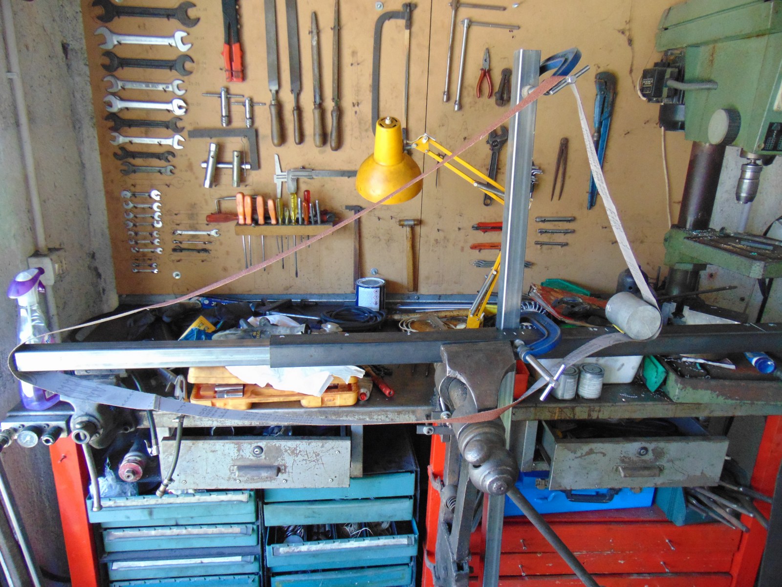

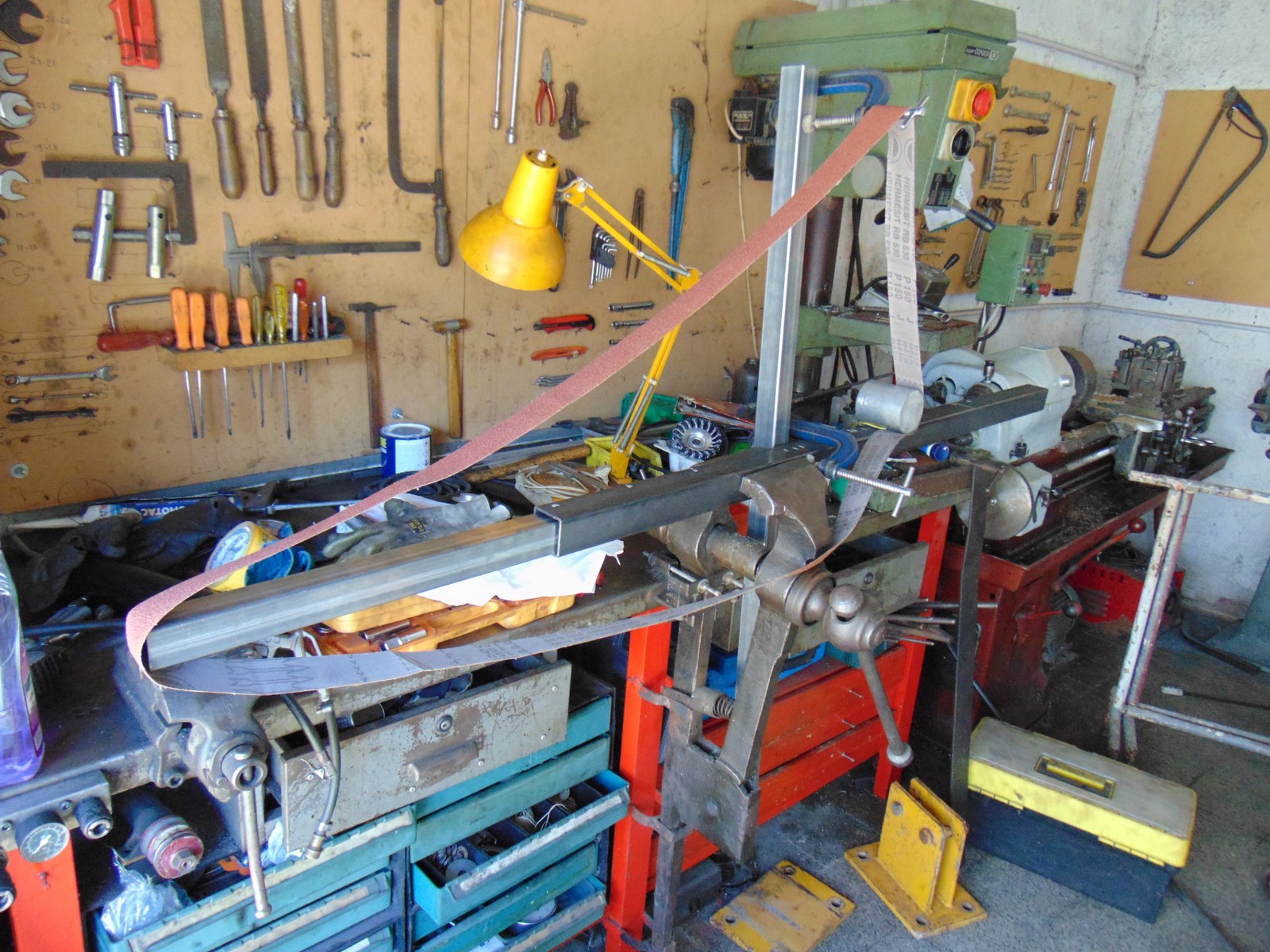

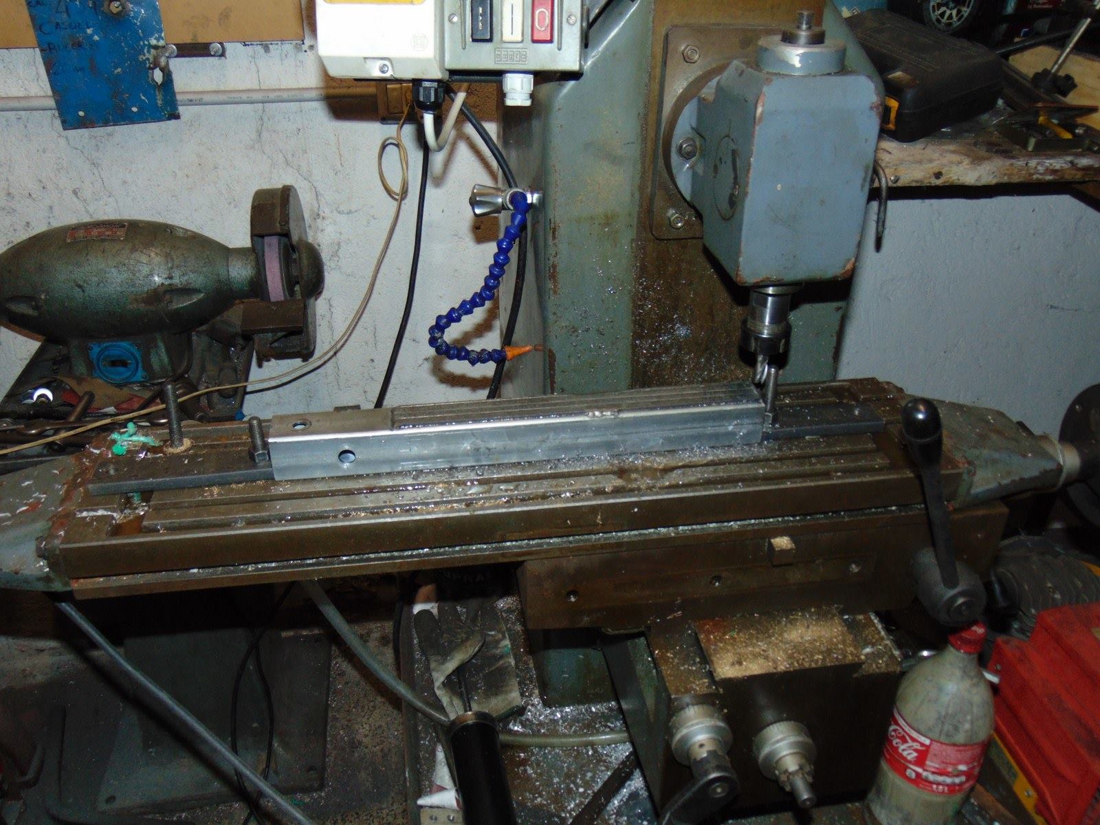

    Hi all!
    I'm starting the project of belt grinder
    I got long belts (3m - 120"), then size is not so compact, due to this point I chose to make a floor standing machine.
    I was inspired by a youtube video of a diy grinder, very well made in my opinion.
    I think I will make some attachments for cleaning - polishing.
    Central tensioner needs a spring, don't know how much load belt needs, I will try maybe with attempts.
    I'm also thinking to make a support with protractor, I have to think a good way to engrave steel
    Some good idea to make the machine better?

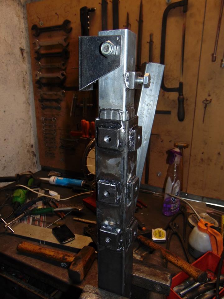

    I'm thinking about use some high density polipropilene as bel support on the double wheel final part, or maybe it's better steel?
    Next work will be build the wheels on lathe, don't know if making them straight, or with double angle, it can help?

    It used to be that it was a given that you would always put a crown on the pulleys on a belt grinder but the one I have has no crown on either the drive or takeup pulley's. What I notice with this is the belt is more uniform in its usefulness. It doesn't have the slack edges that a belt on a crowned pulley would have. Mine also is tracked with what I think is ingenious method of twisting the take up wheel to track with. Personally I don't use long belts and use the disk sander more than belt sander and don't leave the belt on mine all the time so what do I know ?

    [QUOTE=rendoman;67793]I'm thinking about use some high density polipropilene as bel support on the double wheel final part, or maybe it's better steel?
    I'd tend toward poly/ urethane/ or non-metallic wheels to reduce inertia and heat retention. Aluminum tube with a plastic liner for bearings might work too.
    The tracking adjustment wheel might look flat, ok for regular speeds. Most have a very large radius, not a pair of angles, that's what stresses the belt. Crowned sheaves are used on things like toolpost grinders; high rpm, rubber with cords and 'no' stretch, perfect alignment and the crown keeps belt centered.
  12. The Following 2 Users Say Thank You to Toolmaker51 For This Useful Post:
    C-Bag (Jul 2, 2016), rendoman (Jul 2, 2016)
  13. #7
    5,309
    7,019
    Thanked 2,966 Times in 1,885 Posts
    1,5hp - 2800 rpm is a lot of power and speed. A speed control might help if the calculations are too high drive ratio, and to handle different materials nicely. The belts you have will last a long time, spreading wear over more area than my 42'' (1066mm).
    4 wheel sanders are called 'square wheel'. Typically there is a removable plate for smooth free-hand contour sanding. The plate makes it more like a grinder, to achieve flats, radius corners or chamfer edges.
    ... large or small diameter in the final "cutting" wheel. Larger wheels and 3 or 4 reduce belt stress, compared to bending around small wheels. Mine is 3500rpm and about 4'' drive wheel, upper about 2''. Mainly I think that is to gain distance between wheels. 42'' is not a common hardware store size. I ebay them.
    Width to me = wider is better. Cutting them narrow could break the band of fabric or stretch unevenly. Design the plate to move side ways a little so you can sand right into a corner
    -Adjustable wheel for centering I see has "tip", between 5 and 10 degree, It can be useful? That's the adjustment an eases the belt on without any tension. Mine sounds just like what C-Bag describes.
    - engine pulley diameter, ... same as motorcycle gearing for different engines. Mine's 3500 rpm sometimes faster than I want. It sands wood fast enough to burn with a fine grit. Grinds metal well, iron or aluminum. Haven't found a belt good for thermoplastic, [those that melt], has to be brand new sharp. I think you could reference commercially made sanders for rpm they run in, but to actually to vary speed is way better. We'd probably use a step pulley.
    Being able to change speed will allow a range for polishing too.
