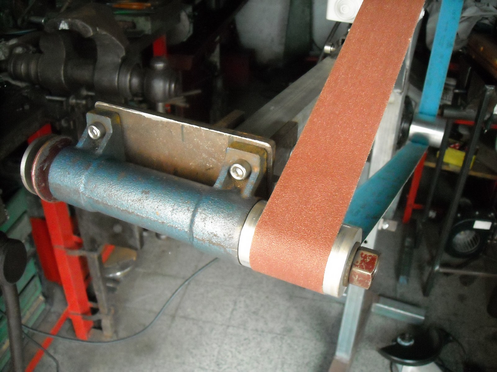

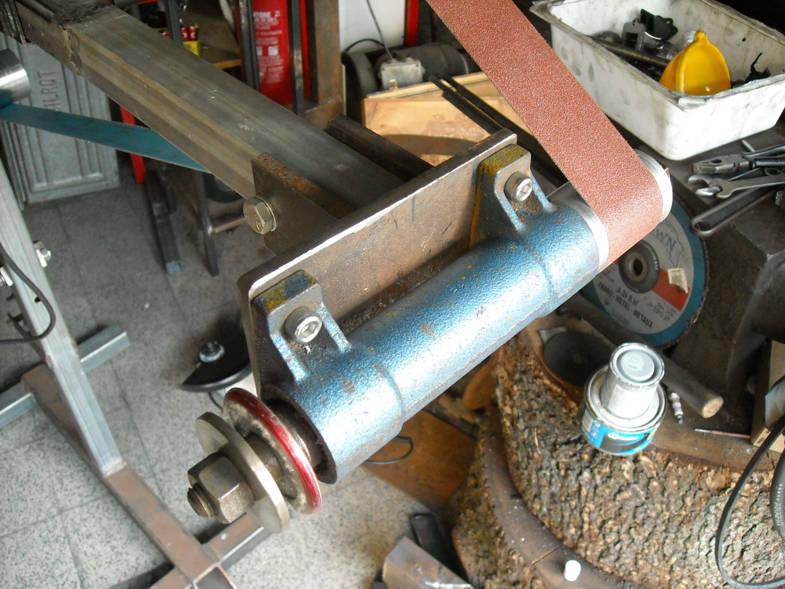

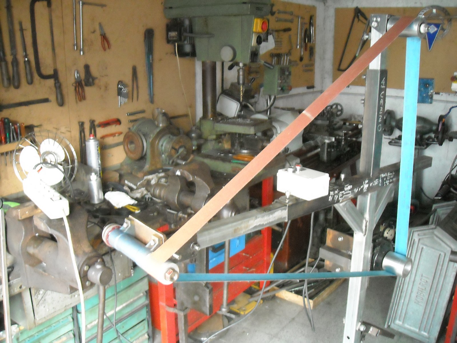

    Just finished the polishing attachment.
    The belt run strainght with no trouble, the shaft for cotton wheel is 15mm with 20mm bushing, left threaded.
    Now I have to buy wheels and pastes. Have you any advice?
    I only have White paste, I think I need one wheel for each color of paste, right?
    I want to polish aluminum and brass.
    I think I need : light blue, pink and brown. There is also a green for stainless, but I don't know if it can be good as last passage before brown
