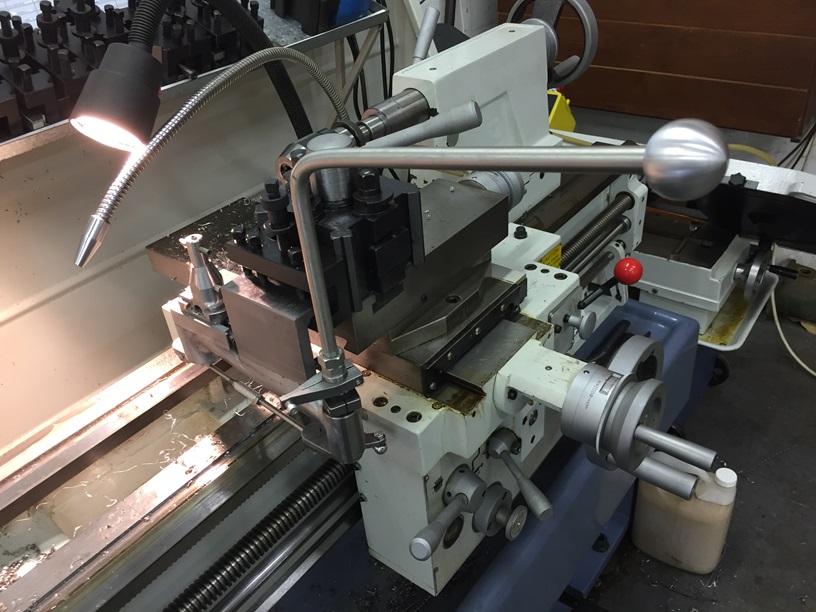

Really like the connecting rod and remote handle to operate the attachment. Great idea.
I hope you don't mind, but I think I might try to incorporate something similar to your design to the one I built. This would be a great improvement to my tool.

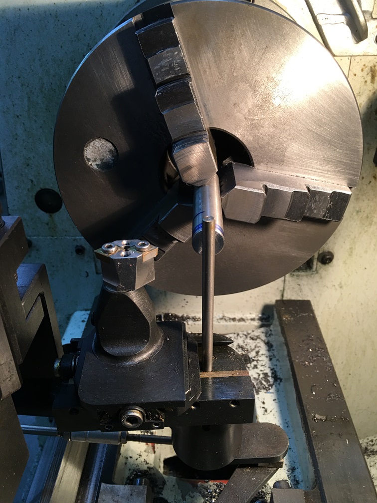

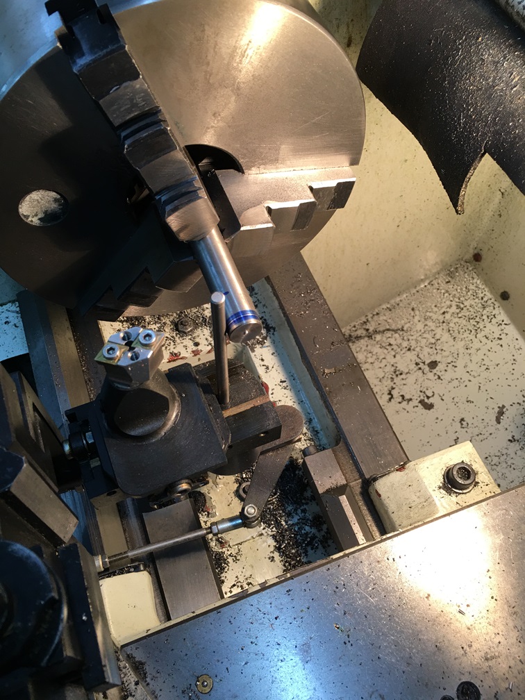

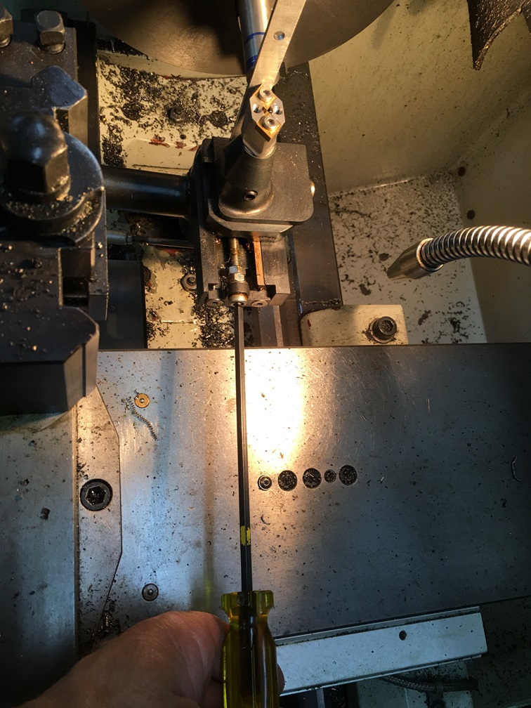

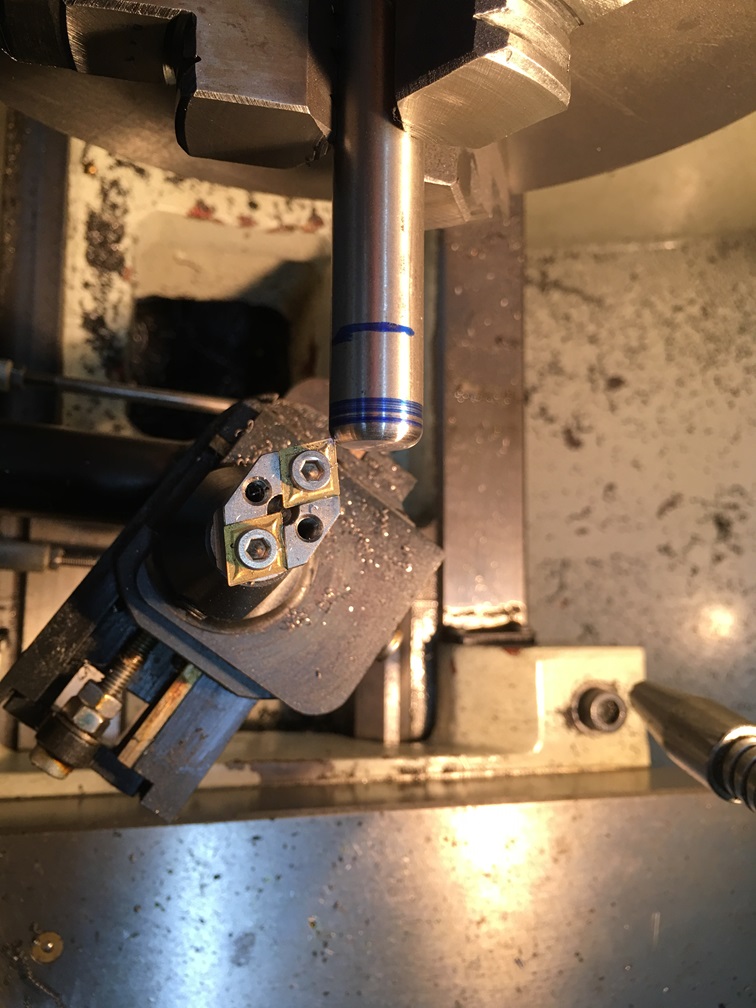

You're welcome to use useful bits of my design. I see we have similar ideas.
I also incorporated a removable 6mm ground pin that I insert in a reamed hole at center of rotation, to align the center of rotation with center of work piece. Then Zero y-axis on DRO.
Then I turn the adjusting radius screw until cutter just touches work piece OD, then turn in radius distance of work piece to align cutter tip over the center of rotation. Now both center of rotation and center of work piece are at zero.
Set cutter 90 degrees to work piece face and set x-axis to zero.
Now set the radius distance required, either in or out depending on concave or convex.
Then using lathe cross slide touch cutter tip to work piece OD and Zero y-axis on DRO, then turn 90 degrees to touch the face and set x-axis to zero.
You are now ready to cut the radius. I turn the cross slide outwards and doing multiple cuts feed in y-axis until zero. Job finished.
