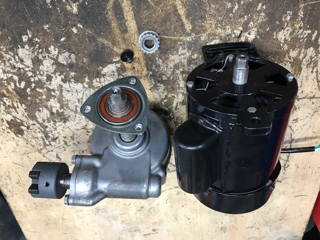

I decided to add a gear reduction to my wood cutting band saw so I could cut metal. First I modified a auger transmission from a Honda snowblower. 11:1 reduction.
Attachment 38736 Attachment 38737

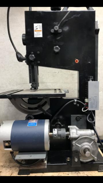

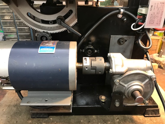

Then I added a treadmill motor and speed control.
Attachment 38738 Attachment 38739
Now I can control the blade speed for wood or steel with no loss of power...
